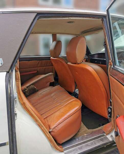

Have to admit I'm really pleased it's not brown with a black interior.  I mean they do look good in those colours, but it feels like virtually every one you see is brown/mustard or a very similar greeny grey to the P4 and with a black interior, and it's no secret that I like lighter or more colourful interiors.  Exactly like this.

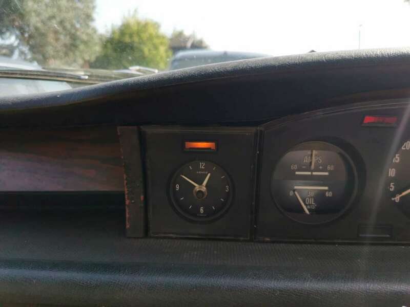

Have always been curious to see what this panel looks like at night.

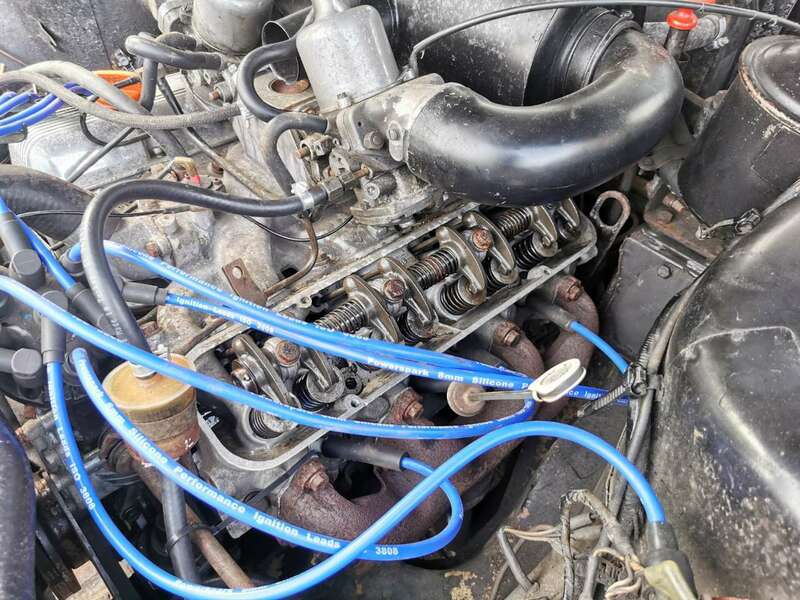

Okay...so issues, which we knew there would be!
Let's start with the obvious one, which is that it's not running on all eight.  Currently we have the rare beast that is the V7 Rover.  I had hoped that we just had a fouled up plug, but no.  Sadly we do appear to have a lame cylinder, we appear to have a major lack of compression on number five.  Haven't had a chance to do much real investigation yet, but we do appear to have the same movement on the valves as on the others on that bank, so don't *think* it's a cam issue.  Optimistic diagnosis?  Crud on a valve seat maybe?  Don't know.  Will need further investigation.
The oil was badly, badly contaminated with ancient fuel (unsurprising given the car's been off the road for a long while, especially given we've discovered a dead miss on one cylinder).  Seriously, it reeked like old paint stripper.  So before I did anything else I wanted to get that changed.
What came out was...well...was this.
No chunks nor any glitter I could detect, but yeeeaah...we may need to turn our attention towards the heads - especially with missing compression on one cylinder.  Though it doesn't *seem* to be pressurising the cooling system, and the level was spot on...hmm.  Further investigation needed.

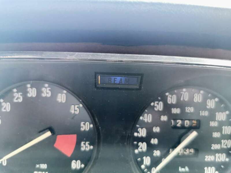

A reported fault was a lack of oil pressure light, pressure gauge or temperature gauge.
I noticed that we were also missing indicators.  This to me made me suspicious that we may be missing a power supply...time to investigate fuses.
Behind the passenger side glove box in case you wondered.
Turned out that the fuse in the "Ignition control" circuit was blown.  Markings in the fusebox call for a 25A fuse, a 20A one was fitted.  With that refitted still no joy...until I noticed that the pressure gauge was creeping towards full scale.  Sure enough, the leads to the pressure light and sender's were switched.  Correction of that resulted in a working light.
...And gauge.
Noticed this had also revived the choke light when I pulled the control out.
Odd that they didn't deem that important enough for a legend.  Just a plain amber light.
Brake light does work on the level sensor, but the handbrake switch appears to be stuck.
So we do now have a full compliment of warning lights.

Well aside from the obligatory dash at night photo once it got dark anyway.
Had never seen this panel at night before, turns out it's edge lit through a light pipe effect from the base.

Awesome to see the V8 beast has arrived :) I am sorry to hear about Cylinder 5 being AWOL, but the rest of it, the exterior/bodywork does look really sharp and clean :)
although those bright blue HT leads are making my teeth itch, they look so incongruous compared to the lovely tones of the rest of the car!

7 hours ago, Zelandeth said:
Answers on a postcard as to what these do?
Different switchgear to mine (probably production year differences) but the rocker switch is likely to be the heated rear window and the toggle switch I think is aftermarket - possibly front fog lights (do I see a wire hanging down from the front wing?) or electric fan override if you have one fitted.

Yes, the blue HT leads will be getting replaced with something rather less in-your-face in due course.  They will be getting held on to though as they seem decent quality - just way too bright for a car like this.
It's a shame we're missing a cylinder, but it is what it is.  Just need to cross our fingers it's just a top end issue.  Either way, given what I paid for the car I still feel I've done well.
Good thought.  Just realised now you've mentioned it that I haven't seen a labelled switch for the rear window heater so that's a good shout.  Albeit slightly surprising they didn't just use one from the BMC parts bin.  Assuming the heated rear screen wasn't added after the fact by a previous owner anyway.
Haven't been aware of seeing any remains of wiring floating around the front of the car (the dangly bit on the right is a very much too long radiator overflow pipe I think), but something like that would make sense.
I saw a photo of a late 2200 dashboard a while ago with the same style of switch in that location, and it's exactly where the HRW switch was on mine. The only difference is that mine had a pull-out switch.
Not certain but I think they might have all had HRWs.
Maybe the original HRW failed and replaced with a generic Lucas toggle switch from their local parts shop. Given the HRW passes a fair amount of current, I imagine they don't have the longest life if used frequently.
That's a nice assortment of scotch locks and terminal block 😬
Presumably they're for wiring in the radio? Or do they go to the mystery switches?
That panel from a 1971 P6 that was on car & classic.
Given the wiring is there, it makes sense that one of them is the HRW at least.
That's what I'm saying, it's the HRW, and late cars had a different switch.
Sorry I see what you mean now. I misremembered your first post and my brain mixed up rocker and toggle.
This is a 1976 car and you can see the square that originally had a rocker switch but someone badly fitted a pull switch.
Presumably either a cost cutting exercise by BL (someone went HOW MUCH for a heated rear window switch) or the original was hard to get as the factory was regularly on strike...

The rear seats have been given their first couple of treatments with the leather feed and are already starting to look a fair bit better.
Regarding our missing cylinder, I tried dumping some oil down the bore to see if that made any difference.  It really doesn't, which kind of suggests to me that it's a top end issue.  Most likely a valve not closing fully or a burned seat.  Unless something absolutely catastrophic has happened to the cylinder walls anyway, I'd have expected to notice at least some difference when the engine was turning over wet rather than dry.  I haven't actually stuck a compression tester on there yet, but based on how the engine sounds I'm expecting to see a big fat zero.  Thinking this might be the thing which finally gets me to actually buy a borescope so I can take a proper look at the cylinder.
There definitely is quite a bit of damp in this engine, though it's really hard to say whether that's down to an active leak somewhere or whether it's external contamination.  It's clearly sat that way for a fair while too.
Before I actually go pulling the engine apart to any extent I need to confirm exactly what engine it is, as there is a (so far) undocumented rumour that apparently it may have been replaced at some point in the distant past.  Given the car has 101K on the clock, definitely not impossible.  The number stamped down by the dipstick is very hard, almost impossible to read - though what snippets of it that I can make out seem to point at it being an SD1 Vitesse.  It's the only variation I can see in any of the tables with the same 9.75:1 CR and the couple of digits I can make out matching up in the right places.

Did ascertain one thing this afternoon.  While this only has a single pipe exhaust system on it, it still sounds rather rowdy when some revs are involved it seems.  Which I'm okay with so long as it doesn't drone at speed.  I tend to prefer quieter for the most part these days...but I'll make a bit of an exception for a V8 provided it's not too antisocial.  I'd permit a straight pipe on something like a Land Rover, but a P6 needs to be at least somewhat refined!
  • Zelandeth changed the title to Zel's Motoring Adventures...Renault, Rover, VW, AC Model 70 & A Sinclair C5 - 06/09 - Rover P6 Initial Investigation Underway...
Don't forget to check all the other basics like tappets. Would be awful to pull it apart to then find that it was simply a tappet too tight. I'd be tempted to take the rocker arm off and give them all a tap to make sure they're moving freely. Could also be a sticky valve if it's sat a long time and that cylinder happened to be the one left open.
Finger on the spark plug hole when turning over will also give a quick indication of amount of compression on a cylinder without digging out the tester.
