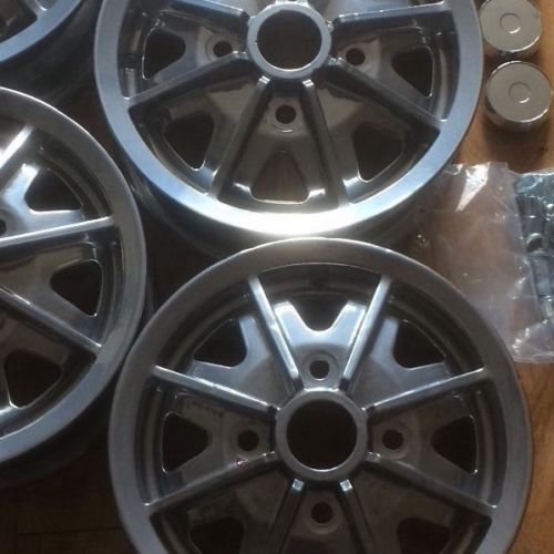

@holbeck:  I have, and they're lovely, but I have my heart set on slotmags if I go the alloys route and probably scruffy slotmags at that rather than super shiny lovely ones.
