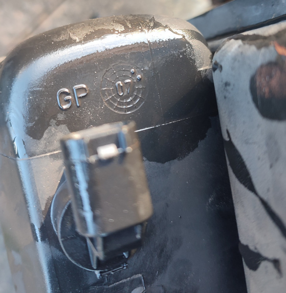

And so the nice but cold weather today was used to get a few jobs out of the way and make space on the drive. The 540i now has new OEM radiator hoses, hopefully these will last for the rest of the life of the car considering BMW does really charge you for the priviledge now. Removal was easy, plenty of room even with the fan cowl in place:
Quick progress was made, the quick-disconnect made it all fairly easy. Here's what 98 quid worth of coolant hoses look like nowadays:
The temp sensor was transferred over from the old hose and silicon spray applied to the seals before slipping them back on. Then shit hit the fan... The radiator had to come out because I couldn't for the life of me get the lower end of one of the hoses back on. With the radiator out (fortunately without having to remove the viscous clutch on this one) and the force of a thousand suns it did slip on eventually. At least I was able to check whether the radiator and reservoir had been replaced already as those would be ready to blow at any moment at this age. They were fortunately, radiator in 2016, reservoir in 07. Might almost be time to consider it again for the latter, its the achilles heel of these cars.
image.png.381d71e9210e13dc24a472fc7bc322fc.pngimage.thumb.png.df519ffdc07c5927ac314497247dc5b0.png

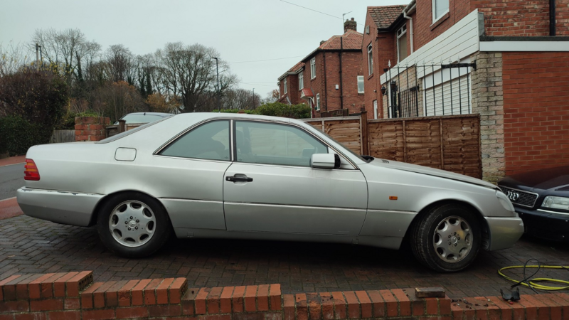

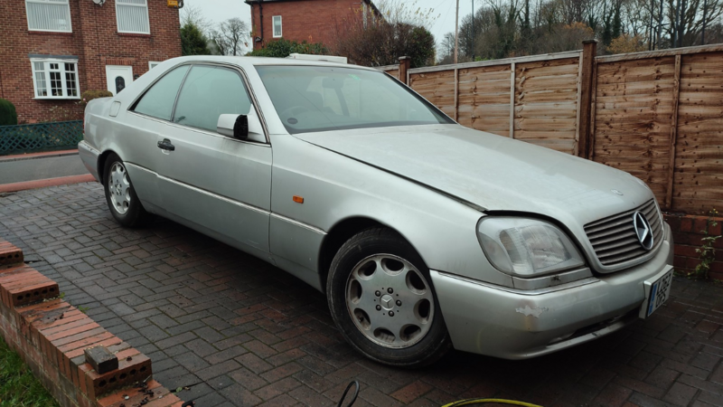

Well, the day has come, the new car arrived today and boy will it be a project... Anybody who has guessed Mercedes, you were absolutely right. But why W201s or 124s when you can have this!
Yes, it's another 90s big body Benz, and once again one with the best engine you could get in them, the 5.0L V8. This time it's an S500 Coupe from 1993 that at some point made its way from Japan! And despite having only little miles on its odo (indicated 37k but the cluster must have gotten changed, its an MPH one) its time here in the UK certainly hasnt been kind to it...
I found the car on FB marketplace where it's seller advertised it as a non-runner. He plans to move back to Portugal so some of his fleet has to go, this was one of them. Having confirmed before that this was indeed a Japanese market car I gave him a call to learn a bit more about it, its not like you see that many JDM Mercs around here. Unfortuntely it came over with next to no history, the original used car dealer believed that this was an ambassador's car however. Despite the exact mileage not known and the car being in quite a state I can still tell that this car hasn't seen that much action. W140 interiors are hard wearing but things look pretty promising with this one.
The seller was in the middle of fixing various issues with it so parts are just all over the place. It doesn't even have brakes right now as there aren't any caliper present in the back at all. They are behind the back seats lol. Sure was interesting manouvering this into my drive, downhill, around a tight 90 degree bend...

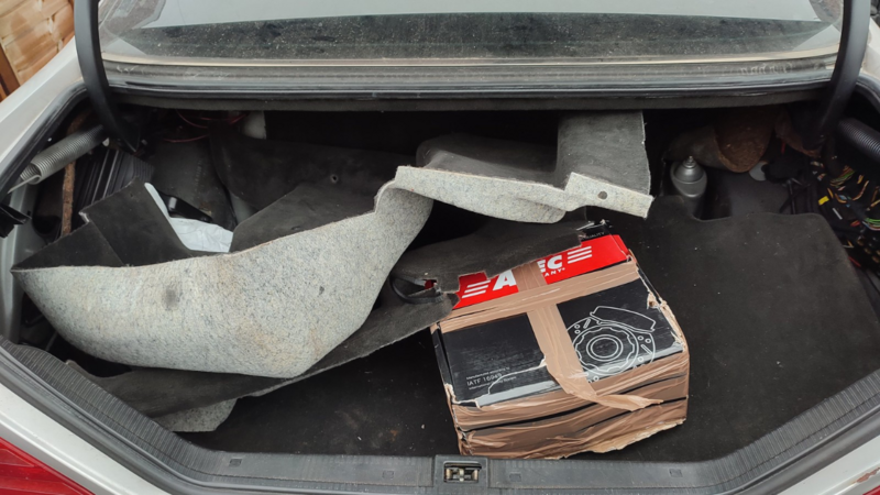

More stuff:
At least the car came with a decent amount of new parts which should help get it back on the road for somewhat reasonable money. Its the cosmetics that worry me a little more, you buy a low mileage car for it to look like one after all. And paint is expensive.

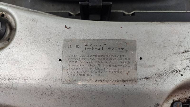

Its great to see all the little indicators of its life in Japan though. I just love stuff like this. The Shaken sticker doesn't make sense to me though, wouldn't this indicate the next one is required in August 2016? The car was imported long before that:

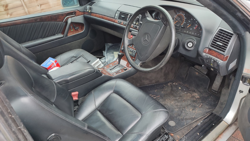

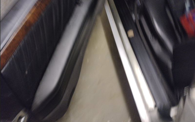

Being an S-Class coupe it naturally comes with all the gizmos, like the seat belt butler. Most of them still seem to work, too.

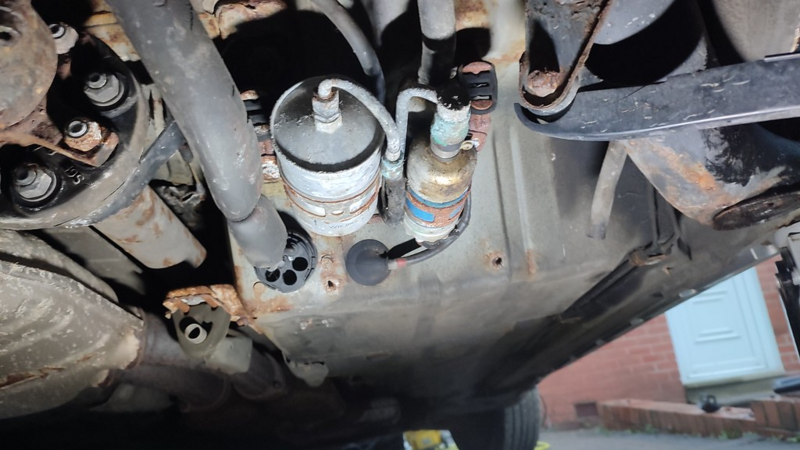

As mentioned, the car currently doesn't start. There doesn't seem to be any fuel pressure despite 12l of fresh fuel now in it, and naturally fuel pumps are usually whats giving up first after sitting for years. The W140 has two stacked on top of each other next to the gigantic filter:
I can hear at least one of them running, I wouldn't be surprised if the other one is dead. I measured the voltage across the power supply and earth connections on both pumps while cranking. One only seems to receive 0.05V, the other zero. I'm not sure if that makes any sense at all, it certainly wouldnt be enough to run either of them. Let me know if you have any theories.
