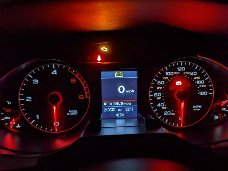

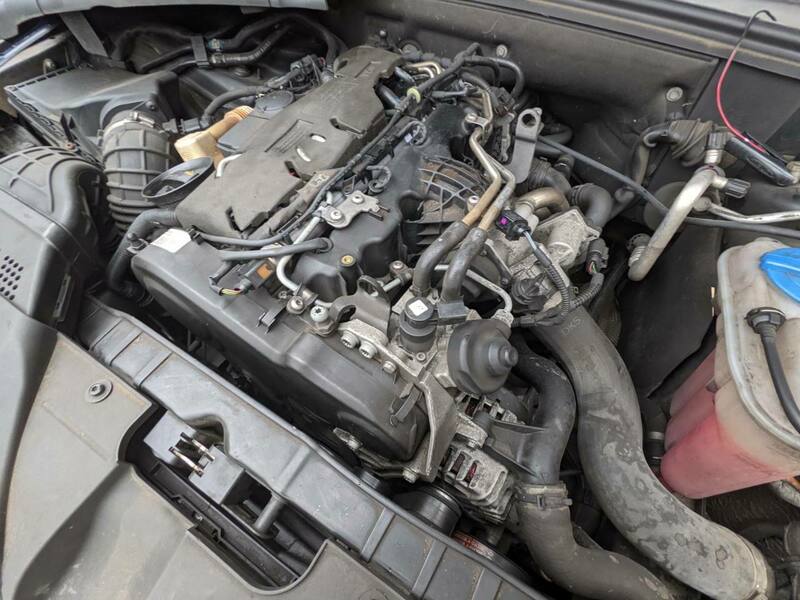

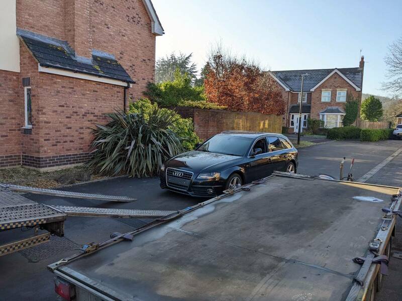

Just remembered I need to update this thread...
2100032 miles

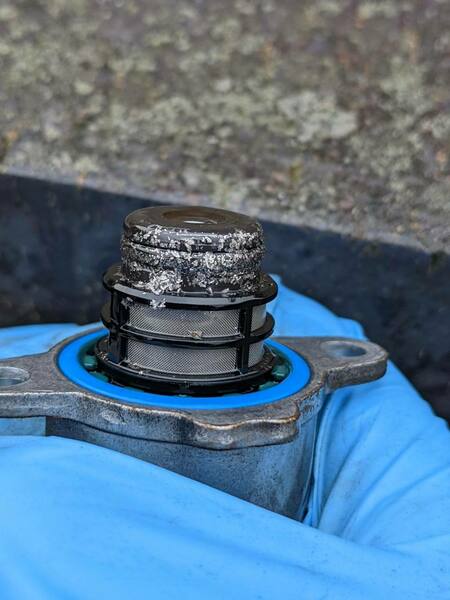

Mrs SiC was driving along the motorway a few days before Xmas. Glow plug light started flashing - on VAG this is an engine fault. But weirdly no bonging or warnings on the display.
She phoned me to ask what to do. As it was driving fine, I told her to carry on.
2 minutes later, I got another call to say she lost power on the slip road and it died without being able to restart.

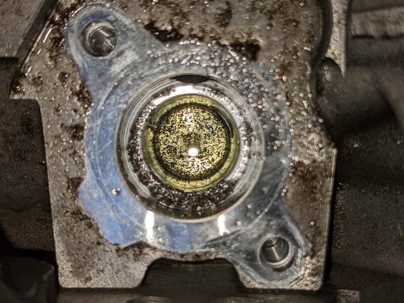

When it got home, I read the codes to find "Low fuel rail pressure". Not good.
Checking under the fuel pump metering valve...
Was this horror of metal flakes. These are mushed so finely that they will have circulated through the rail, into all the injectors and back into the tank. Clogging not only the rail, injectors but also sticking inside the fuel pumps as they contain magnets for the motor.
1533094641_2021-12-2311_04_53.thumb.jpg.0a453a7e95d1c2d81a990a7edfd38c2e.jpg1382587360_2021-12-2311_06_09.thumb.jpg.23a5258974d4251c26bd9373ffcea91f.jpg
Hence its around £3k in new parts or around £1k-1.5k in second hand parts to fix that. Apparently a common problem on 2008-2014 era Bosch CP4 pumps and affects many brands.

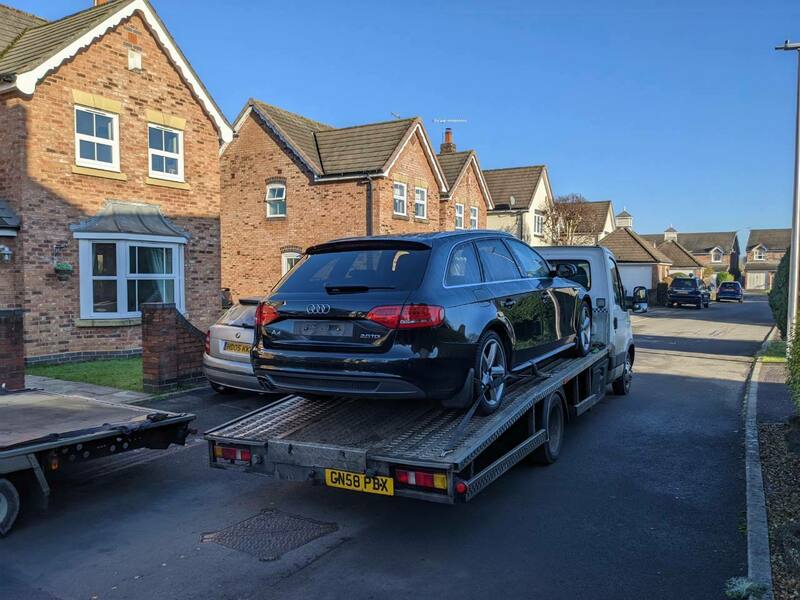

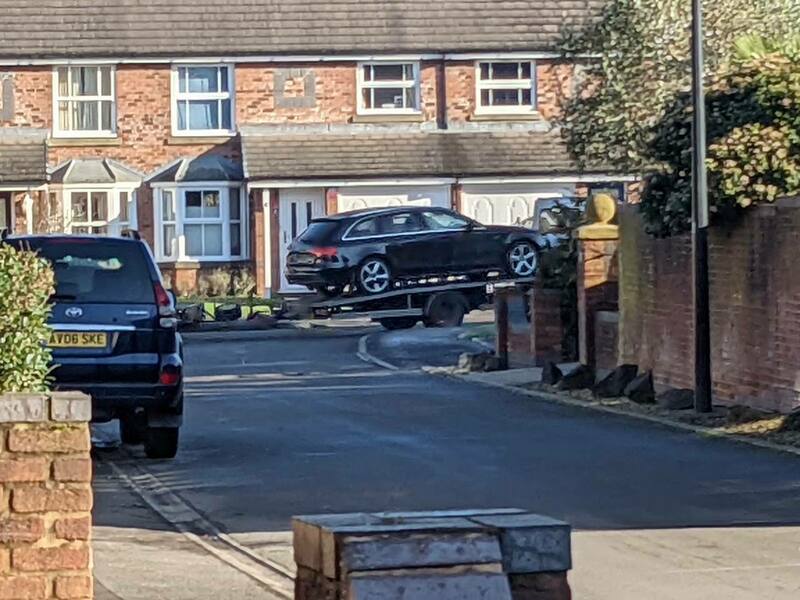

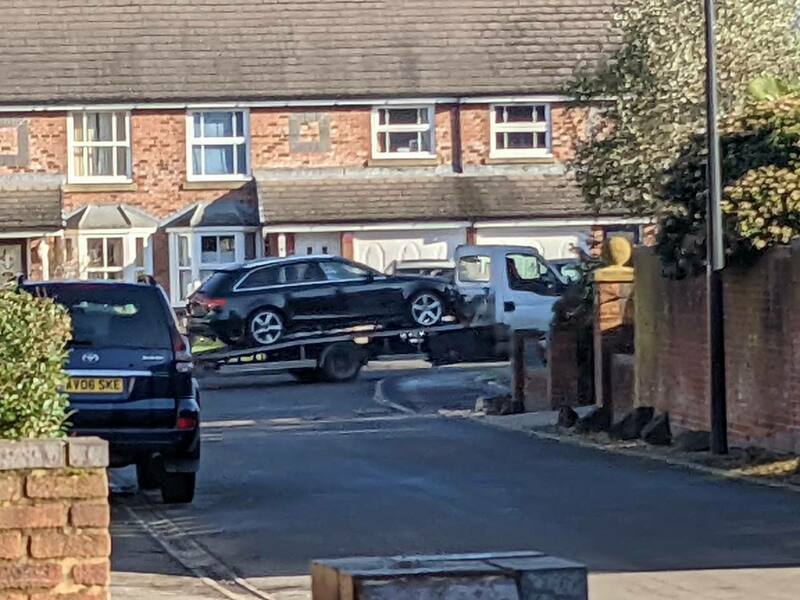

So time for me to hand in my membership card, as I'm out! Shame as everything else was working absolutely perfectly. Seems criminal but a car is no use with a engine that doesn't run.
Over 11 years of ownership between my parents and myself.
That's the last I saw of it.
2100032 miles

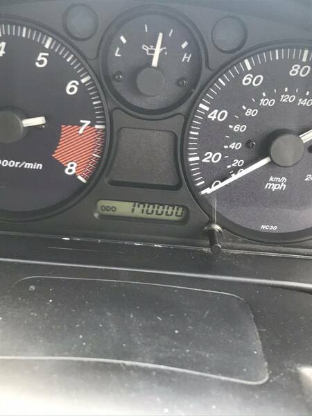

On 8/30/2020 at 4:51 PM, Mr Laurence said:
My MX5 as of today: 162,457 miles is nothing compared to a lot of the cars on this thread, but by far the highest mileage car I’ve ever owned
07-F2-D07-F-3226-4-BEB-B55-E-963-B90-A22
An update from a few months ago. I didn’t seem to do all that many miles over lockdown, but it’s starting to creep up now.  Still running just as well as it did when I bought it though and I can’t see any reason why it won’t make it to 200k

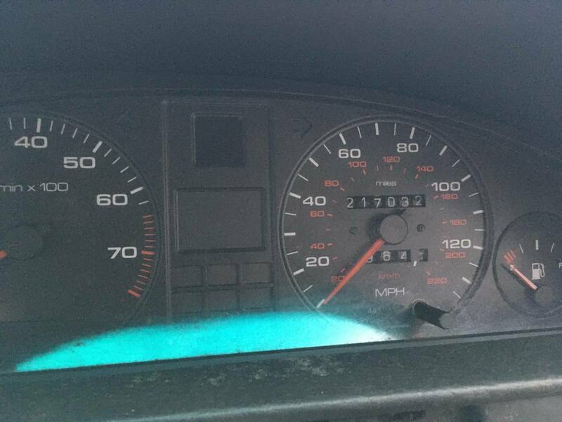

Audi 100 on 217,000:
