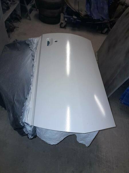

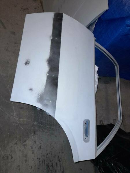

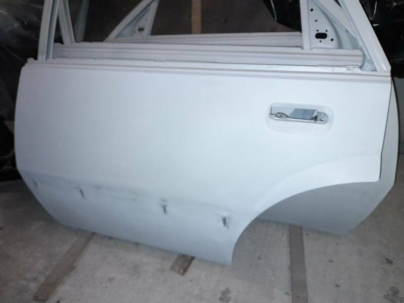

Both rear doors got a bit more attention today, the nearside one with the damage needed a couple more light skims to get it properly straight.
Once filled, primed, guide coated and blocked again, it's ready for the paint bloke.
The offside one got a second coat of primer + guide coat, and was blocked again.
This one is now also ready for the paint bloke.
Still loads to do before it can all be palmed off for blueness!

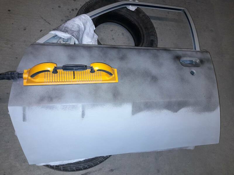

More stuff happened this weekend (boring stuff) Both front doors recieved what should hopefully be the last coat of epoxy primer.
Should get these blocked during the week after work.

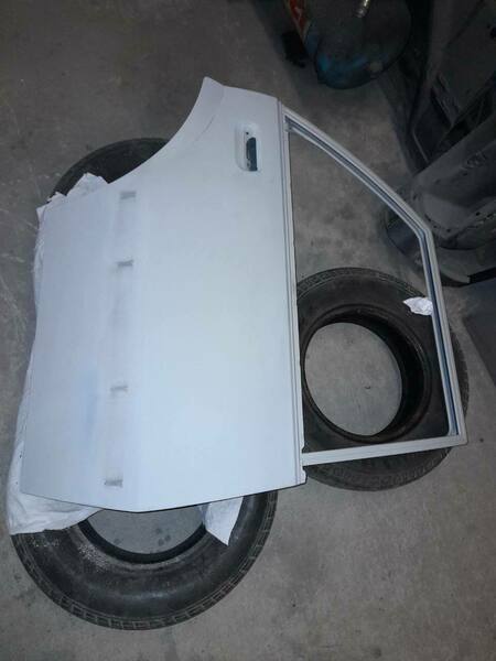

Front doors now finished up ready to paint.
Passenger side part way through blocking -
And ready for paint -
And drivers side after almost completing tha top half -

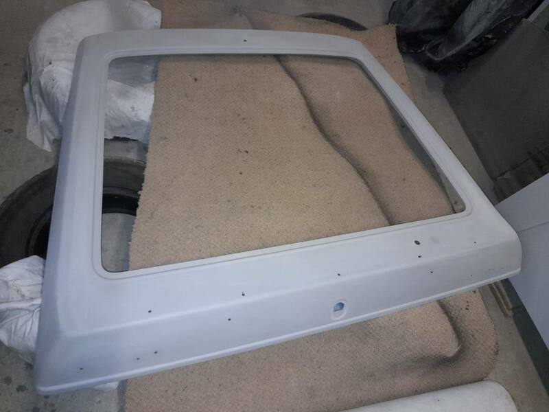

The tailgate got a good rub up followed by its second coat of epoxy primer. Only two little dents to fill on this, one next to the washer jet, and one next to the wiper spindle hole.
It then got a third coat, so should be getting its final blocking tomorrow.
Tailgate now blocked again ready for painting.

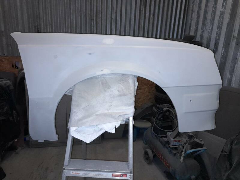

Made a start on the offside front wing, giving it a rub up and the first fill.
It's easily the worst panel to be tackled so far - I've identified 7 separate areas that require fettling, so it'll probably take a while! The other wing is close to perfect, so should be a breeze after this. :)
It was given its second coat of epoxy primer before I scuttled off home.
More work has taken place on the slightly battered drivers side wing. A few light skims were applied before more blocking.
It was then hit with another coat of epoxy primer.
Which was then blocked again, this time using a tin of Carmine red left over from my Astramax van for a guide coat. (Van was sold in 1999!)
Once it was blocked again, it then recieved a fourth coat of primer. (Yawn)
It looks pretty reasonable now, but still requires a little fettling in a couple of spots around the wheel arch. :)

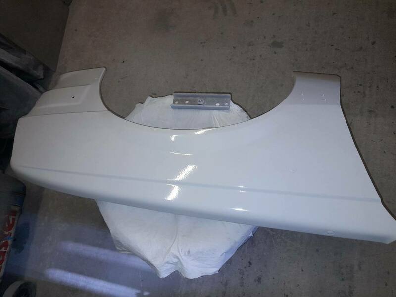

Drivers side wing now just a blocking away from being ready to paint.
The passenger side one is at the same stage.

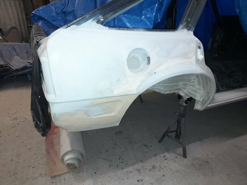

The drivers side one was a bit of a pig - if I'd known how bad it was when I started work on it, I'd have probably bought a new one! While the paint hardens, I got started on the drivers side rear quarter - seen here part way through blocking back the first fill.
I suspect that these rear quarters are gonna be another big consumer of time - particularly this side - due to the previous bodge repairs involving the use of a hammer!  :)
Top half of rear quarter now something like,  bottom half got its first fill.

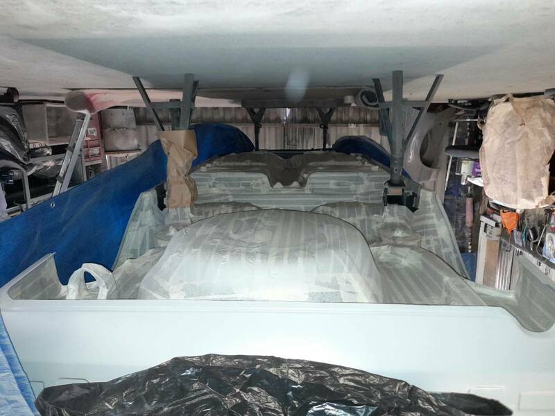

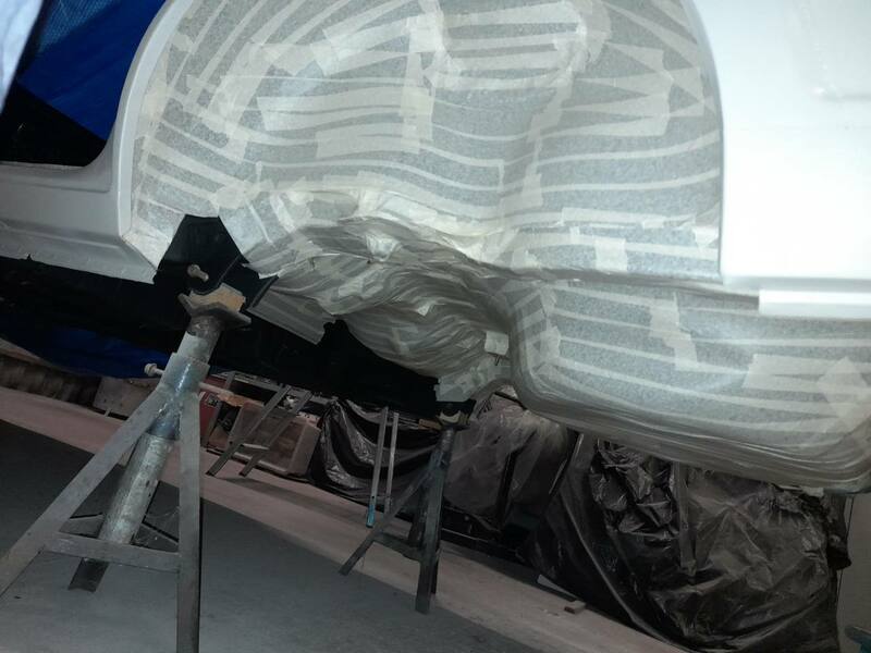

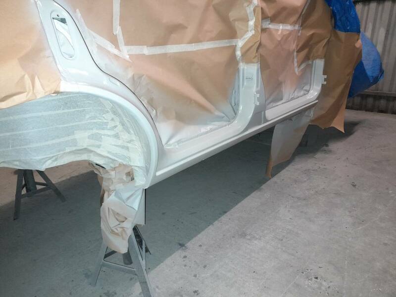

Made a start taping up the underside to keep it free from over spray too.
About a third of it done today - hopefully get the rest done tomorrow.  :)

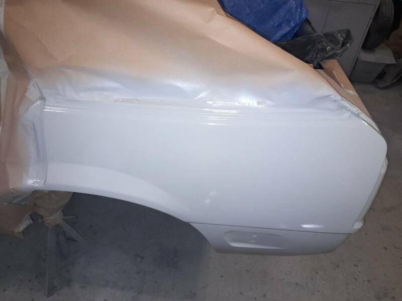

More stuff has been happening - the underside has been taped up as far as the front footwells now, and some epoxy primer has been splashed around - offside rear quarter got a bit more rubbing before the primer went on.
The rear end got a bit of filler, a good rub up, and it too got a coat of primer.
These panels are by no means ready to paint yet, but are a lot closer to that than they were before - particularly so the rear quarter.    :)

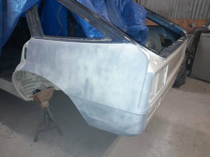

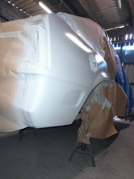

Managed to get a good few hours on this yesterday. The nearside rear quarter got skimmed and rubbed several times until it was good enough to be hit with some epoxy primer.
Really pleased how well this side has come out so far, just a small amount of fettling required before its ready to paint.
I've taped up as much of the underside as I can for now - I need to cobble together some sort of dolly to make the shell mobile before I can finish that off.

More stuff has been occurring - the offside rear quarter got a bit of fettling, some blocking, and another coat of epoxy primer.
Its pretty reasonable now, but theres still a couple of areas needing a little finessing before I can call it ready.
The front wings have both been blocked again, they can now go in the "paint bloke" pile.

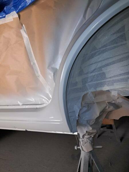

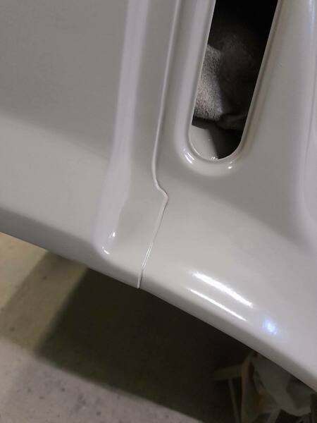

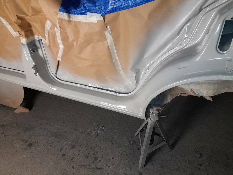

Nearside sill + wheel arch areas got some attention over the weekend. It's been filled, rubbed and primed twice. The pattern part sills used are not very good pressings - this became apparent once fettling began!
One more fill/rub/prime cycle should see it ready to paint, but I'm gonna get the offside to the same stage first.

Time was short today for one reason or another, but got a bit of filler, a bit of a rub, and some epoxy primer on the offside sill.
Should hopefully repeat the exercise over the course of the week.  :)

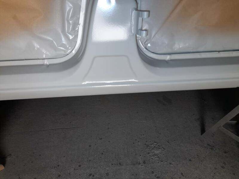

The offside sill and door shut areas have recieved some more attention.
Much filling, blocking and rubbing was needed to fettle the poor quality pressing of the replacement sill, but it's very close to where I want it to be now.
The whole offside was then guide coated and blocked/rubbed in preparation for its last layer of epoxy primer.
Afore mentioned layer was then applied.
This side just needs a final block/rub up and it's ready for the paint bloke. :)

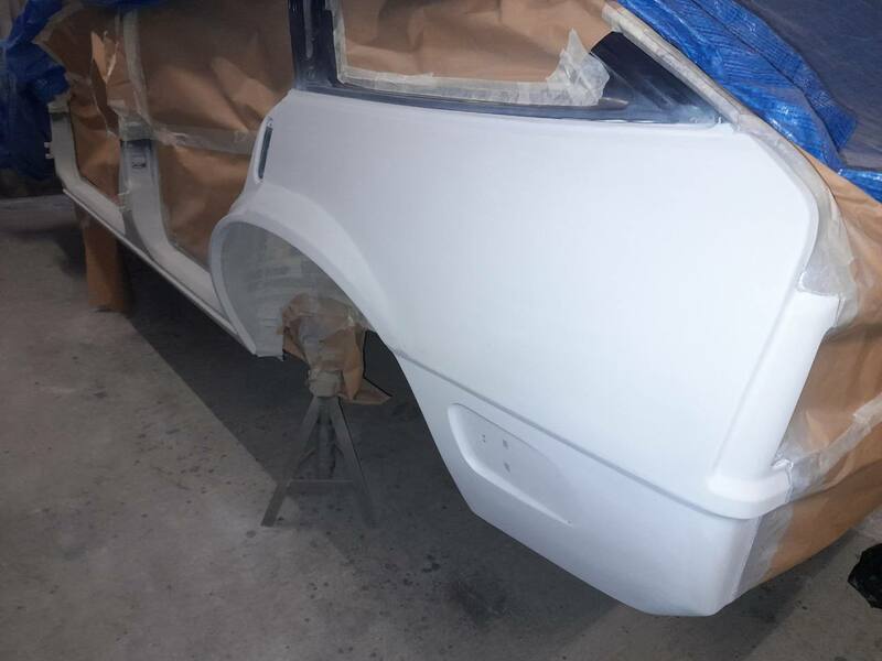

Got a fair few hours in on this over the weekend - the whole nearside was blocked and sanded in preparation for its last coat of epoxy primer.
Primer then applied.
Got most of the offside blocked/sanded ready for the paint bloke too, seen here part way through.
Once the rest of this side is sanded, and then the nearside has been done too, theres just the rear panel to finish before I can tackle the engine bay and front panels.
I hope to have the dolly fabricated before working on the front of the shell - should hopefully all be on it's way to the paint bloke in the next few weeks. :)

(Masking the underside - Could you not have taped brown paper to the inside of the arch and let it hang down?)
