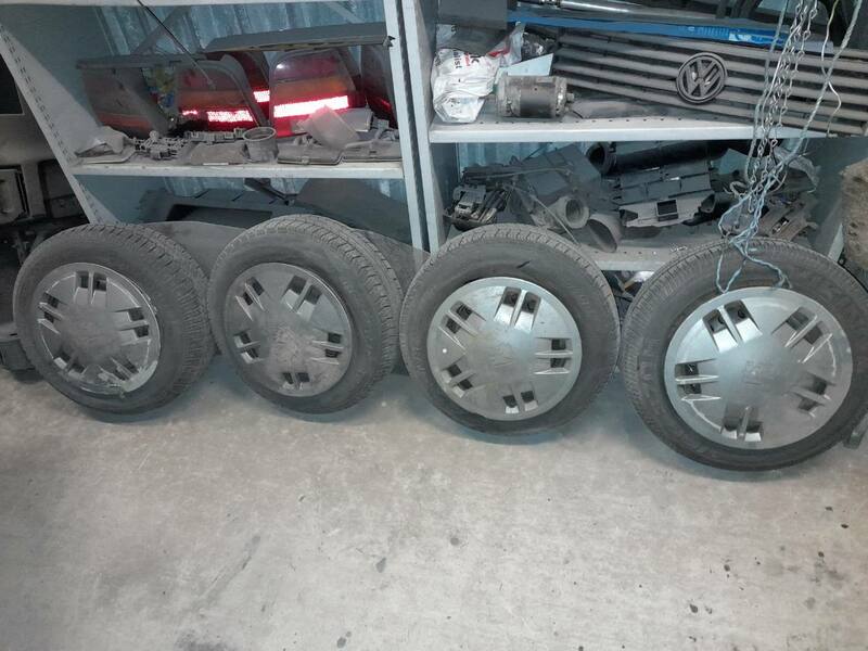

In other news, I was given these wheel trims the other day.
They're 14" though - probably off a Carlton. If anyone needs a set, they are available FOC. :)
cavalier sri trims?
i had 3 on my old sri, never found a 4th, so got alloys
8 minutes ago, stuboy said:
cavalier sri trims?
My dad had a mk2 Cavalier GL with those trims. 1985 B-reg. It was the update with the grille like the top photo above. The logos were not highlighted in red like the SRi’s
A friend of my Dad's had a D reg MK2 Cav 1.8 GLSi hatch with these wheel trims fitted too.
One day they went to a job and found one had fell off.
But later on that day my Dad borrowed the Cav to go to a nearby cafe. On the way he was flagged down by a utilities worker.
He'd been working down a access hole they had dug, when the missing wheel trim had landed in the hole next to him!
Bonus was the wheel trim was undamaged.
Last bit of reasonable air temperature for the foreseeable today, so took the opportunity to prime the underside of the bonnet.
Here ends the "bare metal and epoxy primer" chapter. The "filler, rubbing and dust" chapter will begin when the weather warms up at some point.  :(
As @4wheeledstoolsuggests these trims are from a Carlton GL circa 84/85.
The only Mk2 Cavalier to have 14” wheels were SRis and the Minilite lookalikes on very late LX run out models. Plus randoms like Commanders and Calibres
GLs from late 83 to 85 had a very similar design in 13””.
GLSes always had alloys , again in 13”.
Thats not to say the memories on this page are inaccurate, just that the wheels and trims involved weren’t standard fitments.
