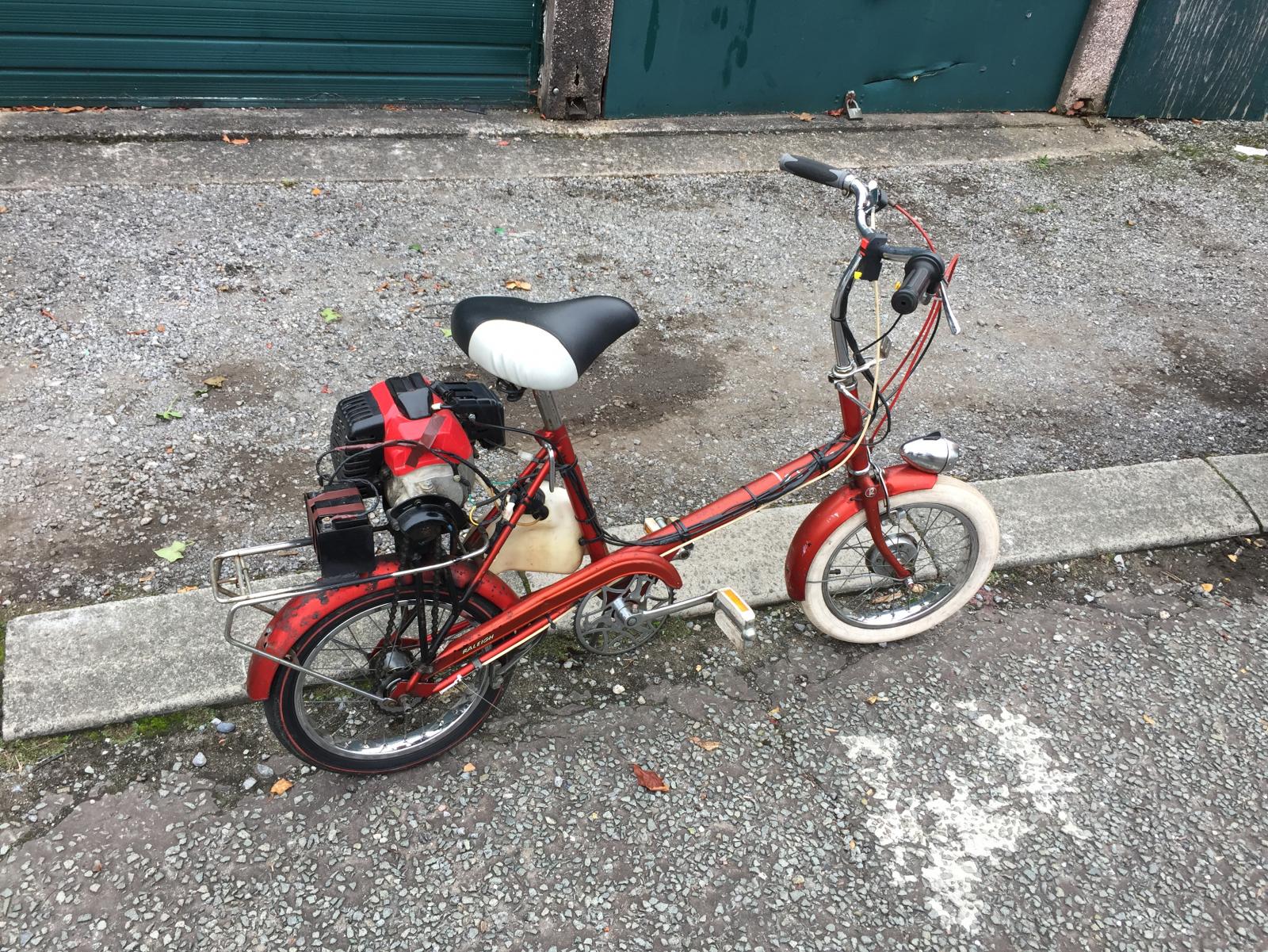

Phase one was getting rid of the C3 before I'd even really owned it. Phase two (which is this one) was to make it back home for my motorbike to be delivered. I was ten minutes late, but it was worth it, you'll hopefully agree. I've only had one small blast on it so far. It was ace.

That is MEGA, is that just a chainsaw with no blade lashed to the back of it?
Incredible. Is that engine even attached? The gearing looks like it would be slipping the clutch all the way up to about 90mph.
Very good. A large shopping basket/pannier over the engine for stealth and folks would be none the wiser. Until fired up of course.

Looks like the DETHMOTA still turns a 3 speed sturmey archer hub, is that still functional?
If so, what's the top speed, 60?

He said the gears work but to keep it in first to make sure it'd pull away. As he pointed out (and I'd forgotten) you have to back pedal when changing gears with the SA set up. Something that's not possible any more since the pedals have been welded to make foot rests.
It's not super quick, quite slow to take off then starts going but I've been nowhere top speed as it'd be a braver man than I'll ever be who had to use those brakes in an emergency.
Don't you just need to not apply pressure rather than pedal backwards? Ie you could just come off the throttle rather than getting all F1 style sequential on the lever.
It'd be so ace to sort the gearing so you could use the 3 speeds.
Yes, back peddling can't do anything because there is a freewheel so it is just a way of ensuring no torque loads inside the Sturmey Archer. (Any torque causes friction which stops the ratio changing.) If the freewheel is fitted, all that is needed is a blip on the kill switch as you snick up the box and a handfull of throttle perfectly timed as you go down. So it'l be fine for drag racing.

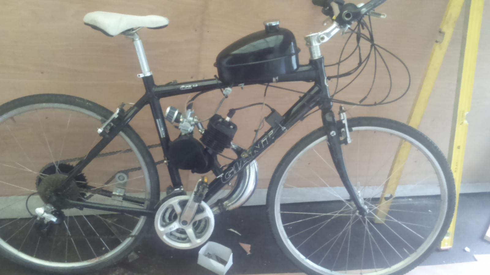

It must be silly season for oddball bicycle/engine contraptions. Look at this offering I have picked up.
It feels quite deadly to ride.

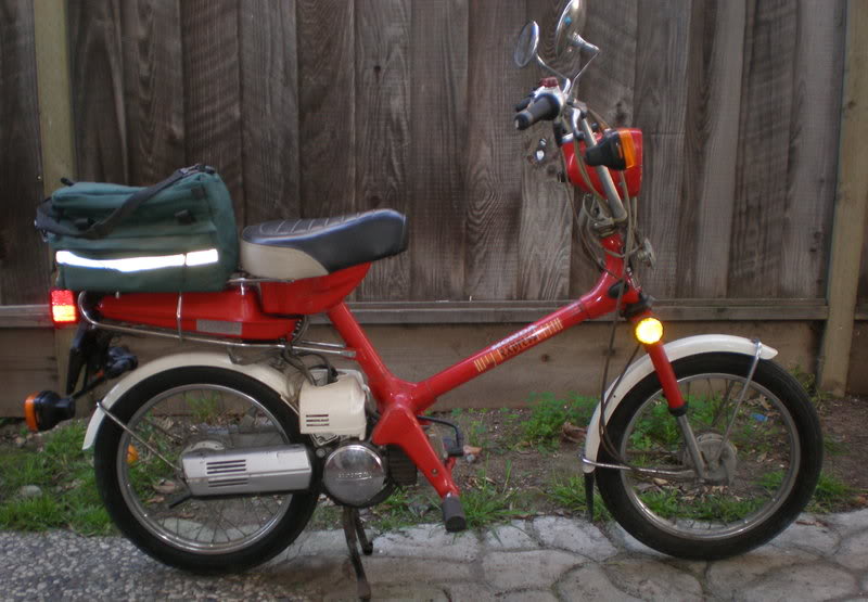

reminds me of a honda express,first bike i ever owned (age 11)
^along the same lines i had a yamaha QT50 that thing felt and looked hilarious, i did get away from a police car on it though when i got chased that has always amused me, i bet the officers were red faced
Putting aside for a moment the wonderful lunacy of the conversion to motorcycle status, the bike on which it's based is an old (60s / early 70's) Raleigh RSW 16. They were available in green, red or blue with white 'baloon' tyres and were Raleigh's answer to the Moulton bicycle which was a threat to them at that time. Dr Alex Moulton had fitted his bike with rubber suspension (like he did for his pal Alex Issigonis on the mini), which Raleigh couldn't do at the time so they decided (wrongly) that wee fat tyres were a cheap (to them) alternative. This is a Mk1 RSW 16 in red and is a very lovely thing in its own right.
