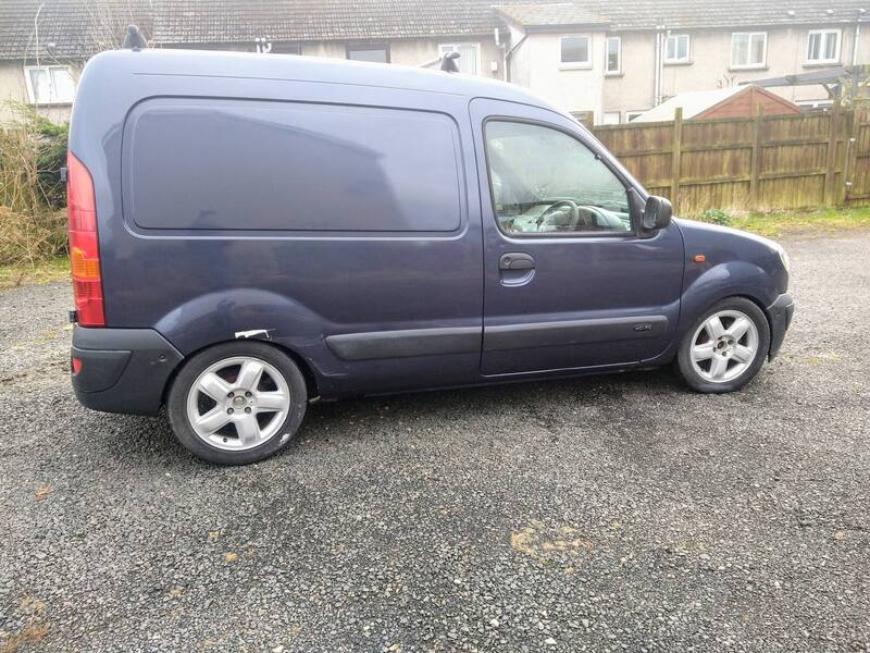

Ok, so this is now road legal so I got the chance to shake it down a bit. In true small fast Clio fashion its had a throttle body, throttle pedal and today coil pack replaced. No surprises there.
As mentioned above the tyres have no grip so they're for the bin. I was going to go down the steel wheels route but I like it on these alloys so they can stay. Thinking is Rainsports unless anyone can recommend a better alternative for the money?
It'll also need the inner tie rod changed asap and tracked, it's a bit wayward at the front end.
It's very loud just now but it'll do until I can be arsed to fit a back box.
The suspension on the front is a bit shit and crashy. New struts may happen and standard clio sport springs but the rear is torsion bar so raising it will be a pain.
Oh, did I mention it
Goes
Like
Fuck?
Have some pics after a wash and polish. Not bad for a van with 155k on the clock before it was converted!
IMG_20200301_122710541.thumb.jpg.fd9c2cceed76f0cea1c4aa8ff0113c57.jpgIMG_20200301_122715967.thumb.jpg.9663efb937f4140d4c1c09a546d2f942.jpg484821613_IMG_20200301_1227291802.thumb.jpg.dd27a3a3889d1344d8edc76f7e406229.jpgIMG_20200301_122721714.thumb.jpg.cfb583e2d26f11555cceec7f269213d6.jpg1438005765_IMG_20200301_1227023082.thumb.jpg.3e6e9a7790869cda640797741fac3a13.jpg1292645087_IMG_20200301_1226472112.thumb.jpg.6086789029f78e5ce9eeb523d3b525e1.jpg
