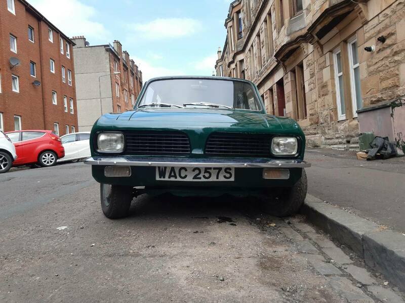

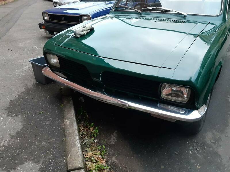

Firstly the lights. The headlights weren't working at all, indicators wouldn't flash, braking turned one of the rear lights off rather than illuminate the second fillament.
Cleaning connectors, clamping loose spade connectors tight with a spanner and assaulting various earthing points with sandpaper yielded the following:
Sidelights aren't working, but they're on the same connector as the sidelights so either there are no bulbs in them, they're both blown or they're supposed to earth locally and aren't. All are equally as possible. Headlights come on in the sidelight position, the car has always done this, no idea why.
O/S headlight seems to be missing high beam, or is always on high beam, not sure which. Only the N/S works operating the "flash" function on the stalk, but I'm not sure if the flash illuminates the dipped or high beam! I'm guessing high beam, which would suggest the O/S bulb has blown it's high beam filament.
At the rear everything is now working except the reverse lights. The bulbs look ok so may be the switch itself. The rear light turning off under braking was because it was wired backwards.
I looked at rigging up a sole numberplate light temporarily until the bumper gets refitted but the socket was in such poor condition the bulb snapped in half before it came out. I managed to tug it loose with pliers in the end. I couldn't be arsed taking the other light out the bumper to salvage another bulb.
The bonnet jamming shut seems to be that the release cable sheathing has popped out of it's retainer. Having looked at a few pictures of how it's supposed to look I should be able to sort that out.
I also took the redundant exhaust hanger (or it's remains) off the end of the tailpipe.

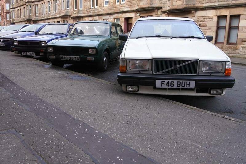

I don't think it's too obvious these cars all belong to one household...

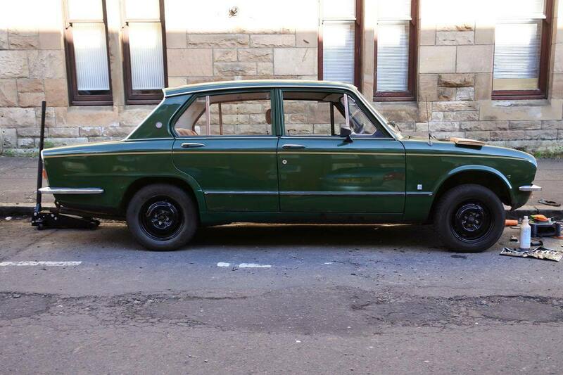

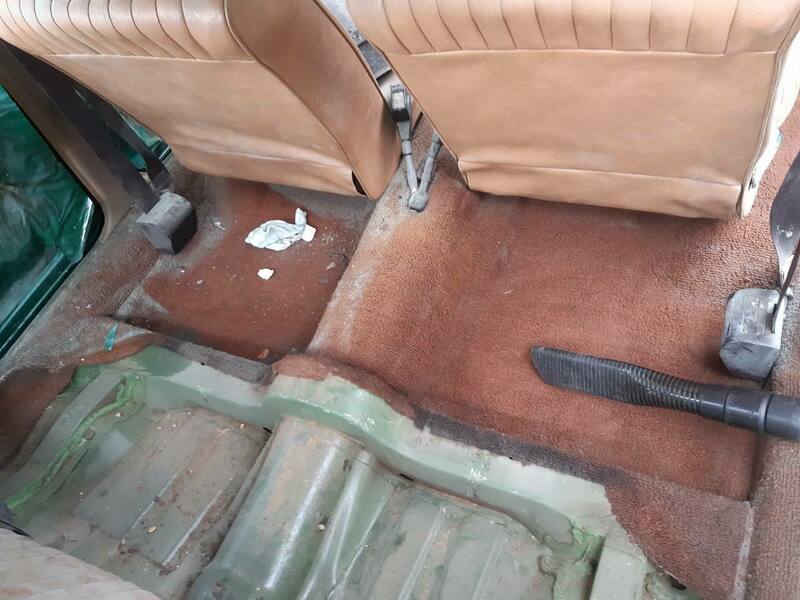

So.
The Dolly was back but really stripped to bare basics and stuffed full of unsorted parts, consumables and tools as well as 3 years of dirt and grinding/sanding dust.
I emptied it, sorted all the shit into boxes (Big car parts, small car parts, consumables, tools, nuts and bolts).
Then ran the thing down to the car vac at Morrisons and hoovered the interior until I broke the hoover...
280740278_691881082031129_2947795862899979790_n.thumb.jpg.060c8a07164566ca9ef51e81580425e9.jpg

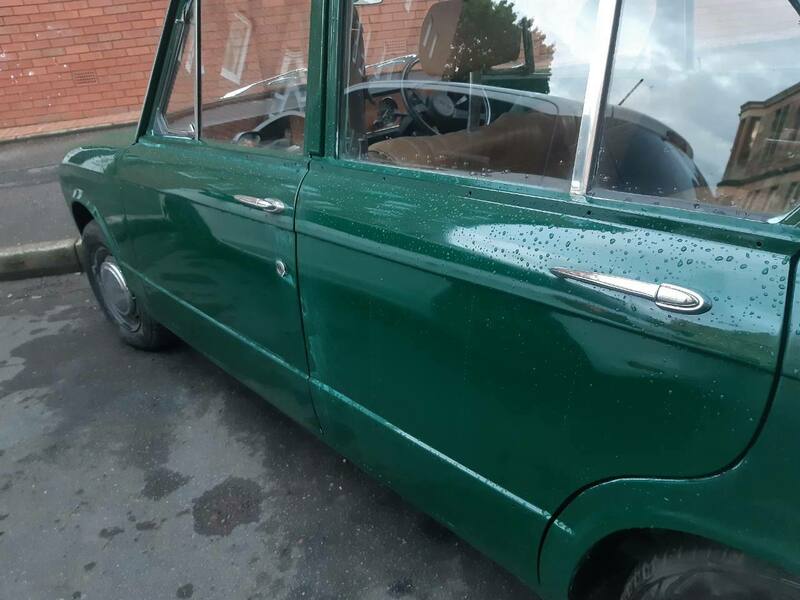

@jaypee also swung by to lend a hand and we managed to fit a door handle and hang the driver's door so it'd actually open/close without having to lift it half an inch.

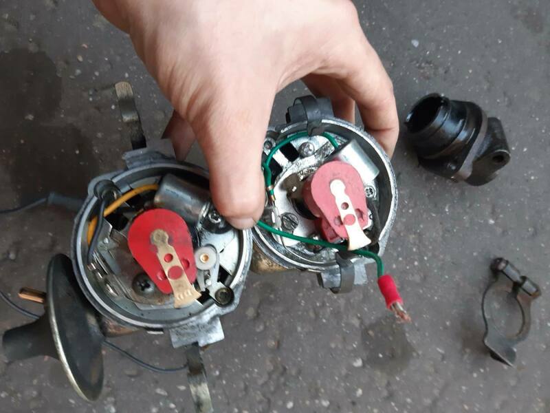

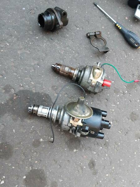

I also replaced the distributor which was fucked. @Jikovron spotted one on FB Marketplace from a 15,000 mile Reliant Robin and posted it up to me.
281168340_311326561146517_4018740469229630940_n.thumb.jpg.857e34a21c098b6fdbc86d16fc3b5587.jpg
The old dizzy can be identified by the missing vac advance unit.
281698976_524765512686614_6237906294476890737_n.thumb.jpg.e48a0928be1ff6410881934c8c357e3f.jpg
It also had various stripped fittings and the mechanism inside was held in place by a self tapping screw...
With the new one installed I set the timing by ear, although it could do with a bit of tweaking. The book figures are irrelevant with modern fuels.
I then set about cleaning and polishing the stainless...
280638471_479456840604340_7156828546616432060_n.thumb.jpg.cac899ab725a6e86bde9ef05e9e6c3b1.jpg
280152702_715574836537160_8450246920029742532_n.thumb.jpg.d94a447baf95df754567ea3df881ffe1.jpg
280374167_374288774652096_6763669271716319992_n.thumb.jpg.b1bff3d2137ff93ea71de33a3aeb3e7e.jpg
280390650_1162907221177703_8698702770418527091_n.thumb.jpg.023e28d86e913e63d544ee495fa16ed6.jpg
I also fitted new Tex stainless wiper arms and blades...

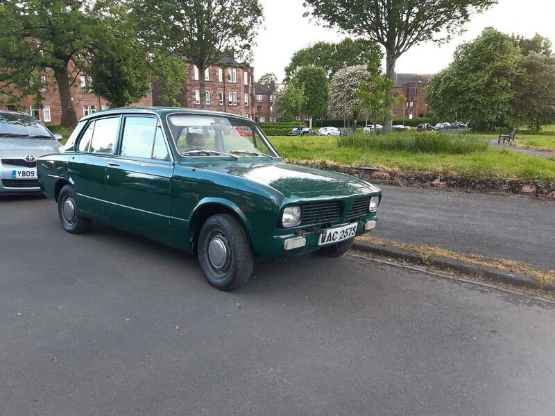

Anyway, that was all a week or so ago. Tonight I planned to take the car over to @320touring's unit. So headed out to the petrol station, inserted 20l of the finest unleaded and made it about a street and a half before it cut out.
281366973_1170617900165321_5176363815393093577_n.thumb.jpg.a04182c0fd83a85b7ed1e45676a7a344.jpg

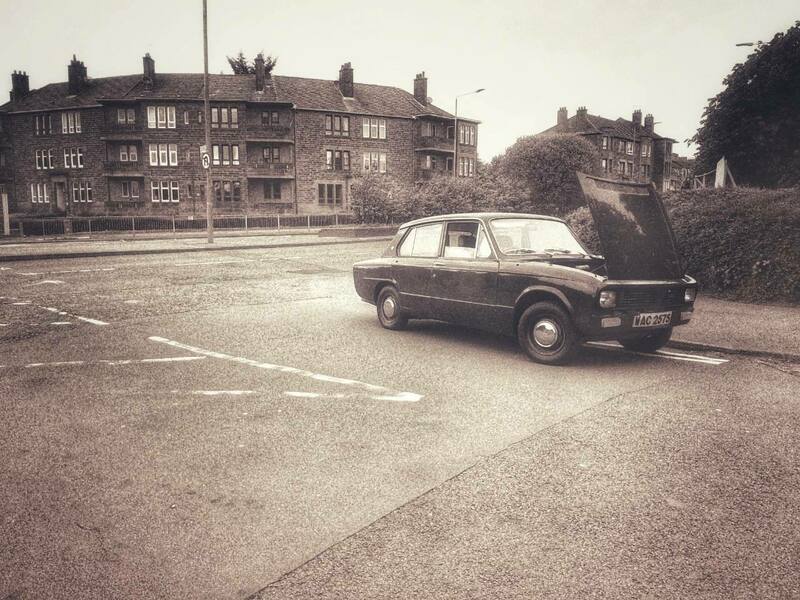

Managed to coast it onto a dead end street that was pretty quiet. Indeed I got to bask in the shadow of Scotland's tallest listed building...
281586598_578460190188837_5012581034939558303_n.thumb.jpg.6b4e53fcd23aa78df1dc592cc9865b41.jpg
A couple of guys passing by stopped for a chat/admire and helped push the car off the double yellows. Quickly realised that it was a fuelling issue preventing it from running.

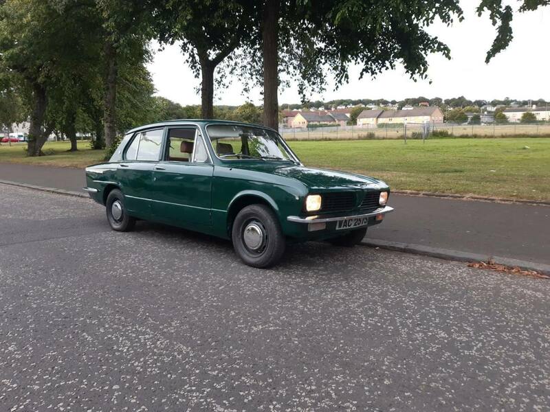

Assumed it was likely a blocked line, as we'd had that before and the tank isn't the easiest to clean out. Pulled the pipe off the pump and gave it a suck to be rewarded with a mouth full of petrol. Not that then.
After a bit of fucking about I deduced that the £12 unbranded electric fuel pump from eBay was making noises but not actually doing anything.
The mechanical pump was fitted but I couldn't remember if it was a working one as we'd ran three pumps at various points with varying degrees of success. Rigged it up and still got nothing. Highly confusing. Checked the pipe wasn't blocked again by drinking petrol again.
Then I messaged @GingerNuttz and he pointed out I had the pump plumbed in backwards.
Reversed the connections, tried again. Fuck all.
Checked the pipes for kinks, made sure there wasn't any obvious leakage points under the car, drank some more petrol. Gave all the clips another half turn, just in case.
Gave it another shot and success! Fuel. Car still wouldn't fire, rapidly traced to my having knocked a wire off the coil. With that it started first turn so I went the fuck home.

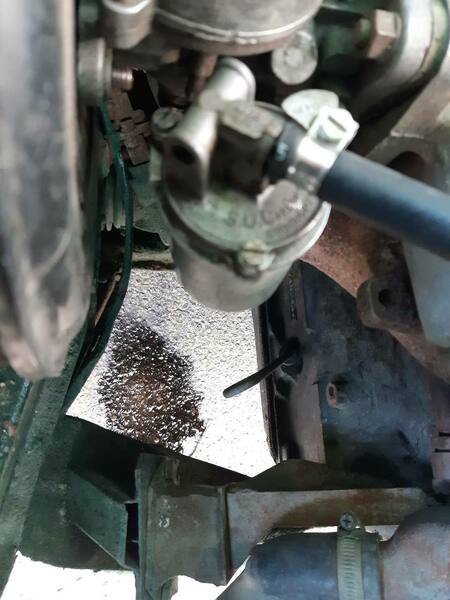

Pissing petrol out the top of the float bowl, handily positioned above the exhaust manifold for maximum explosion potential.
Took the top off the float bowl and started the car with the float held closed. No fuel coming through. Reassembled and it worked fine, so I drove home.
284419055_10229452126706789_277010712842463766_n.thumb.jpg.8b922975177f2fe8014bba8b8f8f77a7.jpg
Presumably the needle/seat at the top of the float bowl got something stuck in it causing it to just constantly fill. This is the second float bowl top that has done this now. Currently running the "new" carb and the top from the original carb as the new carb's just wouldn't seal at all for whatever reason.
It is also pissing oil out of everywhere it can. Probably as so many bits have been fitted several times since it was initially built the gaskets are probably fairly shagged.

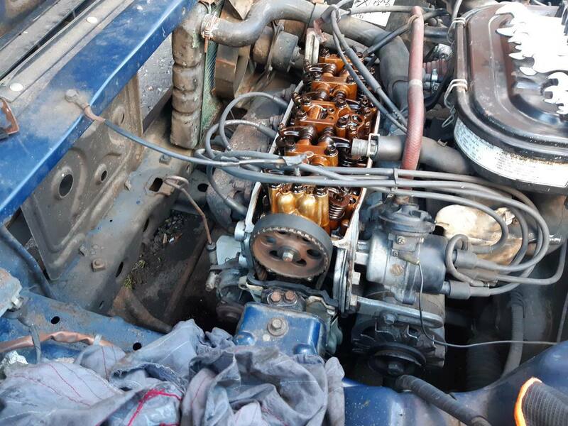

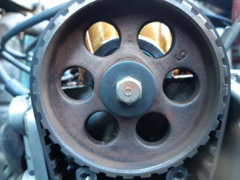

it seems the death rattle was just the timing cover rubbing against the water pump pulley due to a missing bolt.
The rhythmic pattern was due to it not running very smoothly. I had suspicions as to why that might be given the car's prior problems.
At TDC those two lines on the cam pulley should be parallel to the head. So it's a tooth out and the belt is slack.
Either the belt has stretched massively or the tensioner is gubbed. Getting at the tensioner requires removing a wheel and taking the crank pulley off with an ugga dugga through a hole in the inner wheel arch.
So I did the right thing and flung it back together and declared it to be fine for light use. Non-interferance engines, what a god send.

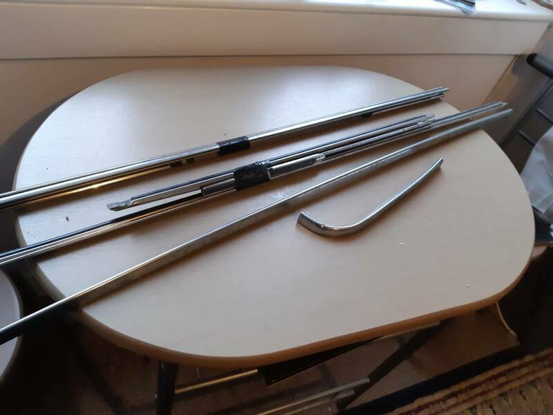

I have a stainless door mirror to go on as well...

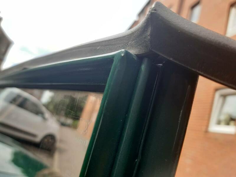

Firstly wrestling with these horrible door seals.
285861340_561335738698848_4627821129518632022_n.thumb.jpg.242620b824de72342ab6b453362b1390.jpg
The rubbers slot into a channel on the door frame. You can slide the rubbers on along the top and inside edge and then the rest has to be poked into place with a blunt screwdriver a few mm at a time. Both systems of installation are tedious to the extreme and by the end of door one the act of sliding the seal into place had torn the edge of my nail off my thumb. The blood wasn't even good lubricant. Repo seals aren't shaped to the door like the originals and are just cut from a roll, reputedly they're even shitter to fit, hence my reusing the originals.
With rubbers installed I got the doors more or less lined up and adjusted the door latches appropriately. I then spent an age fitting the door handles. The rear examples aren't too bad, the fronts require child hands which bend backwards in order to get at the required linkages. It'd be much easier if I was to removed the window mech, which wasn't going to happen.

I then swapped out the rocker cover gasket and set the tappets. Also removed the temporary fuel pipe installation draped over the rocker cover and replaced it with a slightly less temporary length of hose running along the bulkhead.

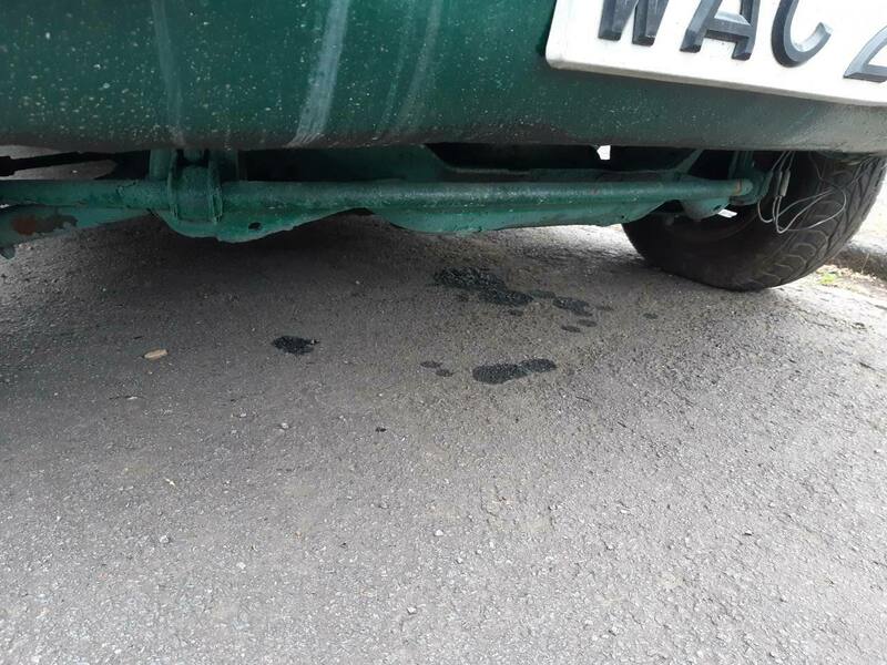

Still pissing out the rocker cover, and I think the fuel pump gasket. I swapped the oil cap for one with a better seal as that was leaking as well. The dash also fell off when I hit a pothole.

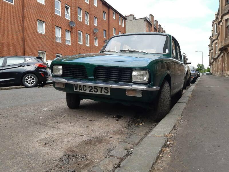

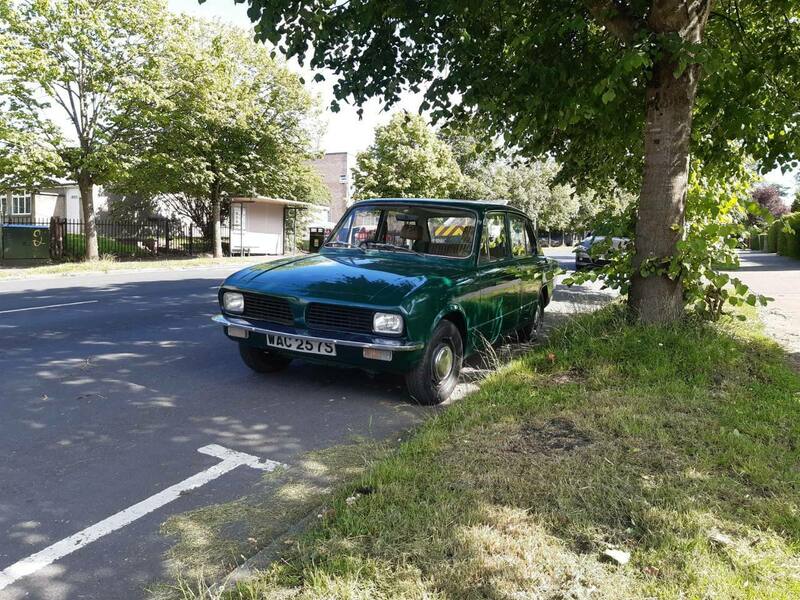

Then I saw the car in proper sunny weather for the first time.
285724095_1766731557009236_2070692721924313998_n.thumb.jpg.7f3a35679efe1ea96d274aec1fc4b361.jpg
I also took it for another local run to take me and Girlfriend_70s over to Mugdock Park.
285988969_1182226489207575_2267246346770672769_n.thumb.jpg.eb9f512aebd95d058d84e52939bf752d.jpg
It drives pretty well and can now be fine tuned with road use. Can get a bit grumpy and develop a miss when sitting hot in traffic. Usually I'd say that's fuel starvation but it starts first turn of the key if it cuts out rather than needing to be cranked so it could be toasty ignition components. With the choke disconnected the easiest way to cold start it is to jam the choke open with a screwdriver for min or so until there is a bit of temp in the engine, then wind the idle speed up a bit until it's properly warmed up.
I also pulled more bits of Volvo off.
285473482_3155966137957957_8455652638235768531_n.thumb.jpg.0ff786604382c8560bc448158029939c.jpg
285495575_3245424905701698_7233724180895683060_n.thumb.jpg.3fca0c11d8939952043d627d4a9365d0.jpg
Having pulled all that shit off, prodded out drains, scooped out moss and dirt and pulled off/re-seated grommets... It still leaked.
By the method of pouring water on the car from a bucket and then watching it from the inside I found it was running into the footwell down the A pillar under the rubber seal for the door. It is actually coming in somewhere near the middle of the windscreen and running along the plastic trim which leads the headliner like a gutter to whichever end is lowest. At least I now know which location to fuck more sealant into, all other more minor leaks seem to have been sorted...
280614943_411733510957176_8412780295832818058_n.thumb.jpg.4f74074a36d06c32587ba31b146ac0f2.jpg
281138075_355594313218542_6688576865115764172_n.thumb.jpg.bfde66847d68ee85bd07f4e9605c6aef.jpg
All the lighting contacts were cleaned as well. Resulting in working headlights, tails, brakes, indicators, hazards and reverse lights. One headlight is either always on high or is missing high and is really out of alignment, one sidelight is also dead.

Oh. The Volvo still fills with water and the Acclaim has either shat it's water pump or the engine is cunted. A NOS pump is enroute.

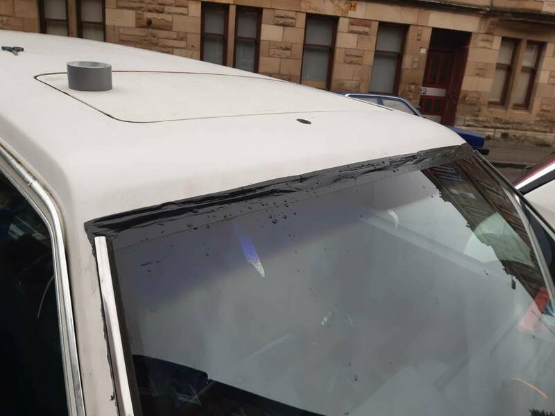

Kept filling the Volvo with sealant, it kept leaking. I have now found a solution though.
With that problem permanently* solved** I put the interior back in.

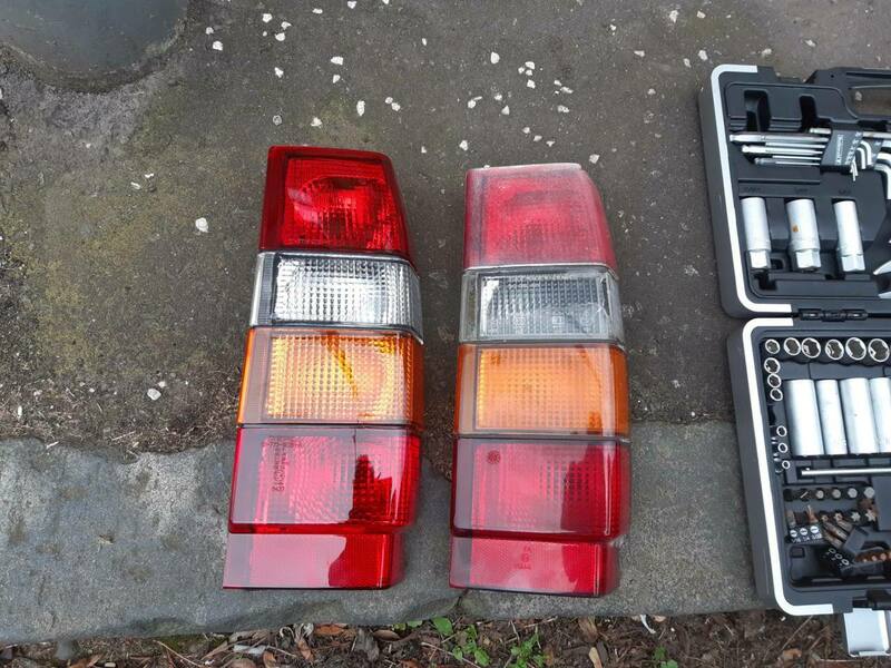

I also fitted a less fucked rear light.

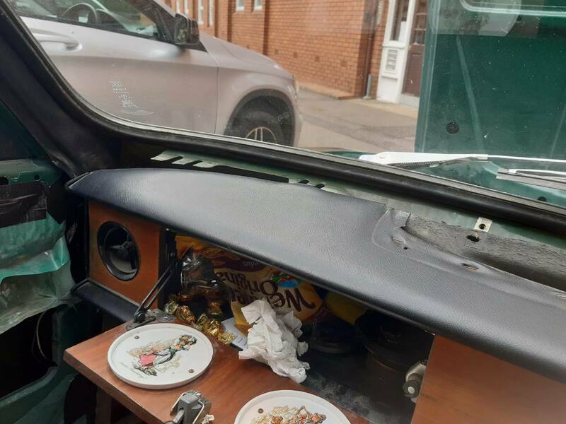

Threw the Dolomite's door cards in and affixed the dash correctly. Fitting the fresh air vents makes it quite a bit less horrible on warm days
