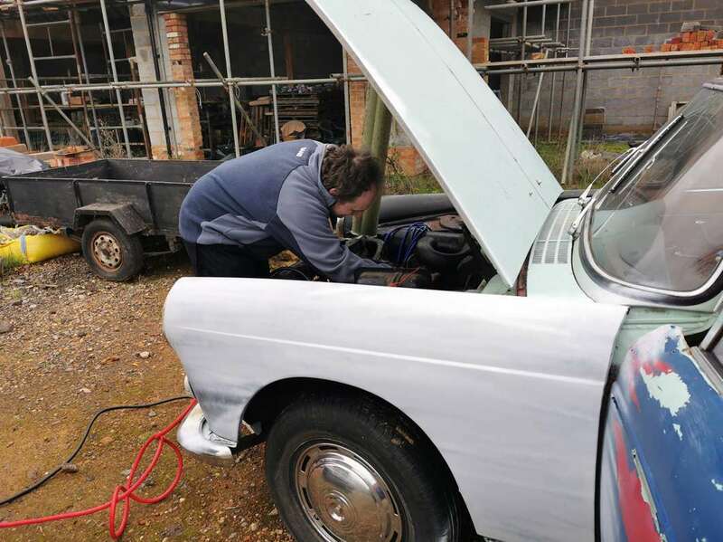

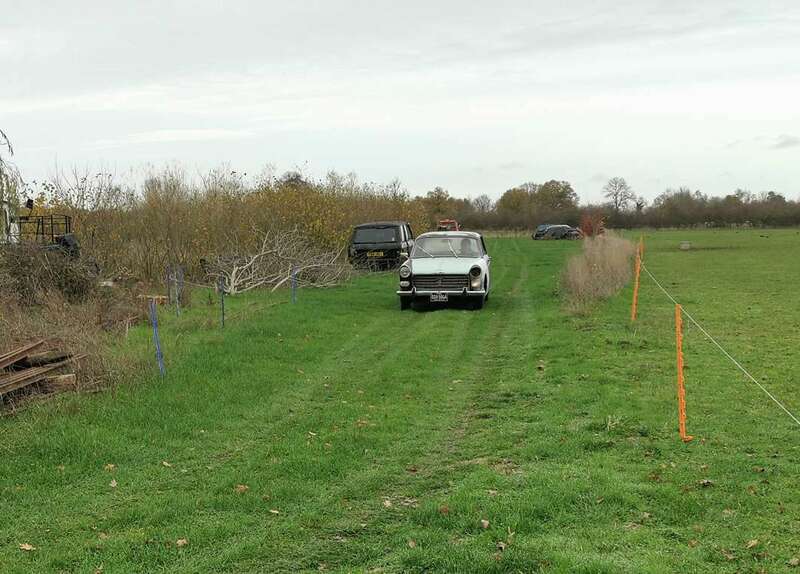

Six-cylinder Posted November 26, 2022 Author Posted November 26, 2022 It turns out Shire horses really like Peugeot 404s! With @Zelandethhelp we got the 404 fired up today without too much trouble. We noticed it is sucking air in the fuel filter and there is visible cracking on a rubber fuel pipe that needs attending to. There is also a hot restart problem. Temperature held steady and the right side indicator warning light works. All in all I would call the first start up in my ownership a great success and we did drive 0.9km. RayMK, RobT, Surface Rust and 17 others 20

BL Bloke Posted November 26, 2022 Posted November 26, 2022 Good to see that the 404 started and was able to drive up and down the field. 🙂 I can come down in the week after Christmas, not sure how much use I'd be though. If you still need wood for the shelving in the container I can bring some down with me. Six-cylinder and Mrs6C 2

Zelandeth Posted November 26, 2022 Posted November 26, 2022 Rather impressed by that little Peugeot. Reckon with a bit of elbow grease there's a really pleasant little car there. I'm usually far, far, far from the sort of person who goes for the whole "rat look" thing, but there is a part of me which does say that the ridiculous colour contrast going on here is such a thing in itself that it should stay. Unfortunately it also screams out "Hey, Mr. Policeman who's having a really crap day, pull me over!" I reckon. So getting it back to being at least mostly one colour probably does make sense. Didn't take much to get it going really. It was initially a little reluctant to pull fuel through, but when we saw that there were bubbles being pulled through the filter once the engine was running that pretty much immediately explained why, as it's obviously pulling air in somewhere. All of the fuel hose in the engine bay looks quite crusty so will be swapped out before we do anything else. If there's still air getting in then we'll worry about the other end - odds on the tank pickup being easily accessible? Immediate observation: What a sweet sounding little engine. Aside from a little bit of an exhaust blow from up front somewhere it's very quiet and extremely smooth. Probably one of the smoothest idling engines I've come across before the days of electronic ignition and injection. With it up and running a quick trundle around was had. I then had a shot. Things I noticed: [] I know we're not on tarmac, but man the steering is light. [] I know how smooth that field isn't. The suspension is wonderfully soft. Seats are bloody comfy too. [] I've not driven a huge number of cars with column changes, but this definitely feels like one of the most pleasant to use I've come across so far. So long as you remember there's no syncro on 1st, though hardly unusual on an early 60s car. [] Bit of a clatter from underneath somewhere on larger bumps, not convinced it's actually suspension and not just something rattling about though. [] Clutch release bearing is a little noisy, but not enough to alarm me. She ran absolutely lovely for probably 30 minutes or so, until left idling for 10 minutes or so, and then conked out when we tried to drive out to the field a second time. Sounded like we weren't getting fuel, but there wasn't a sniff of life when offered some easy start. I checked and we had a strong spark both at the distributor and plugs (well, number 1 anyway), but not a sausage in terms of signs of life. Until after about five minutes she started back up again, running awfully (behaving as if short on fuel) for a couple of minutes before sorting herself out again once we were driving around. Once switched off a little later she again absolutely refused to restart until after sitting for a few minutes. So we need to try to get to the bottom of that one as the last thing you want to have to do is wait five minutes to restart if you stall in traffic. Feels like fuel vapourisation (worth noting that the carb is basically sitting on the head on this engine - there really isn't an inlet manifold as you'd normally expect, it's just an elbow), though the fact she wouldn't even cough on easy start puzzles me. We'll figure it out. Seemed like the generator had lost interest in charging after we'd been running for a while, though it definitely was working when we first started up as it's something I checked early on while we still had the choke on. Guessing that's just going to be a duff connection somewhere, or possibly the points needing cleaned in the regulator (I'm assuming it's a points style setup at this age). For all it looks quite a state at a glance, I don't think there's really much between this car and the road. Aside from the rear arches, a bit on the bootlid slam panel and the lip of the bonnet the body actually looks really quite solid - though admittedly I'm saying that not having crawled around underneath it yet! Get the bits of electrical system that are currently disconnected hooked back up, sort the rear arches and the bonnet, then just tick anything else off as it becomes apparent I think. This isn't a car I'd ever really even thought about before, but it does seem a nicely thought out and based on admittedly at this point a very limited sample, nicely refined for the period little car. Though not all that little really...It looks somewhat petite by modern car standards, but it's a decent size. Guessing a Morris Oxford from the same sort of period would be the closest British competitor? Though I think the Peugeot may be a little larger, cabin definitely feels bigger anyway. I'm quite impressed and definitely will be interested to see how this progresses. LightBulbFun, RayMK, somewhatfoolish and 16 others 18 1
