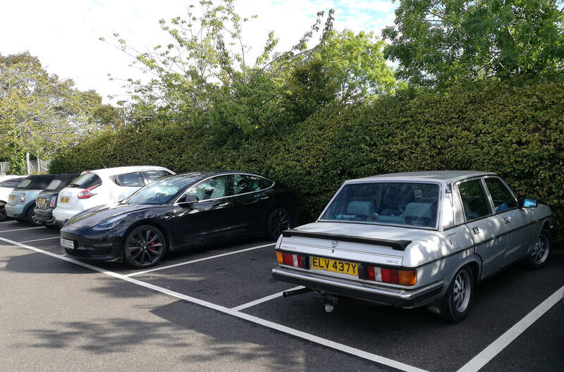

LightBulbFun Posted September 5, 2020 Posted September 5, 2020 15 minutes ago, Zelandeth said: More than happy to have it here for a couple of days - actually have a bit of room for a change as the Activa is still sitting at a friend's place waiting for an MOT slot. Depending how the bulb failure system works just changing the brake light bulbs for a matched pair may well sort it. Some systems work by measuring the resistance of the bulbs and look for an imbalance between them - so if the bulbs are a bit different nor there is a less than perfect connection (or ground...because Lancia) it can interpret that as a failed bulb. The earlier offer to tackle the 2CV greasing regime remains open too. how are you for invacar brake system overhauls?
Six-cylinder Posted September 5, 2020 Author Posted September 5, 2020 18 minutes ago, Zelandeth said: More than happy to have it here for a couple of days - actually have a bit of room for a change as the Activa is still sitting at a friend's place waiting for an MOT slot. Depending how the bulb failure system works just changing the brake light bulbs for a matched pair may well sort it. Some systems work by measuring the resistance of the bulbs and look for an imbalance between them - so if the bulbs are a bit different nor there is a less than perfect connection (or ground...because Lancia) it can interpret that as a failed bulb. The earlier offer to tackle the 2CV greasing regime remains open too. I have plenty of new matched bulbs thanks to Andyrew. I will send you a pm. I am feeling guilty that my 2CV has not been greased after Dollywobbler explained the importance of doing it regularly. LightBulbFun 1

Zelandeth Posted September 6, 2020 Posted September 6, 2020 Suspect from a brief walk round check I've likely pinned down the cause of the errant tail light failure warning in the Trevi. Noted that when either the brake lights or tail lights are lit that the indicator flash rate on that side drops by about half. That'll be a dodgy earth needing some attention then. What do we want to bet that cleaning up or reterminating the relevant earth connections sorts both of those issues? Will get the electrical rehabilitation started tomorrow. Hoping to get everything done in the one afternoon with a bit of luck. Will depend a lot on how much of a pig it is to get into the dash - especially wanting to be very, very careful of by now probably very brittle plastic. Floatylight, Mrs6C, Six-cylinder and 2 others 5

Zelandeth Posted September 7, 2020 Posted September 7, 2020 Yep...Had a look in the dark just before locking up for the night - the offside rear indicator is glowing *very* dimly whenever either the brake or tail lights are on. Time to go hunting dodgy earths. To be honest unless it's a really awkward setup I probably won't actually go hunting anything - I'll just examine and probably re-terminate all the grounds on or in the vicinity of the tail lights as a matter of course given that we have evidence of trouble with them and given the tendency for them to cause all manner of electrical headaches with Italian cars especially from this sort of era. Rather than trying to hunt down a dodgy contact it'll be quicker and better for long term reliability to just sort the lot. @Six-cylinder I hope you do realise that you're going to go and have me wanting a Lancia after this. Granted...The five minute passenger ride in the Gamma already did a pretty damn good job of that. A Gamma Berlina is absolutely on my lottery win shopping list and has been since the moment I sat in yours. Every time I've walked past the Trevi though I've noticed more little nice design touches. While the proportions are a bit odd and at a glance the interior is just mental there's a huge amount of penmanship has gone into that car. The door handles and the little name badge by the rear window below the kickup in the roof line are probably my favourite touches so far. Shame the metal strip with the name/model on is lost a bit on a silver car...Reckon black or Ferrari red would be the best colours for the Trevi. Oh...Or now I think about it, that slightly burnt yellow colour you occasionally see Ferraris in, that would work nicely too. I still reckon black though, would offset the ample amounts of brightwork nicely...and we all know I've got an affinity for black cars with lots of chrome. The other thing which I had completely forgotten was how comfortable Lancias from this sort of era were...I can absolutely see why you've been using the car so much since you've got it back, the seats are like a lovely old well care worn sofa. How does the ride compare to the Gamma? I remember that being something which surprised me the most when I was a passenger in the Gamma...While it wasn't *quite* there it was approaching Citroen levels of wafty even on the bouncy road by your place. LightBulbFun 1
