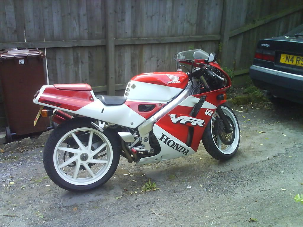

Here is my old VFR400.

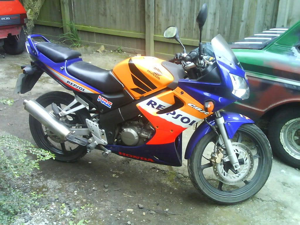

I also had this CBR125. It should have been call the CBGR12.5 as it was fucking A for nipping round town. If I move and need to commute further to work I am defo thinking about getting another.
I nearly ended up bidding on one of those CBR125 Repsol's - my initial reaction was 'jeez, what a dreadful pikey custom job' but after finding it was a genuine Honda special edition I warmed to it a lot, sadly it was cheap for a reason with a lot of cosmetic damage and suggestions of mechanical neglect.  It looks like a big heavy bike for such a little engine but I'm assuming it's mostly just plastics.
Yeah, its light as owt else in that size bike probably. I did feel like a bit of a tit as it kind of looks like someone with a small bike trying to pretend they have a big bike but it really was nice to ride, small enough to nip in and out of the traffic and fast enough to hold its own on bigger roads if need be. No stupid exhaust trying to sound like its bigger though its quite refined really.
Back tyre looks a bit flat there like though.....
