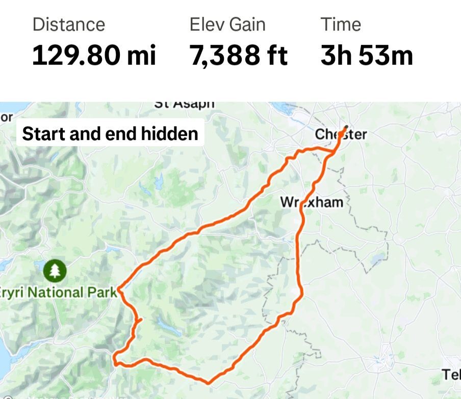

112 miles today. Was going to go to Shrewsbury, down the A49 past Church Stretton and then turn right before Ludlow, then through Knighton and Crossgates before dropping down through Dolfor, into Newtown and home. Not the sunniest or warmest day though, so went past Oswestry, right at Llynclys crossroads and eventually onto Lake Vyrnwy.  Cup of tea and home bought picnic at the cafe, then a slow but amazing route to Bala, through roads that could be in the Highlands. Luckily (narrow, steep and single track) there wasn't much coming the other way.
Had wanted to go to Lake Vyrnwy for years and years, but never made it there. It was well worth the wait though, proper nice place and the roads are made for bikes.

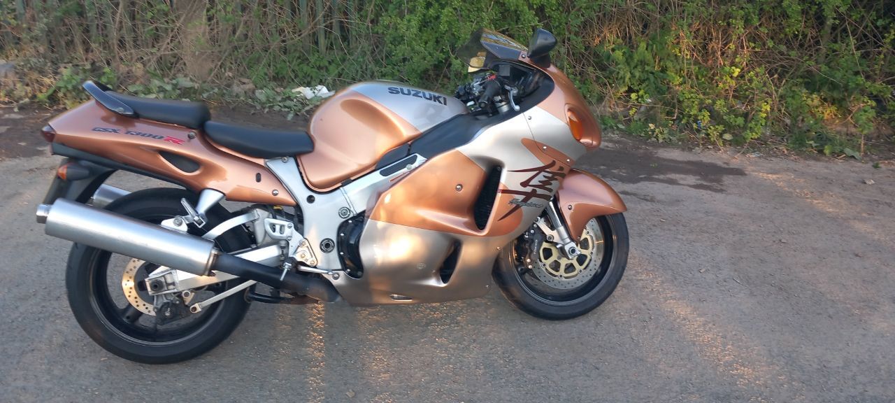

MOT'd for another year. I was toying with the idea of selling as middle age and hayabusas are not good bedfellows but I have been watching ebay and nothing is selling unless it is a no reserve auction. So it may be staying.
