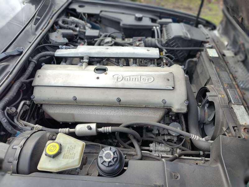

Next up some under bonnet checks. Pleasantly surprised how clean the engine bay is.
Now it may be a
but it's still Autoshite - zip-tied throttle linkage
and gaffa-taped air intake!
The oil doesn't look too bad but I've already ordered a new filter and oil so might just do it anyway.
The low coolant warning light is lit on the dash - could it be as easy as topping up the coolant?
That's a no then. Cleaning the connector on the sensor didn't fix it either so new sensor on order.
Looks like a hose might have let go at some point.
Will those white deposits just wire brush off? I can tackle it when the thermostat is replaced - currently the temp gauge doesn't get above a quarter so I'm following @SiC's tip of replacing the thermostat on acquiring a car. I'll replace any dodgy looking jubilee clips while I'm at it.

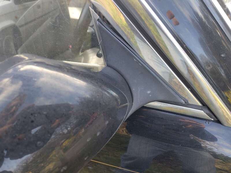

Other than that the only other pressing task is the drooping door mirrors - they're the stock item bolted on to a fillet the converters must have put in and they're showing their age.
Visibility isn't great in them anyway and a vehicle this long ideally needs larger mirrors. I'm not precious about keeping it as is so will explore options for fitting larger mirrors off a van, preferably with a built-in blind spot lens.

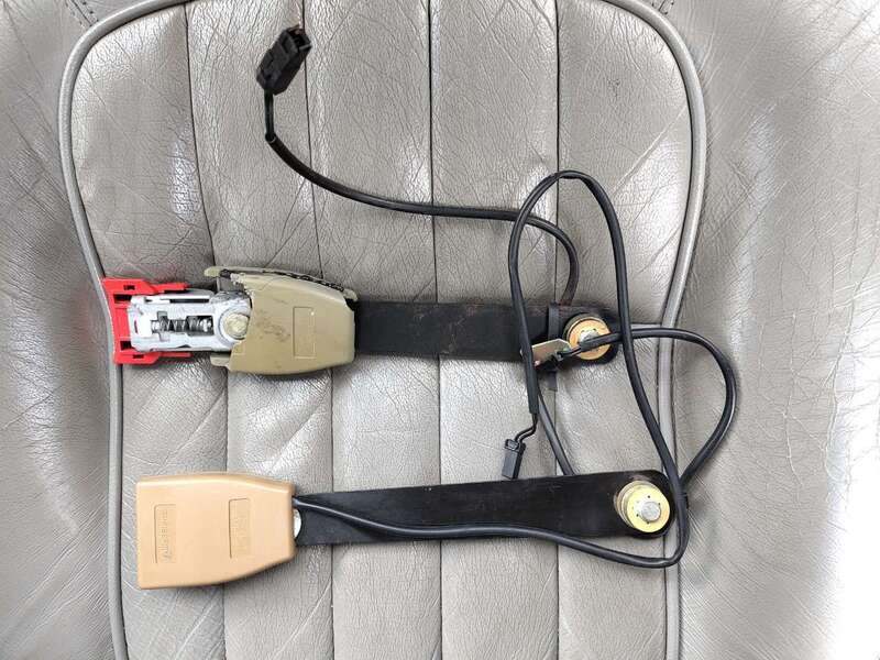

Next was this:
which had a nasty habit of popping open at the merest provocation - I really didn't trust it to hold me in the event of a collision. They're a known weakness of the X300 and it's the driver's side that goes most often. Unfortunately they're handed so a passenger side won't do so consequently the driver's ones command a premium. I ended up spending nearly a tenth of what the car cost me but I'm worth it.
Shame I couldn't find one the correct colour - one might have turned up if I'd been prepared to wait but I'm using the car daily so wanted it asap.
I got all the bolts out one handed and then tilted the seat to access the buckle as I couldn't lift the seat and didn't want to unplug any airbag connectors.
Finding a quid was a bonus!
Job jobbed and no lights on the dash.
