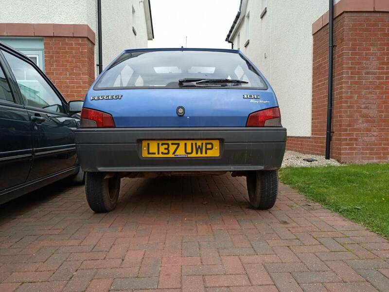

The misery continues.
Difficult to see but it's sitting several inches lower on the driver's side rear.
People have suggested it's a snapped torsion bar.
Balls.

i used to find my 106 sat low on one side after i got out but would level out if i took the handbrake off and rocked it back and forth
I had a gander underneath and it's positive.
I believe neither torsion bar is fucked. I've inspected both, hit them both with a hammer etc.
I compared tolerances and gaps across everything on the rear of the car by hand/eye. Nothing is noticeably different.
I did notice that pre inspection there was a 2.5 finger gap between arch and tyre at the driver's side. Up from 1 when I checked mid drive yesterday. This means something is tired but returning slowly. Neither shock looked fucked and neither was damp/wet/explodey.
After taking it off the stands it the suspension was almost equal on both sides. After sitting on the boot lid and applying/releasing pressure it was mostly equal.
The conclusion: I'm a fat cunt and something is possibly tired but not fucked.
That is the arm bearing on that side collapsing unfortunately TADTS.
You used to be able to get an exchange axle for about £250, possibly still can as Peugeot used that style of suspension until relatively recently so hopefully the people that do the rebuilds are still going.
