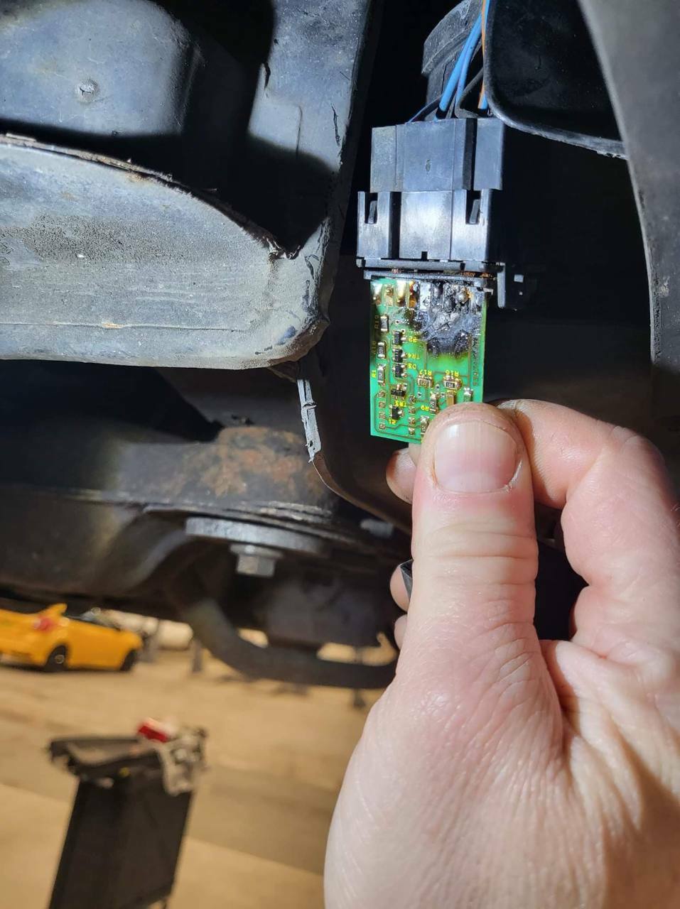

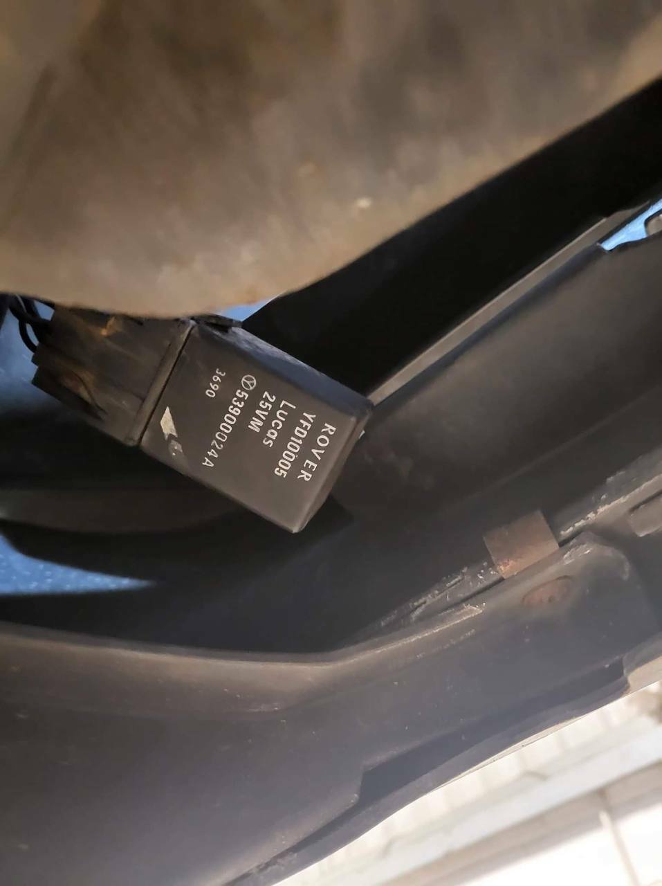

I initially suspected the bulb or a bad earth but after checking the bulbs changing them and checking them again i moved on to the headlight unit which i quickly ruled out too. I then check the relays in the fuse box and the fuses themselves were all good.... However while searching for the fault discovered that a relay located at nearside of the car behind the bumper corner under the nearside headlamp just next to the rad pack had blown.... The wiring to the relay next to it had come away from the relay plug itself too.... Now i am not entirely sure the blown relay is the single direct cause for the headlight fault but as the relay is a bulb failure relay i believe it maybe connected.

The Rover part number is YFD10005 and the Lucas part number is 53900024a. Please check your sheds pockets breakers and lofts etc.....  If anyone has one or knows were to source one please let me know!!! The car is otherwise sound mechanically and cosmetically its simply this fault letting it down...... I feel the fault could very easily condemn it or il be forced to take it off the road as the next MOT is due soon and there is no way it will pass with the fault.... These cars are so good and reliable I strongly believe it will be parts availability that kills them and nothing else.

What's special about it? Can you get pics of both sides of the PCB etc.?

The fault that burnt that relay out was presumably too much resistance on the low voltage side of the switch.
Could you track down a data sheet for the relay? If so I reckon you could build something to replicate whatever function it does.

Special as in it was only on the MK1C with trip computers and i cant fucking find one! 🤣
