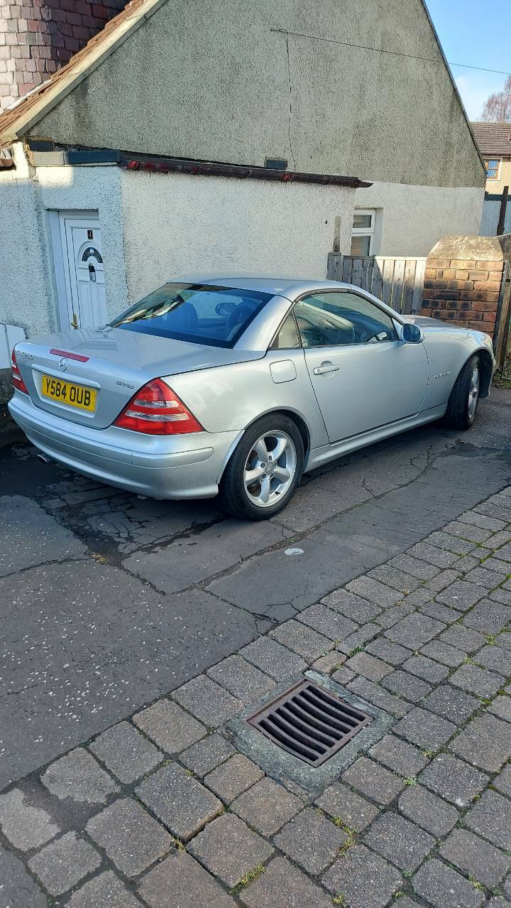

Barry Cade's Silver Dream Machine.
The shite dry spell has ended, I have got back in the drivers seat of a cheap shonker, something I've been after for many years after driving one as an apprentice and deciding "one day"
No collekshun Fred, as I just nipped up the road to buy it,as the previous buyer didn't appear and I was next in line.
230 auto supercharged .. long MOT and fsh! I did break my normal shitey budget,but not by much..
Problems so far.. abs/esp lights on.. needs an abs ring
Headlights are badly condensated..  Tadts..
Front bumper corner brackets u/s .Tadts..
A brake light bulb was out..
Aircon empty..
some small blebs.  Tadts.
And that seems to be it 😲
And yes, the roof works perfectly.. it was trust in Benz that made me press the button in the middle of a storm.. phew..
These seem a mega-bargin and so many for sale. I'm sure we will all be interested in how it goes.

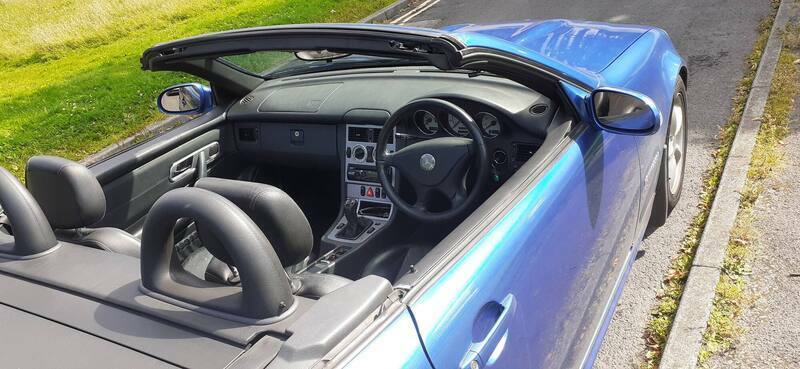

Lovely. I liked the forum bike one I had but the non adjustable steering wheel was a right PITA, couldn't get properly comfortable in it. Yours will probably have one though, think it was just the early R and S plate ones that didn't have it. Would have another
Yup, steering wheel goes in and out, but not up and down. Luckily I'm Benz shaped..  we have hols in August, it may be going to Monaco 😆
I couldn't get my arms properly straight, and my right knee always hit against the wheel going from accelerator to brake.  Head pretty much touched the roof lining as well. The CLK was more suited to my bulky needs 😂

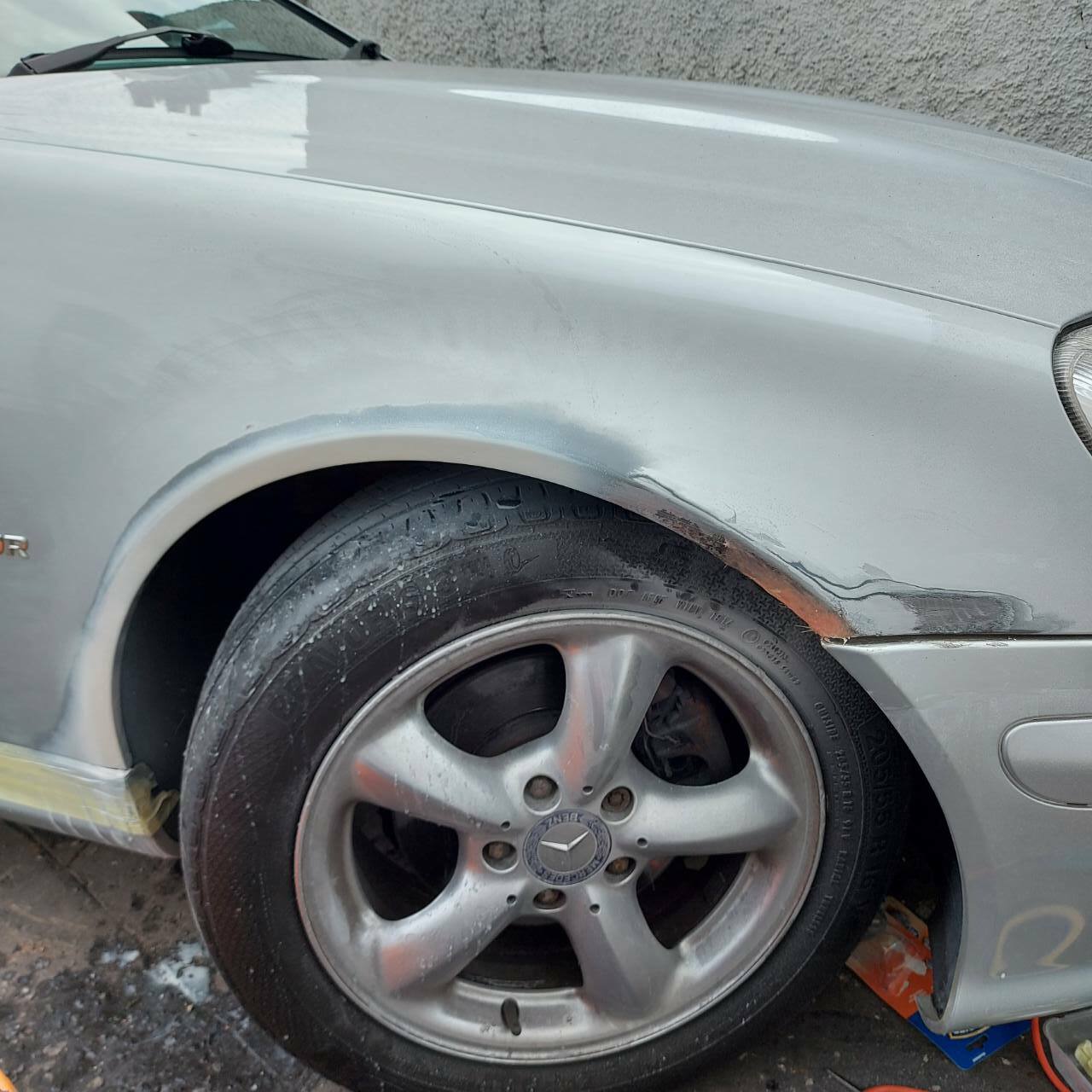

At least it isn't the two tone silver / rust you usually see. I have seen a few with lots of metal missing.

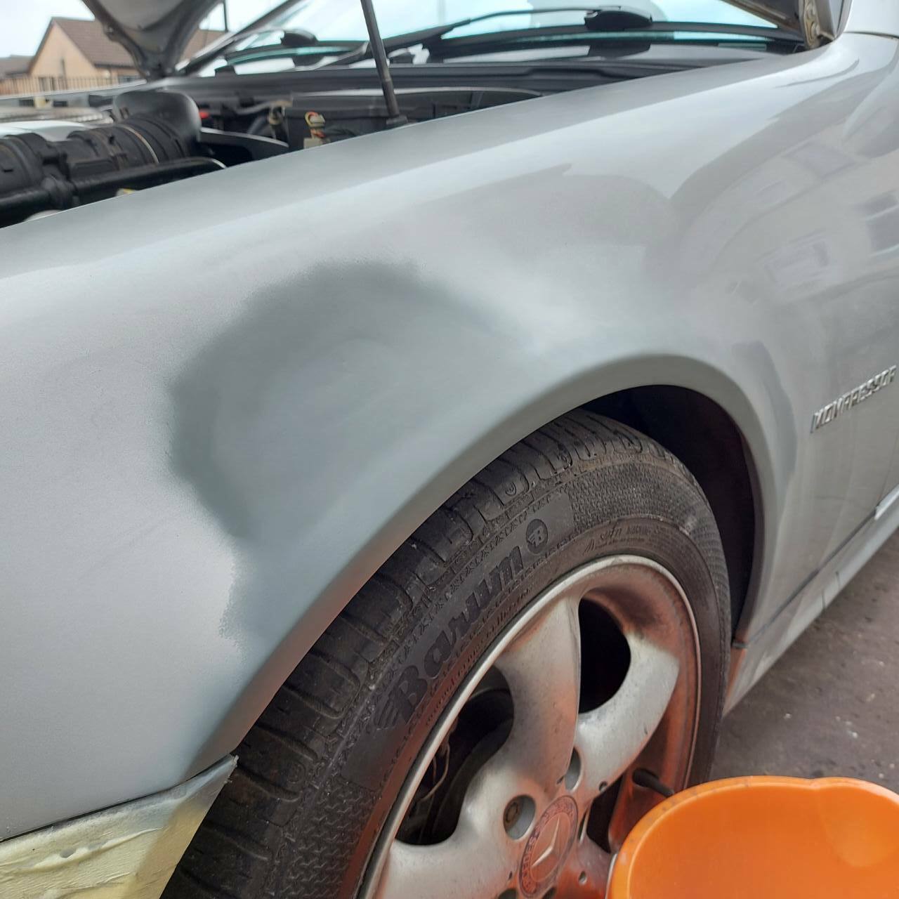

It's not terrible,  I just stuck the hose under the arches and loads of mud came out.. hopefully I can slow the spread down!

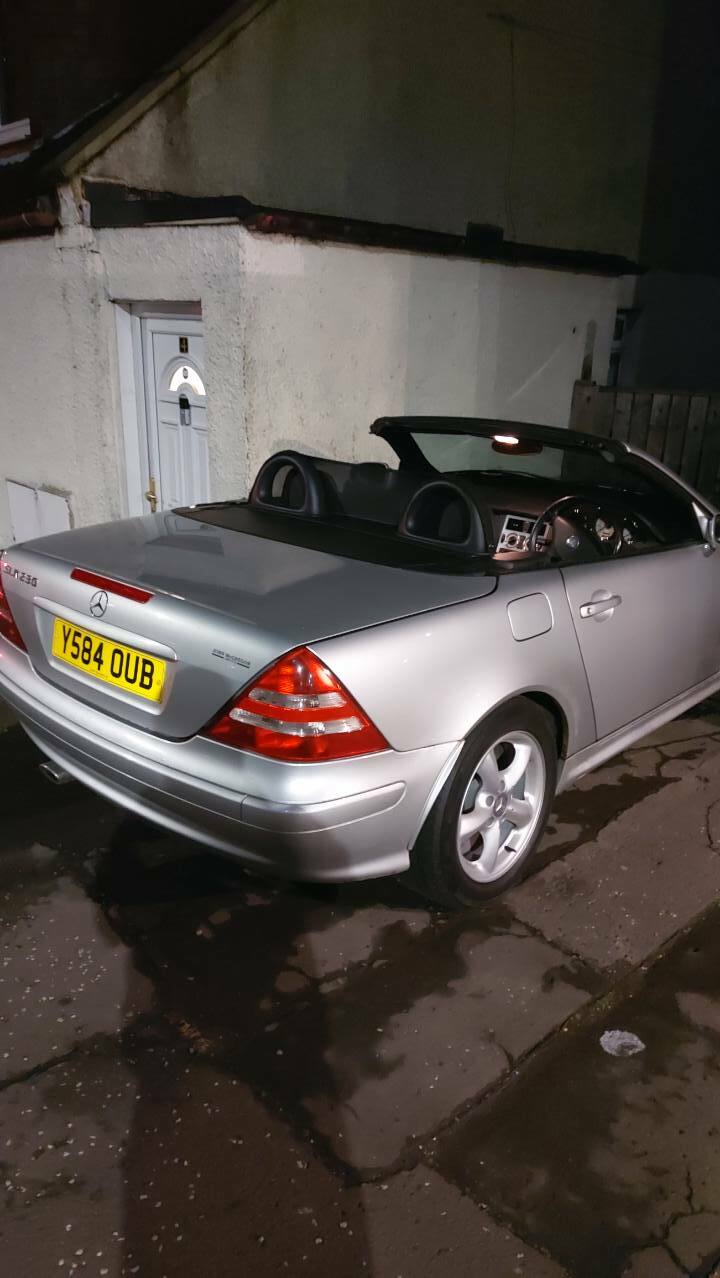

9 hours ago, Barry Cade said:
Roof proof..
Pfft not buying that as proof. You just dismantled it and gave us this photo in a vain attempt to prove that your roof works. Come back with a video then we can talk 😁

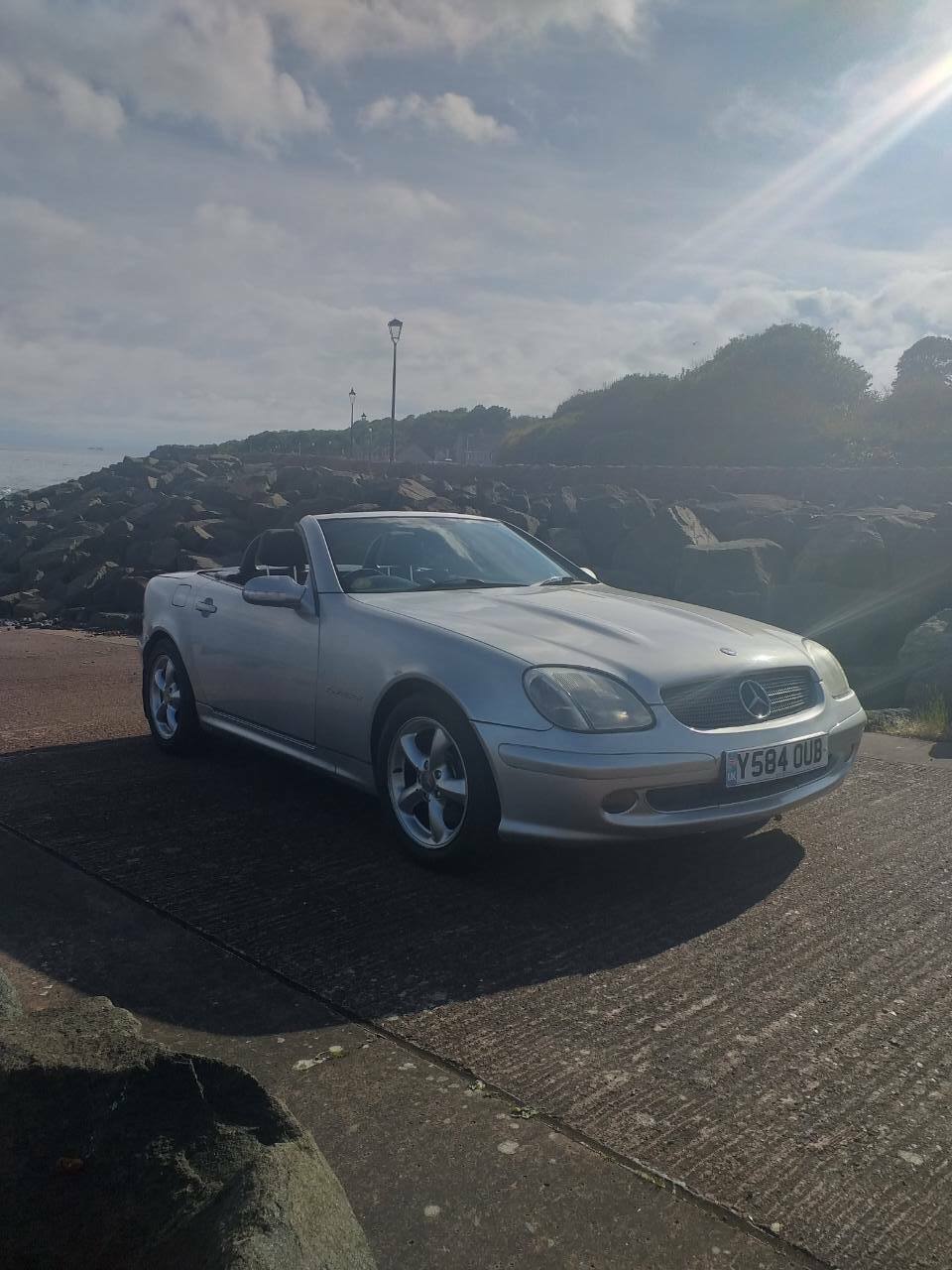

 Nipped past my sisters earlier, who seemed might impressed wee brother has a "posh" midlife crisis car 😆. Went to show her the SLK party piece and... nothing. Well, apart from a few beeps..
After a few mins of a total anti climax, pressing buttons and " well what is it supposed to do?.. I remembered I hadn't pulled the boot screen back after taking all my tools out. 😖

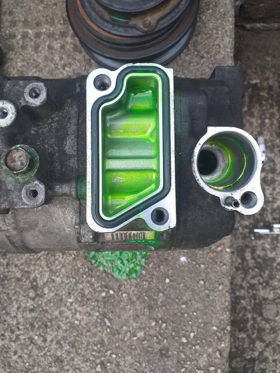

Bolleux.. aircon died...

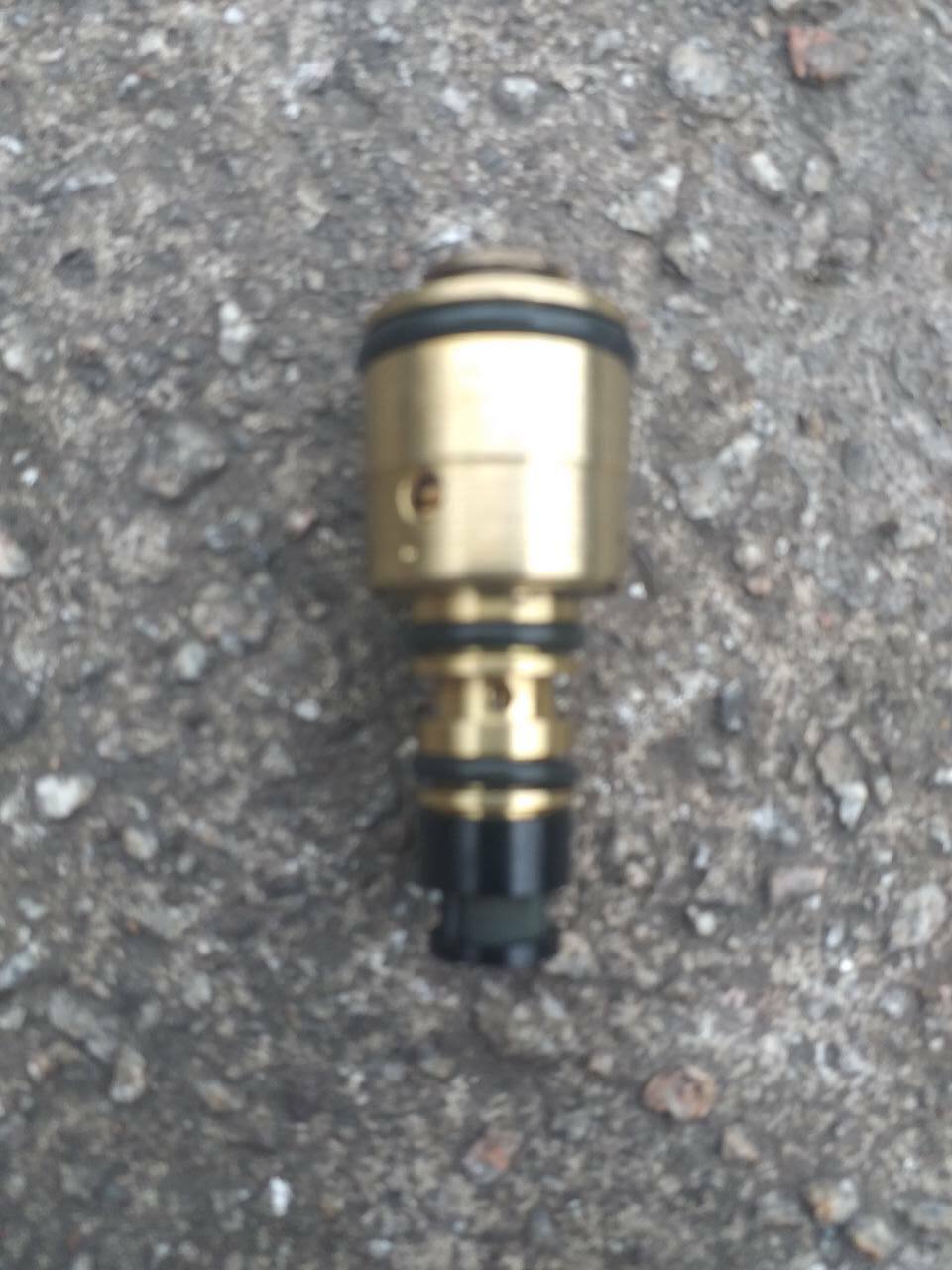

Compressor still running, system is gas tight and up to pressure, but no cold  a lot of learning has been done the past few days, and I find out it has a variable swash plate compressor, which adjusts output according to demand. Well, demand was high cos it was hot, and output was fuck all.
Ripped out the compressor and found someone has chucked 11 gallons of UV dye in it at some point,  which has clogged the control valve screen in the compressor so no adjustment.
Found a low .mileage Chrysler crossfire compressor cheap on Ebay so it's on it's way..

Aircon is fixed.. compressor rebuilt with replacement solenoid. So cold now it hurts. 🥶
