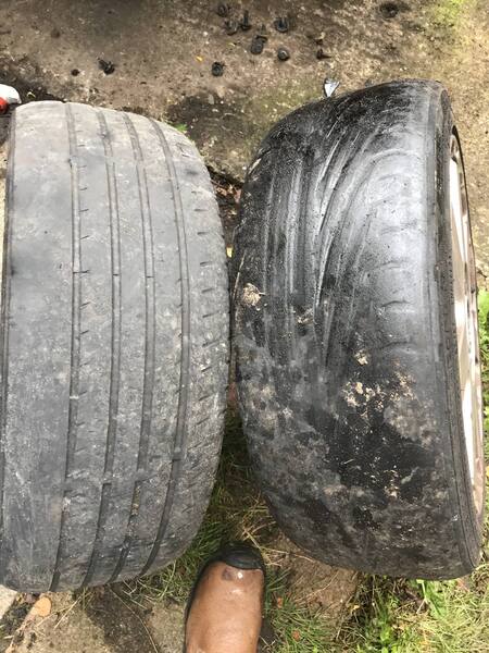

Nothing new re the tyres on baby carriage we got this all the time at least 10 years ago.
More important things to spend money on (I fones,makeup,splifs,etc) & they check them on mot don't they same wiv oil & water init!
