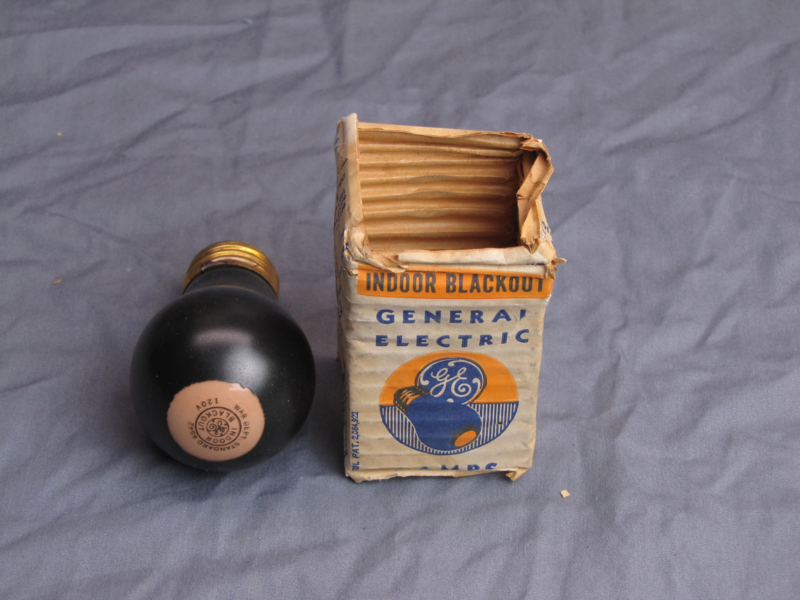

yeah its one of the reasons I posted it as I doubt many people here have ever actually seen one etc :) all sides of the conflict had them, even the US which is not a country you normally associate with night time black outs etc (curiously I have seen more european and American ones than I have british ones, but that might be down to there being more Euro and American collectors than british ones etc)

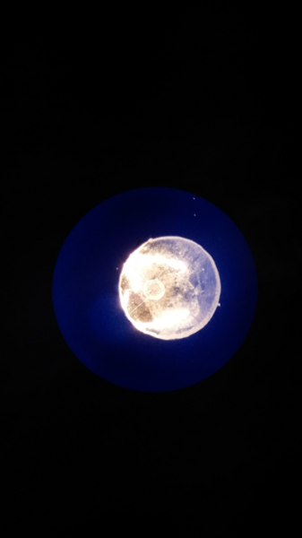

indeed they where generally used where there HAD to be some sort of light, heres the description that went along with the photo I shared above :)
Quote
Here you see a Vintage 230 volt 40 watt Blackout Lamp with Blue Glass and Clear Aperture at the bottom of the bulb and BC cap, this for locations where area can't be blackout/or where the Lamps can't be switched off, example in Air Raid Shelters, Hospital or other Entrances, etc. this Lamp is designed to comply with War Time Regulations (1939/45) where during Blackouts NO Lighting can be used, but these are ideal.
As you cansee the box is marked is stamped A.R.P which means Air Raid Precautions. sadly the filament in this lamp has broken.

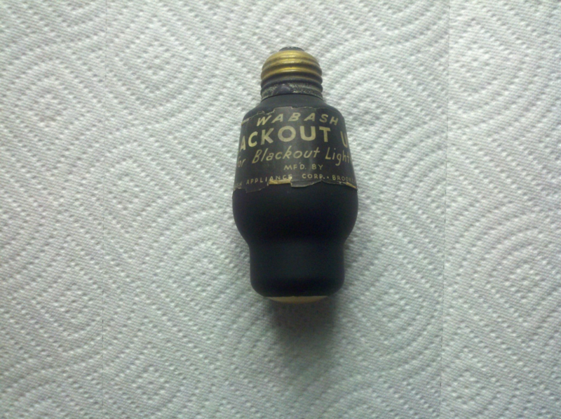

heres a couple more british examples from another collector, these ones are Cryselco made, 15W and thankfully do still work :)
heres a couple US examples

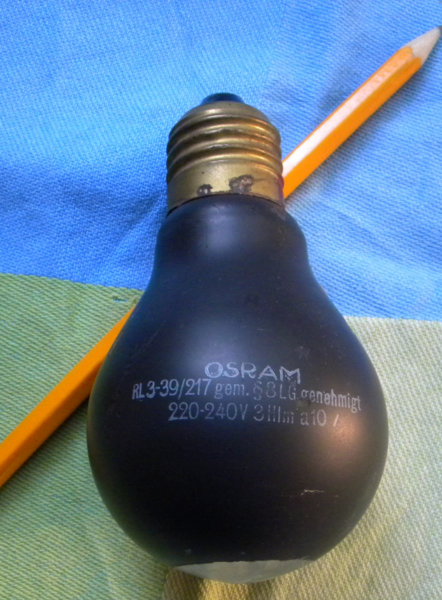

and finally a german example
sadly I dont have any black out lamps in my own collection, they tend to be quite rare, but would very much like to get ahold of one or 2 some day :) (the above lamps being examples owned by various collectors on a lighting forum/gallery Im a member of)

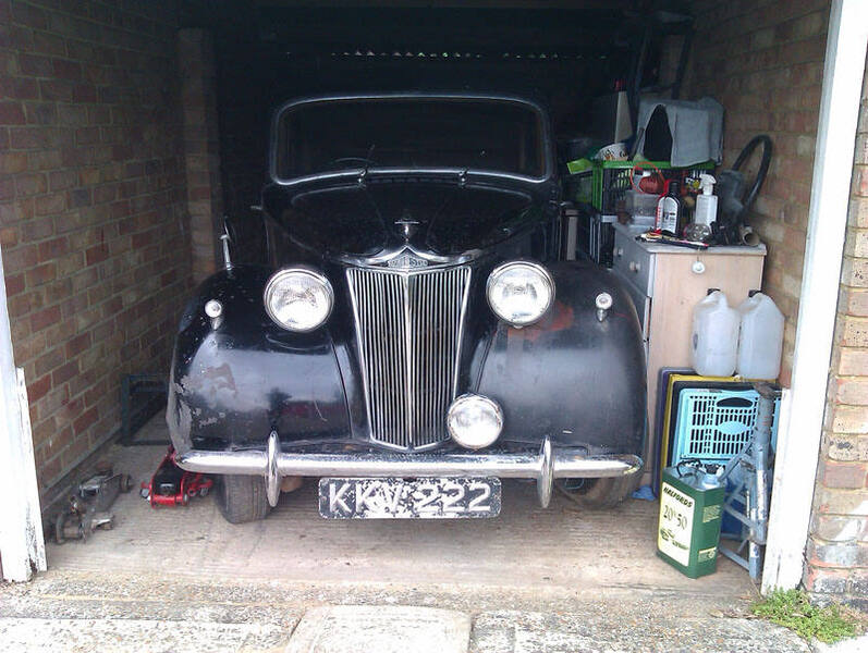

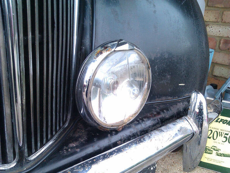

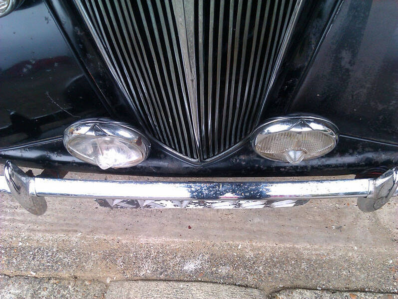

The new (to me) auxilliary lights arrived today so that meant I could get those fitted. It also meant I had a closer look under the front and found a reason why the new wiring loom is probably a good idea.  There's all sorts of non-original wiring going on there, and who knows exactly why.  It does look like it's been there quite a while so perhaps this was done while the car was still in use and perhaps it was the failing wiring that actually took it off the road.

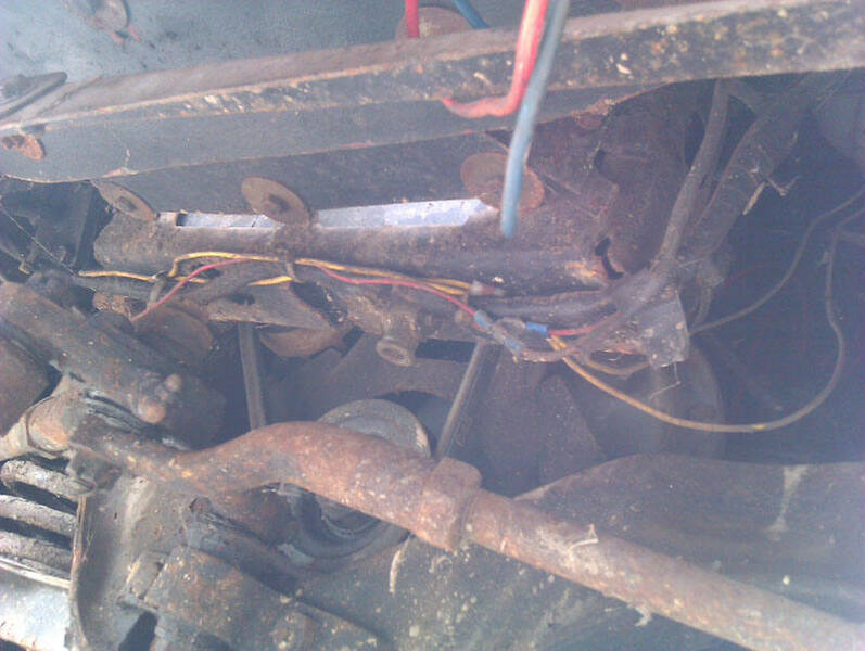

For those unfamiliar with it (I know I am) here's a view of the front suspension.  Overall, there's nothing I can see that's obviously problematic, some cleaning and regreasing will highlight anything that can't be seen right now.
I knew from the manual that there was  a drain tap for the coolant system somewhere and was pleased to find it and find that it's quite easy to access.  I haven't attempted to turn it yet, I want the car out of the garage and moving under its own power before flushing the coolant.  I assume the internal thread in the drain tap is so that you can connect a suitable hose and direct the old coolant into a recepticle rather than just dumping it unceremoniously on the floor.
I did test the auxilliary lights and couldn't get any life out of them.  This isn't that important since they were bought mainly for show and to fill the existing holes in the bumper infill panel.  They really are perfect for this car, just the right amount of rust and deterioration to look like they've always been there and just the right size for where the previous holes were drilled.  I had to open out the driving light hole a tiny bit with a needle file to accept the bolt stem, the fog light isn't fitted yet as that hole is much smaller and will need drilling out a little larger.  It's an existing hole for an auxilliary light so I don't mind drilling this up a size to match the new light that's going in, we wouldn't even be fitting auxilliary lights if the holes weren't there to begin with.

@vulgalour I am afraid that driving light will have to come off again! Unless I am mistaken, that is the "spot" lamp and you also have a "fog" lamp. The fog lamp should go on the nearside to illuminate the kerb/verge/ditch in foggy weather, the spot lamp illuminates the centre of the road further away at high* speed. These things matter you know :-)
  • Like 6
@Saabnut I would get it the wrong way around, wouldn't I?  Easy enough to swap at least.

Lighting is one thing I was wondering about... It sounds good fun driving up quiet B roads using the semaphores etc but on an A road in town... Stealth is deffo the way it should be, but would it be safer if its there? I bet thay car looks frighteningly small next to a 3 door fiesta/corsa from the last 20 years
It's narrow, rather than small.  I need a chair to wash the roof, so it's the height and the odd shape (in modern traffic) that'll make it visible more than anything I'd expect.  Fitting high level lights on the back of the Princess made it lots more visible, and the standard rear light location on that is both larger and higher up than on the Lanchester so I'm pretty sure some high level rear lights are going to make it much safer as a result.
That is true, its going to stand out enough on its own isn't it!
Plus I guess you've got the princess for going into town and boring menial daily driving as the modern car on the fleet. This is for Sundays and high-days

Spent some more time with hand files to enlarge the holes for the auxilliary lights, even charged, the cordless drill just wasn't cutting through the steel as quickly as the little hand files were so I kept at it the old fashioned way.  The loose wires from the lamps are tidied up around the bumper irons for now, since the lamps are just for show.  We'll rewire these when we fit the new loom, get them working properly.  They do suit the car rather well.  The auxilliary lamps are a driving and a fog matched pair from Marchal, and just about perfect for what the car is.  The fog light lens is cracked and that doesn't matter either, if we find a good lens then we'll probably fit that, for now it's not important.
The other item I tackled was the front number plate.  I had a suitable stiff bristled brush and some black enamel and I just wanted to make the front plate more legible without making it new .  This was tricky because I didn't want to lose the wear on the plate by simply painting the whole thing black, which would have been quite easy.  Instead, I followed https://www.youtube.com/channel/UCvZe6ZCbF9xgbbbdkiodPKQ Baumgartner's lead by filling in just what was distracting around the letters to bring the plate into better focus without making it look brand new.  The new enamel should dull down to match the old so that it's not quite as obvious.  The stiff bristled brush allowed for better control of the paint's texture so it wasn't too perfect, or too imperfect, next to what was there.  Today's bits of work hopefully look like I haven't really done anything, because that was my goal with these additions.
Looks so much better all round (especially the lights being mounted the right way round :-) ) Looking good.
You've given it that Riley look now. Very upmarket. Good job on the plate.

I was quite surprised to see independent front coil sprung suspension under there. I was expecting leaf springs, as I thought these were quite pre-war under the skin. Just goes to show!

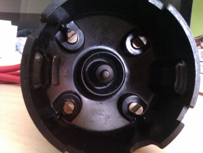

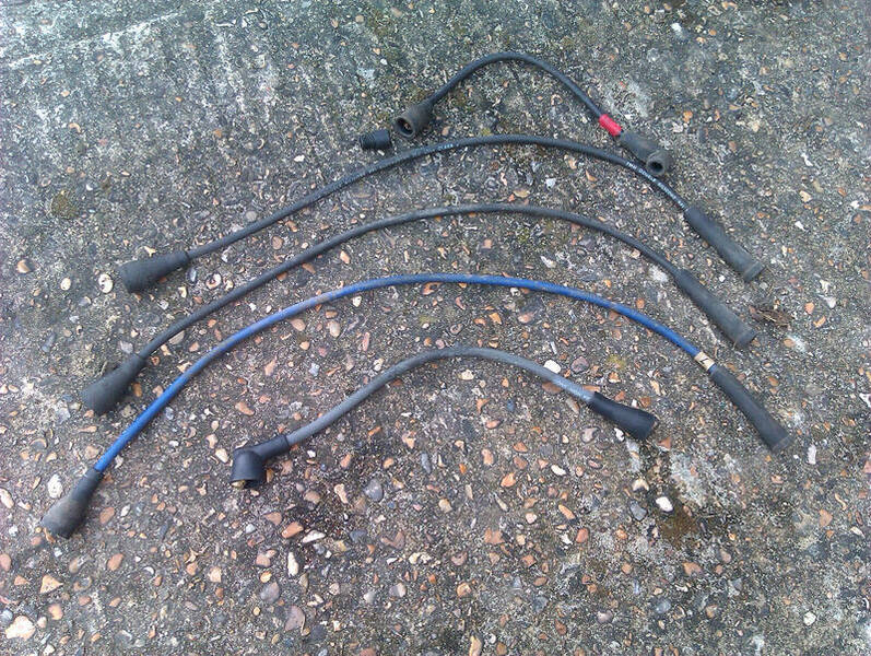

I'm on my own today so I'm a little limited on what I can actually achieve.  Plenty of time before work, Saturday is always a very late start and finish, which is good for tinkering.  It was also fortunate that the parts that would enable tinkering arrived today, we could finally complete the ignition leads and see if we could get to the bottom of the car's running issue.
The Lanchester is running modern 'bullet' type spark plugs with the old 'acorn' style distributor cap.  I ordered parts to make leads to fit both of these things since the plugs look fairly new and the cap is in excellent condition, there's no real cost saving replacing the cap to accomodate more modern leads and I've always wanted to have a go at making my own ignition leads so this seemed an ideal opportunity.  The acorn type fitting is new to me, 'acorn' referring to the screw fitting that goes into the distributor cap.  You trim back the sheath of the wire, feed a little brass disc onto the wires and then fan them out as evenly as you can to provide your connection.  The screw fitting keeps everything very secure and while it's a little fiddly, it's quite pleasing to do.  At the spark plug end, I opted for screw on caps rather than crimp on ones, I liked the look of these and it meant I could avoid crimps, which I don't really enjoy doing.  As it turns out, it's quite easy to install these and in a matter of minutes I had a nice new set of matching leads.
The distributor cap was in surprisingly good condition, I don't think it's a new item as there's some signs of wear.  Likewise the rotor arm and points, neither of which look like they're in need of anything at all.
The leads are on the long side, I guessed at the lengths since what was fitted before wasn't really a good template.  Once I know everything is good and working I will shorten the leads accordingly, because of the acorn fittings that's actually really easy to do.  The red actually turned out to be a good choice, it's much easier to see what you're doing because of the contrast they provide.  Unfortunately I'd made one mistake which is I bought what I thought was a straight coil connector to match the plug elbow connectors, what I'd actually bought was a straight plug connector, so it doesn't fit the coil.  No bother, I stole the king lead from the Princess which actually fit the acorn cap surprisingly well and allowed me to test the new leads.
The good news is the car cranks so much more willingly now.  Unfortunately, it didn't want to play ball and the starter motor just eventually gave up and wouldn't do anything.  I can't use the hand crank because, as spotted by a reader, it looks like the front engine mount is worn out because the pulley sits low, which makes it pretty much impossible to line up the crank handle.  Never mind, an attempt was made and I've learned these new wires are a significant improvement over the old.  Part of the reason the old wires weren't working was them having the wrong connectors at the distributor cap end, another was that one of the connectors had broken apart, and another issue was that they tried to plug one of the leads into an acorn fitting that was still in the distributor, the barest bit of old lead wire sticking out was just about making a connection.  Really, it's a miracle the car ran at all.
I was going to order a new coil cap for the lead I'd done incorrectly when I had a brainwave and realised I could just salvage a crimp fitting and boot from one of the old leads, which is exactly what I did.  Following the way the old lead was put together, I stripped back the lead sheath and folded the wire back so it made a good connection with the crimp, and then crimped it.  The lead and boot fits the coil very snugly and should, I hope, be a good solution.
