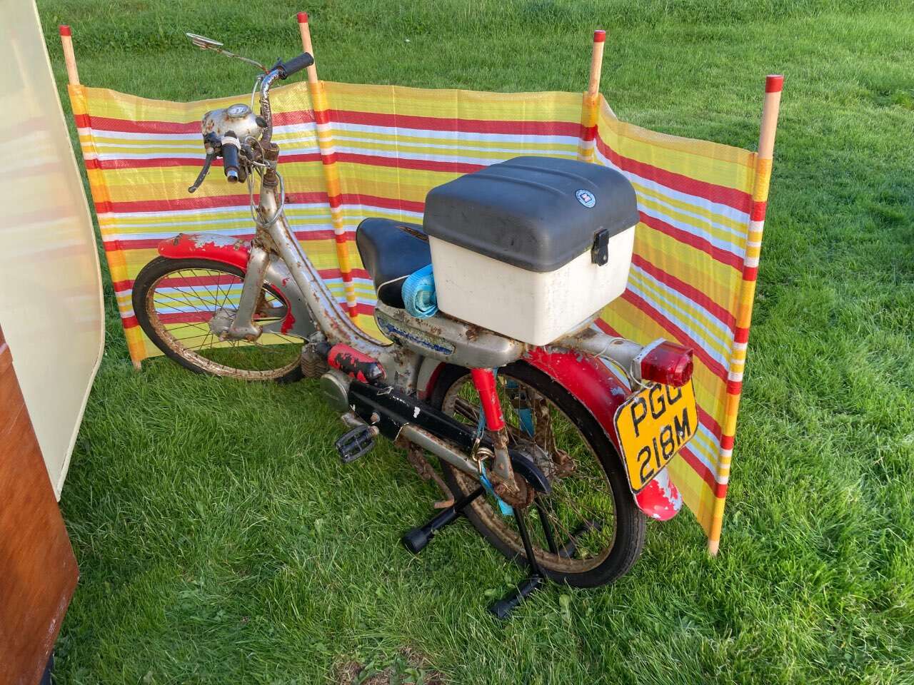

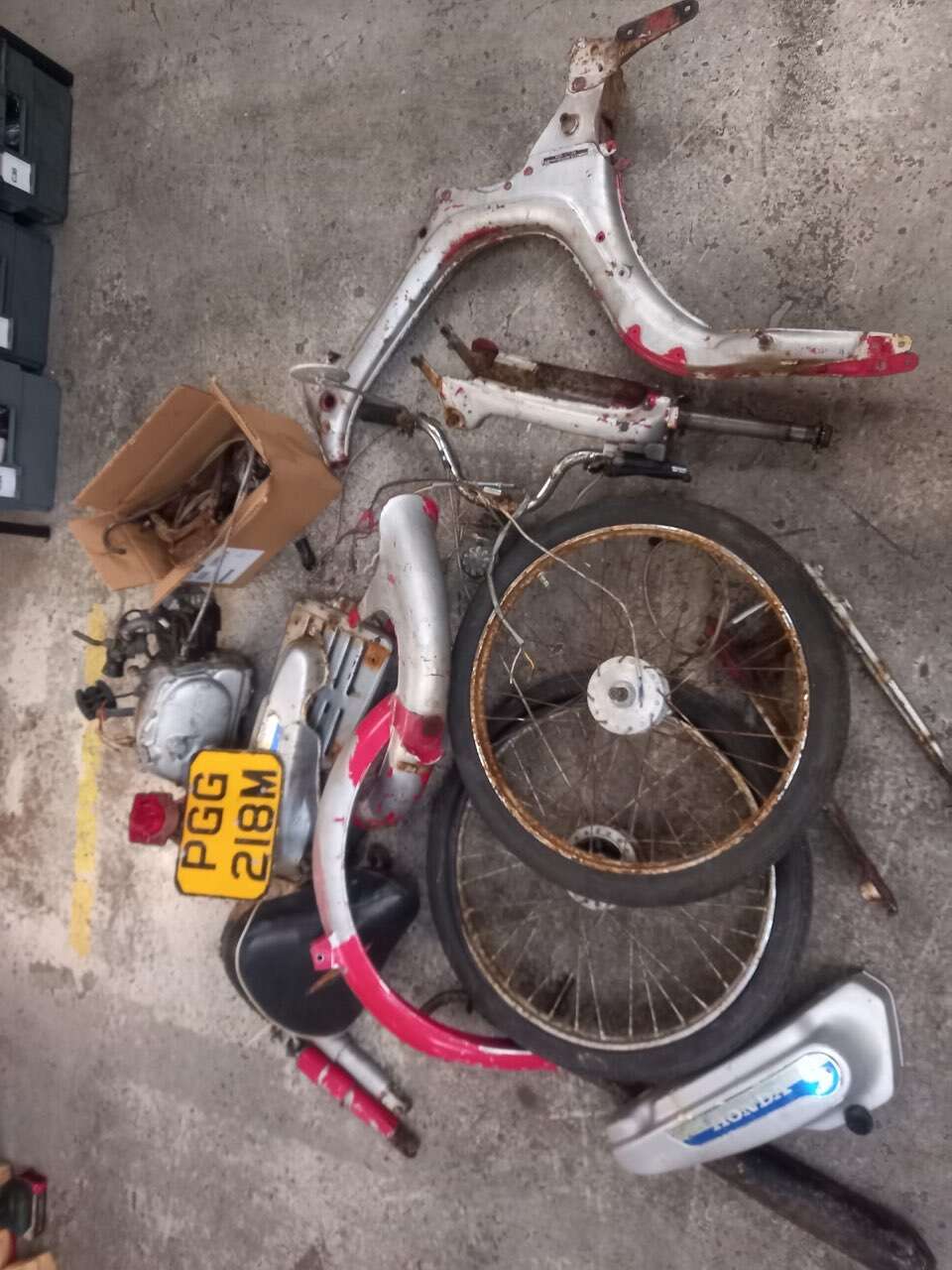

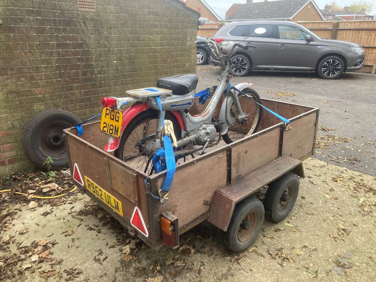

I picked up the roffle win Honda PC50 from Reb while I was on holiday in Scotland, brought it back home in the 1950s Eccles caravan.
I sort of fiddled around with it and tried to get it running, but the carb was full of corrosion and it didn’t have any compression (turned out to be a stuck valve/bent pushrod).
A good friend of mine and a proper bike licker expressed an interest in it as he used to have one in the 80s and regretted selling it. So I sold it to him and he’s already made a good start restoring it to original condition. All the shitty silver paint has gone and although he’s on a tight budget (he’s painting it with rattle cans etc) it’s looking good.
It’s actually a very original bike and has all the correct bits on it (apart from the aftermarket brake light switch and associated bodged wiring) which went straight in the bin. The frame isn’t rotten (which considering it sat outside for a long time is a bit of a miracle).

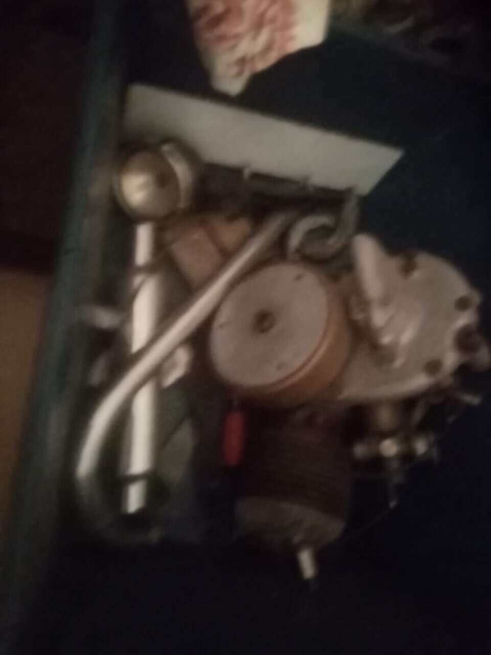

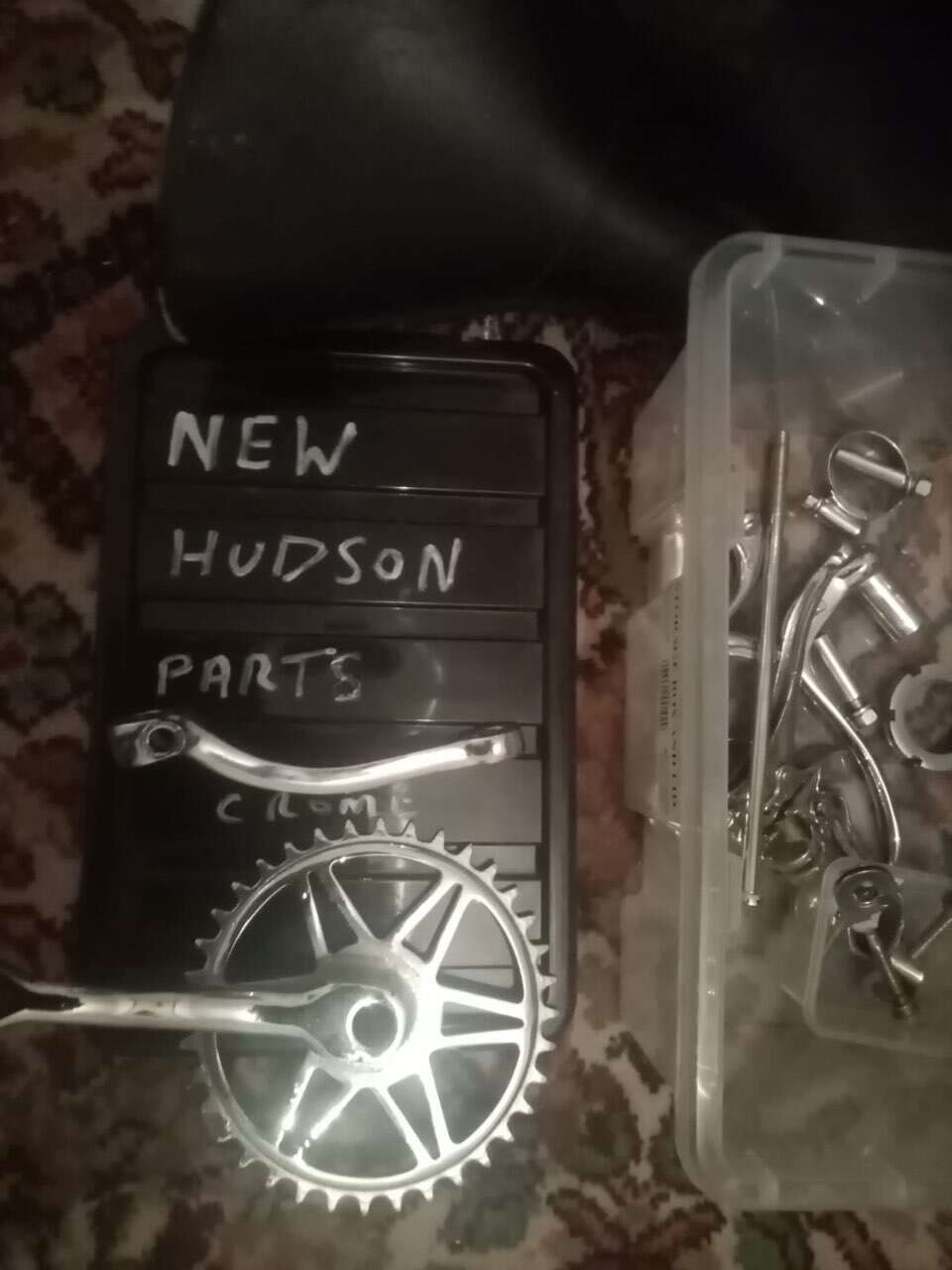

Good news is that most of the hard to find bits are there and I’ve already located/purchased most of the missing bits on eBay. Bad news is no paperwork, and no idea what the registration was, but there is a good visible frame number so hopefully registering it won’t be too much of a chore through the owners club.
The engine turns over and looks pretty decent from what I can see but unfortunately the plug thread in the cylinder head is stripped so I’ll have to find someone to helicoil that.

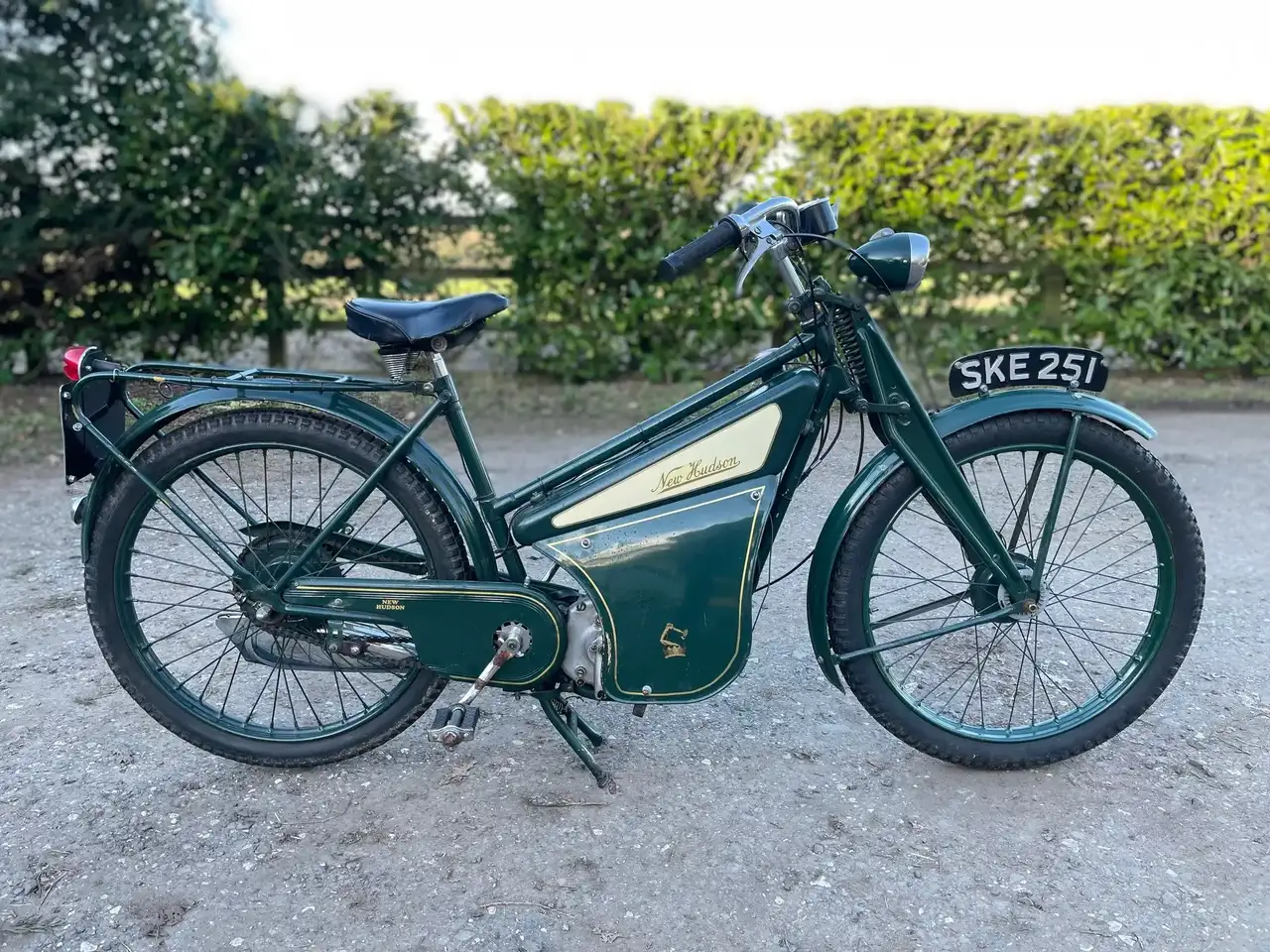

This is what it should look like. It’s about a 1953 model with the Villiers 2F 98cc engine.

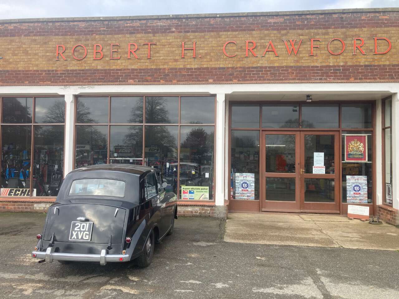

Nothing really to report with the Mayflower, I’ve just been trundling around in it when the weather has been nice. I did adjust the points gap on it and it’s running much better now. It had partially closed up.
Took this picture of it outside the fantastic art deco showroom of Crawfords Agricultural Engineers at Frithville.

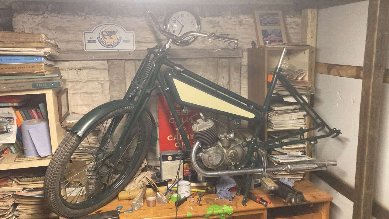

Day off work today so I made a start assembling the Hudson. Got the engine and exhaust on, and the handlebars and levers. Painted the pinstripe on the leg shield and the white on the side of the tank ready for the very expensive transfers to be applied when they arrive.
It’s about 80% complete. Most of the important bits are there and I have managed to source most of the missing bits on eBay. The mudguards are from a different bike, but they’re roughly the right size so just need some extra holes drilling for the mounting brackets.
I think there’s enough thread left in the cylinder head to hold the plug so as the engine looks so good, I’m sure it’ll run if I can get a spark (hopefully just needs the points cleaning) and I need to get the correct plug as the one that came with the bike fouls the tank.
Both tyres have pumped up ok and aren’t actually that bad despite being really old, so they’ll be fine for pootling up and down the driveway on.
The headlight that came with the bike is a correct type but the mounting brackets that came with it are for the other type of light with the side mounting. I’ll have to make a bracket for this one by modifying a pushbike mounting bracket. I mocked it up with cable ties so I could see how it looks.
I think all I need to complete this are the cables (all of them except the throttle) the front brake backplate and both sets of shoes. Plus a myriad of nuts and bolts but I think they’re standard BSF threads which is useful as I’ve got loads of new stuff left over from doing the Hampshire.
The exhaust silencer is completely rotted out but Villiers services sell them new so at least there is something I’ve found I can buy off the shelf.
It does look a bit of a bugger to ride with five levers on the handlebars. Two brake levers, throttle, decompressor and clutch. All are fitted and ready for the cables except the throttle, a nos one is winging its way over here from eBay. I’ve also ordered a nice set of nos handlebar grips for it and a rubber bulb horn.
Anyway- some good progress made today.

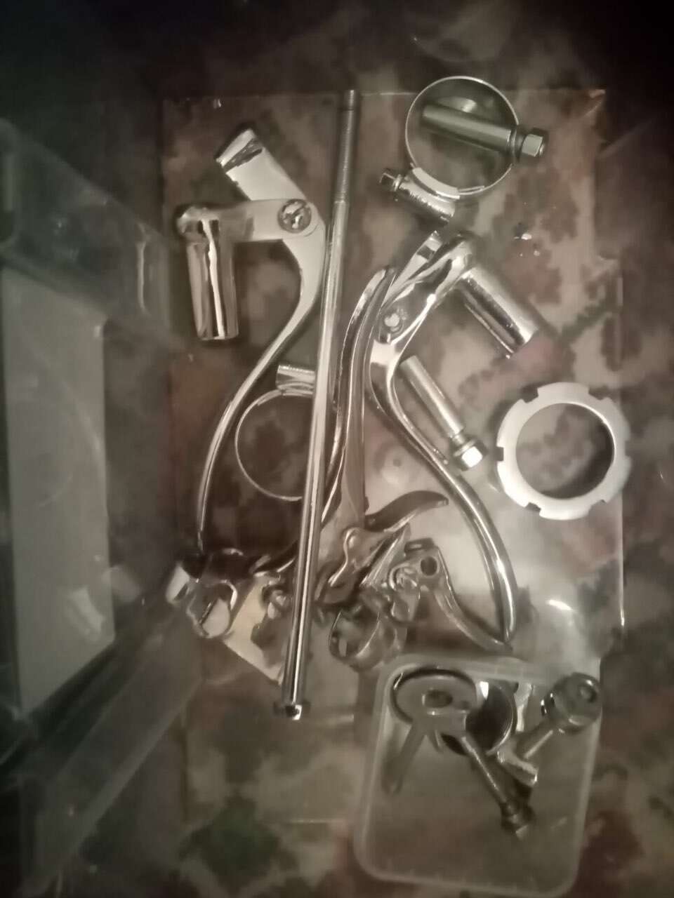

I’ve managed to source most of the missing parts for this now (at a price!) including front and rear brake shoes, cables, chain, wheel bearings and a 1” to 7/8” stepped seat post so I can use one of the two good seats that came with the bike.
All I really need to find is a front brakeplate and lever, to suit 4” brakes,  and a rear wheel spindle. I would absolutely love to fit the rear wheel back on but the spindle is a stumbling point. It’s a 7/16” diameter. 7/16”x26 tpi threads. Does anyone have anything suitable?

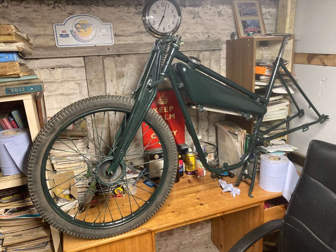

My mate hasn’t done anything with the engine yet apart from deposit it under his workbench. He has, however, made new bushes for the suspension and painted some more bits.
He said the frame was in really good condition, the only rust being on the rear swing arm where it’s getting a bit thin.
He’s hoping to have it back on its wheels within the next couple of weeks or so. He’s fixed the seized brakes and got them working as well.

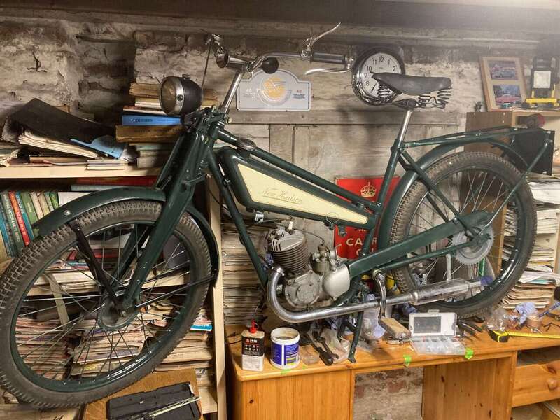

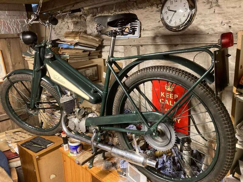

Where did I get to with the Hudson?
I wedged the rear wheel in place and took some photos for the DVLA:
Fitted the nos rear number plate I got from eBay. It was a little too narrow so I made a custom backing plate to bolt to the luggage rack and to hold the rear light.

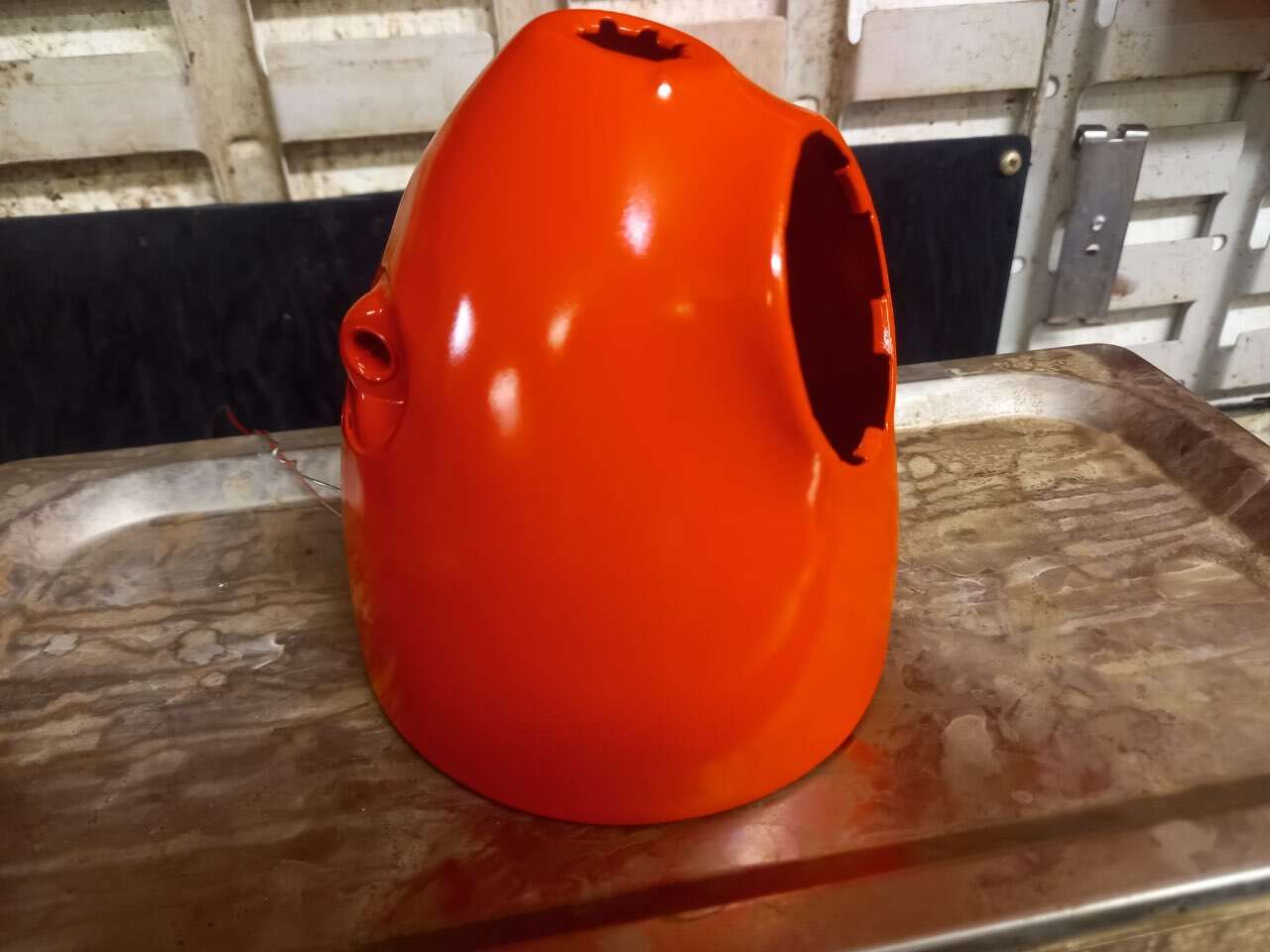

The light was missing, this is an old one I found in my spares, I gave it a good scrub up and it looks perfect. It’s maybe slightly too new but it is a proper moped one and I’ve seen other Hudsons with this one fitted.

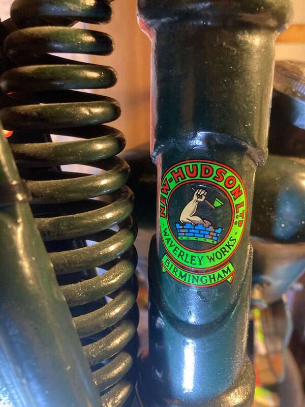

Painted the chain cover and applied the decal.
It’s coming together now. I have sourced a front brake plate from a chap on the Autocycle Facebook page in Canada would you believe. That will be on its way shortly.
I managed to find the correct rear spindle on eBay - it was £30 so an expensive gamble but it looks good and Mopedland in Suffolk has supplied all the cones, nuts and bearings to fit it, as all I had were the brass end caps, nothing else!
I’ve had a fiddle with the electrics to try to get a spark. Set the points gap, it was way too small and the points were unevenly worn. Spun the flywheel and I’m getting a fat spark at the points despite cleaning them. Looks like the condenser has failed so I’m going to order new points and condenser, see if I can get a spark at the plug as I really don’t feel like it’s far off running.

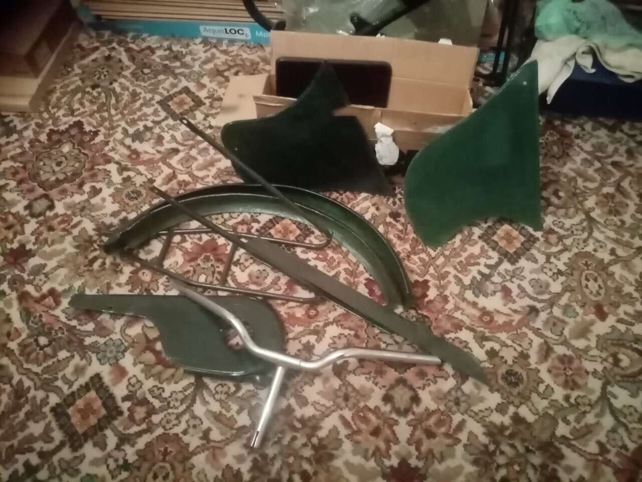

Both mudguards are unfortunately from a different bike and are short. They’re also in poor condition with numerous holes and frilly bits. You can see in the picture above how short the rear one is, it should drop below the number plate by at least 4” or so and I’ve got a period reflector I’d love to fit so that’s a bit annoying. These will do for now but I’ll keep an eye out for the correct ones.
At least it shouldn’t be hard to match the colour my mate painted it with- I asked him what shade it is and he said it was hammerite!
