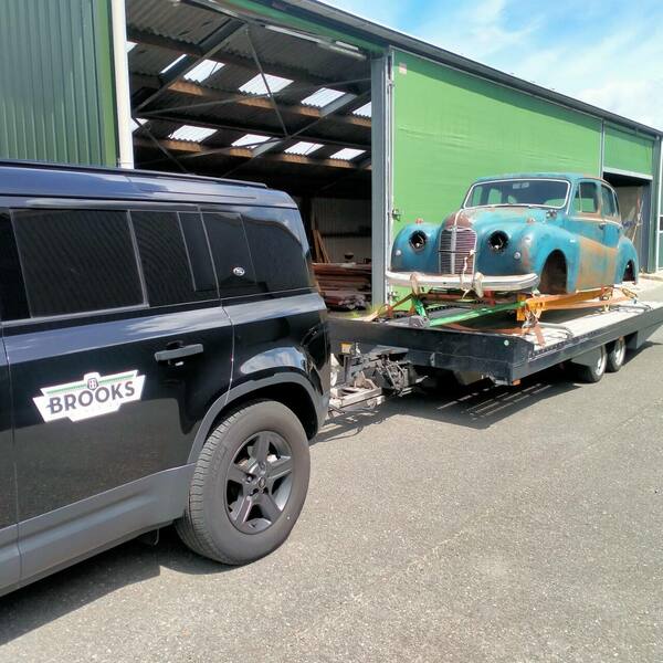

After being dicked about and offered crazy “don’t want the job” prices by various transport companies I decided to bite the bullet and go over to Holland myself and fetch the replacement bodyshell.
So, I’ve booked the ferry from Harwich to Hook of Holland leaving Monday 5th Sept and returning on the 7th. I’ve booked a decent trailer and borrowing my parents 4x4 for the trip. More on that later.
I did, in the meantime, look for a replacement chassis. This proved elusive. I was quickly offered a decent Hereford chassis but the wheelbase is 3” longer so the mountings for the rear axle were in a different place. I decided I didn’t want to get involved in that so I thought fuck it, I’ll just weld up the original. In comparison to repairing the rotten body, it’s child’s play.

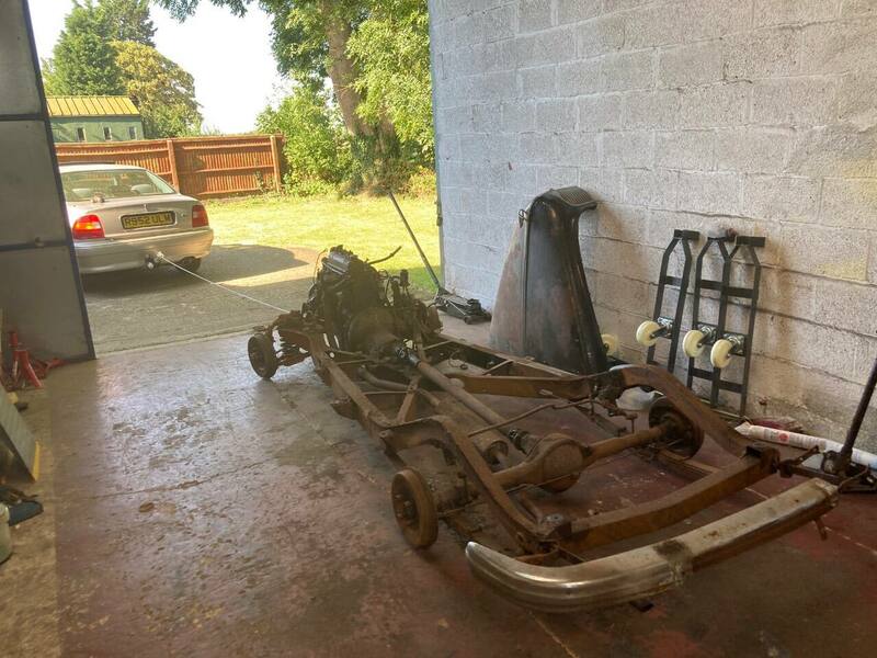

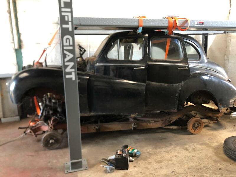

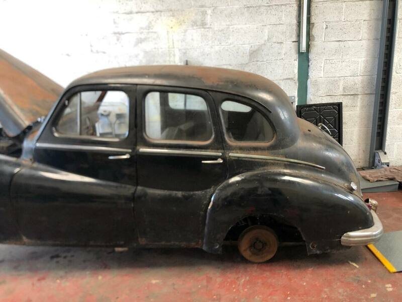

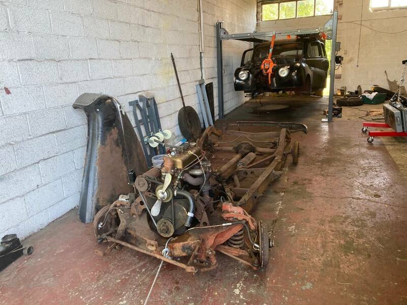

The first thing to do was to remove the old rotten body. I spent the best part of a day removing the 12 body mounting bolts, some of which go into captive nuts in the chassis and I really did not want these to shear off, some of which are nuts and bolts but there isn’t a lot of room to get the angle grinder in there to cut them off. Amazingly, I managed to get some of them, including all the ones in captives, out intact with heat and gentle persuasion. A few things under the bonnet had to be disconnected, from memory there’s the choke and throttle cables, heater hoses, wiring to the coil, starter and dynamo, and the earth lead.
I also had to remove the steering box, which involved removing the trafficator/horn assembly, the steering wheel (which put up quite a fight to get it off the splines) and the column gear lever and rod linkage.

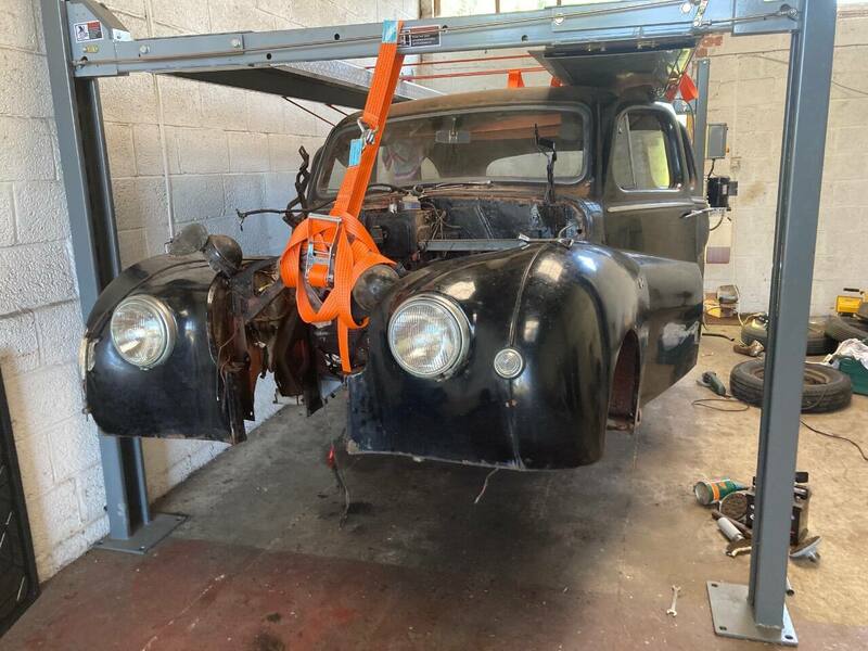

Ideally, to lift a body off a chassis you need a two post lift, which you can put under the sills and lift it straight off. Unfortunately, I have a four post lift, which is great for most things but not much good for lifting bodies off chassis. After some thought I decided a good way to do it was to buy four strong ratchet straps (rated for 5000kg) ratchet strap the roof to the ramp and lift it off that way. I had a measure up and figured that if the car was sitting on its drums I might just have enough lift to be able to drag the chassis out from under it, but it still looked tight.
The ratchet straps arrived from eBay with big warning labels on them “DO NOT USE FOR LIFTING”. Well a body weighing 800kg maximum should be alright spread between four of them, surely? They only put these warnings to cover themselves anyway.
I decided to give it a go. With cushions and towels to protect the straps, I managed to lift the body off the chassis and only forgot to disconnect two wires, which isn’t bad really.
It was bloody close though. I ended up cutting the bottom off the rad support bracket and cutting out a section of the drivers floor under the pedals to get it to clear. In hindsight I should have removed the bracket, disconnected the master cylinder pushrod and tied down the clutch and brake pedals then it would have cleared.

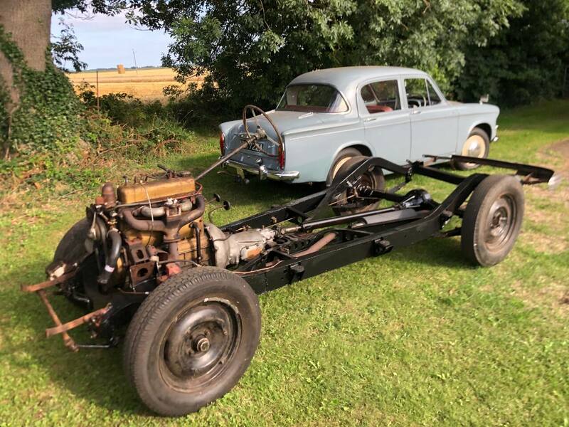

In the end I dragged the chassis out from under the body with my Rover 600, a good test for its new towbar.
Unsurprisingly, the original body was so rotten it distorted badly on the side I hadn’t done any repairs on, good job it’s scrap! The roof looks ok, but the doors don’t shut anymore. The other side I started welding up escaped injury.
Can I repair the original chassis? STAY TUNED for more exciting updates!

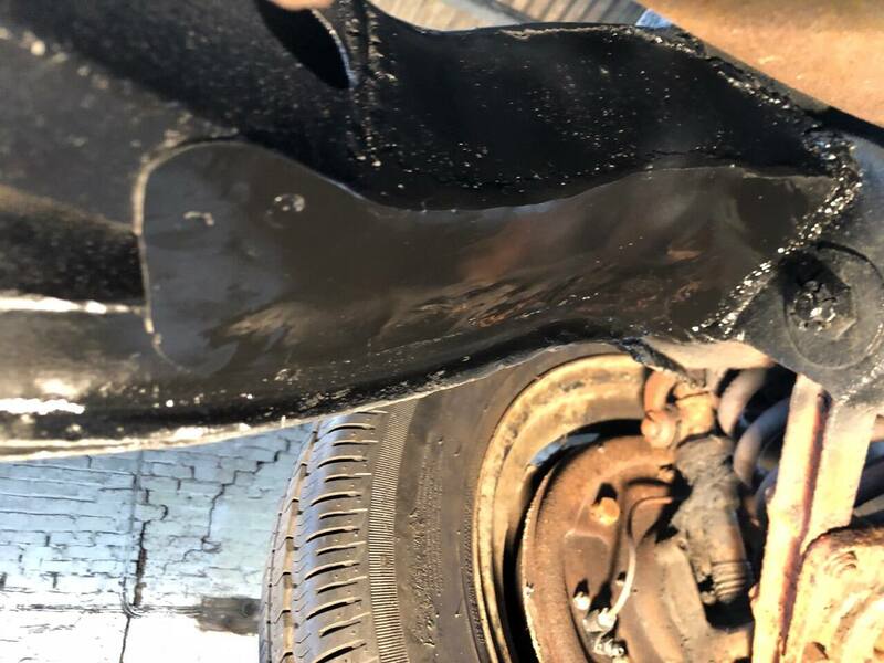

I put the wheels back on the chassis and pushed it back onto the ramp.

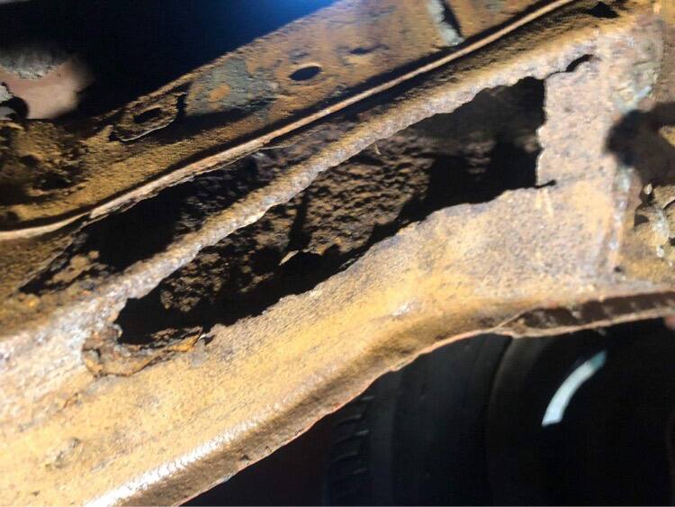

There was a particularly ropey bit of chassis by the front suspension on the passenger side. It had gone all the way through into the centre structure of the chassis, but fortunately the outer bit by the wheel and the top were both in good condition, so I had plenty to weld to.
The hardest part was cutting the rust out, it was very difficult to get the grinder in there. I spent a considerable amount of time cutting back to good metal, before cleaning up and spraying weld-thru primer in there.
This is what I was dealing with.

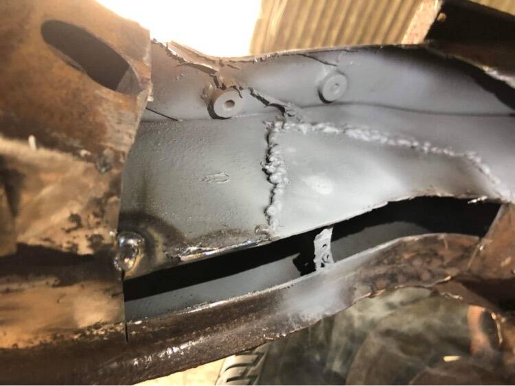

And once it was cut back:
Strangely, the other side in the same place was solid with no issues!

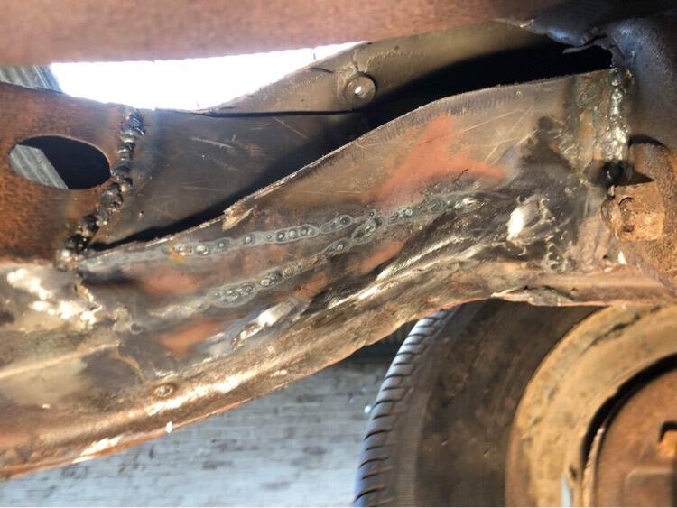

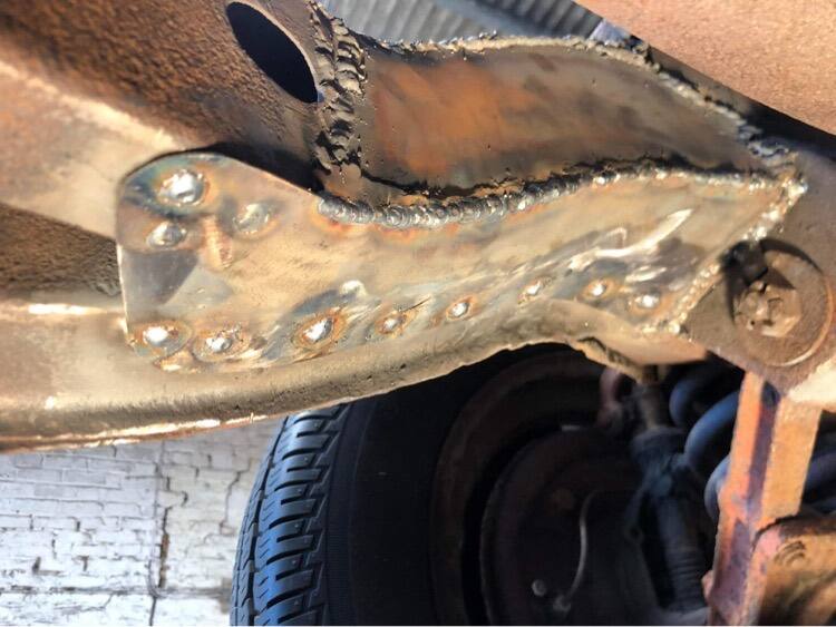

Using a similar gauge steel to the original, I started to piece it back together, trying to replicate the original design as close as possible. Had the welder cranked up to maximum power to get good penetration on those welds! Even though the access was a bit shit, in hindsight I should have removed the engine.
I was quite pleased with that repair, but it was certainly one of the most challenging and time consuming repairs I’ve ever tackled. Once that was out of the way, the other repairs were easy, three patches and a 12” section of chassis rail, which I’d already done with the body on.

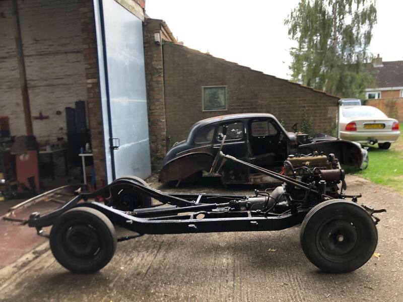

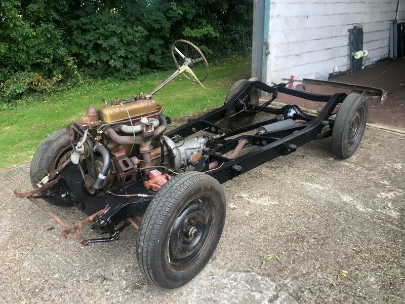

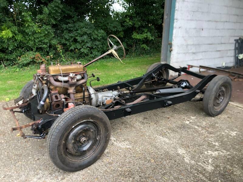

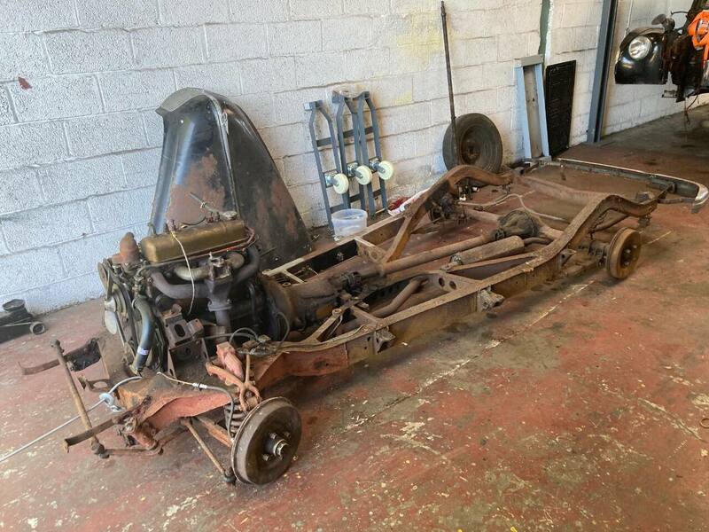

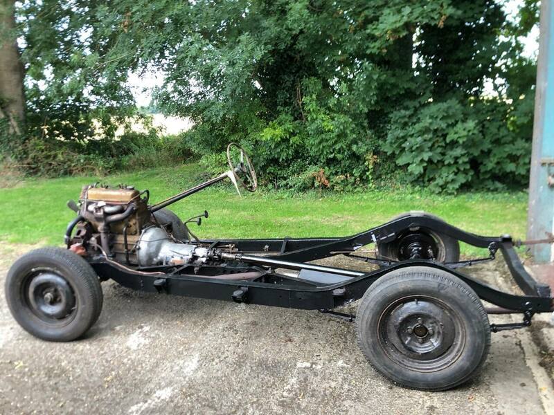

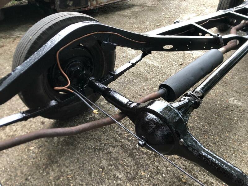

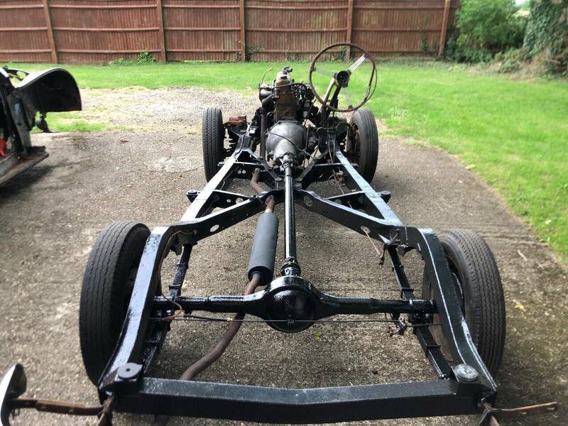

Having completed the welding on the chassis, I then started cleaning it up.
Spent several days scraping oil off the drivetrain and chassis, degreasing, wire brushing and going over the entire chassis with a rotary wire brush to clean it all up. I then gave it a coat of Hydrate 80 rust converter, and a couple of coats of chassis paint. I did the same on the rear axle, springs and brake backplates.

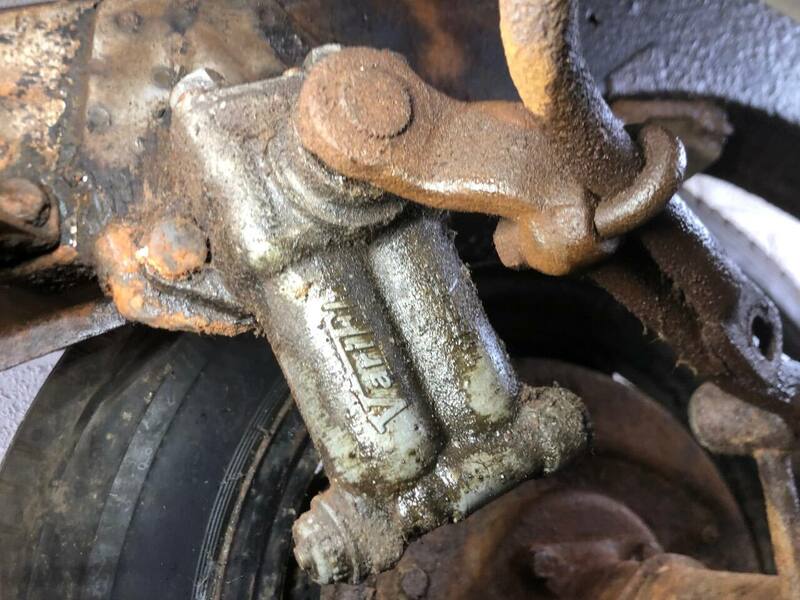

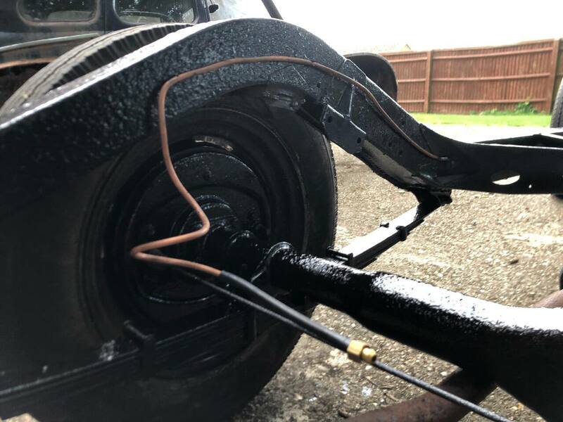

I removed the rear shock absorbers because they were both leaking and one I think had run out completely because the arms were in different positions and it was twisting the antiroll bar. They turned out to be not the usual Armstrong lever arms, but branded Vari-flo. A bit of Googling tells me that they were an early form of aftermarket adjustable shock absorber, sold by Spax circa 1960/61 and probably ultra rare nowadays. I have a friend who used to rebuild lever arms for a living, he has never seen any of these before. He has offered to rebuild them for me and doesn’t think they’ll be a problem to do as long as he can find seals to go in them, but he’s snowed under with work at the moment and has asked me to leave it a few weeks, which is fair enough, I’m not in a mega hurry.
The fuel line was completely rotten, so I made a new one using the old one as a pattern, some 1/4” brake pipe and managed to buy the original soldered type connectors from the local agricultural supplier who use them on vintage tractors.

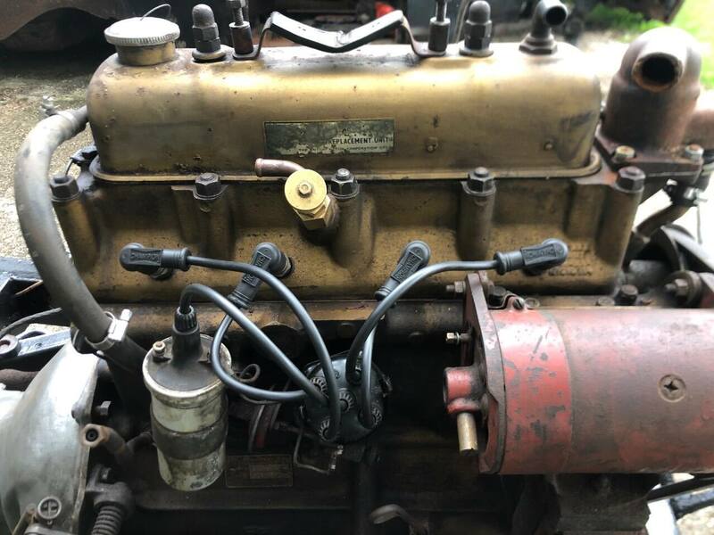

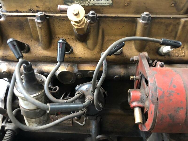

I thought briefly about painting the engine but I thought it would look out of place with the patinated body, and anyway it cleaned up fairly well once I’d removed the years of oil from the sides. I’ve replaced the rocker cover, side and sump gaskets so it should be fairly oil tight (as much as an old British engine can be) we’ll see once it’s back on the road but so far I’ve had it running since replacing those gaskets and i haven’t noticed any leaks.
A small but satisfying job I did was making a new set of Ht leads. I think two were original and two had been replaced as the plug caps didn’t match, two had the original Bakelite caps but one was broken. The leads themselves were very perished. I bought some new rubber type Champion caps and copper cored Ht lead and made my own using the old ones as patterns.

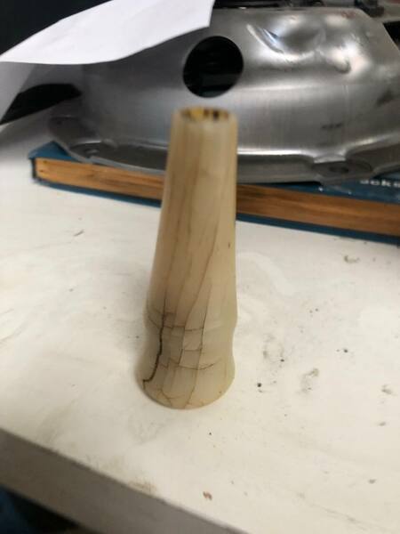

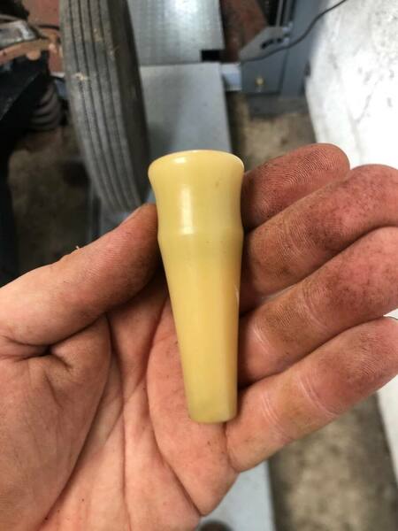

While the Atlantic had a nice cream steering wheel rim which matched the gearknob, switches, and dash plastics, I think Austin thought it too ostentatious for the markets the Hampshire was aimed at, so they fitted a brown steering wheel with brown centre and a brown gear lever. Very conservative but I’ve always thought it would look so much better with:
Ivory rim to match the gearknob and dash plastics
Gold centre, and gear-lever, to match the instruments.
The steering wheel company are going to try to match the ivory colour of the original gearknob as close as possible. I’ve sent them the knob as well and they are going to cast me a new one, they were asked to do one for an Atlantic a couple of years ago and still have the mould they made for it.

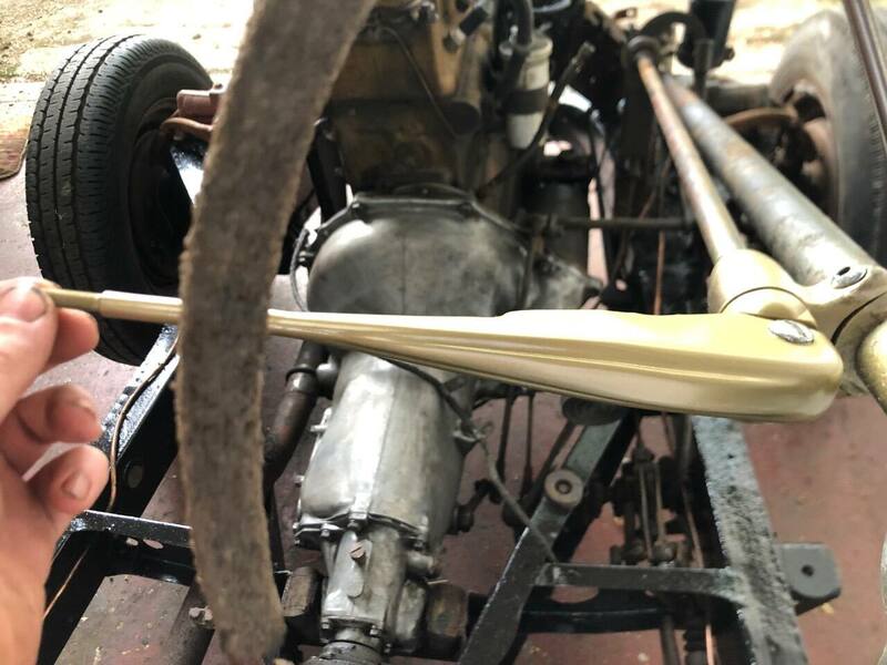

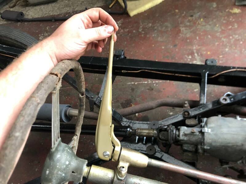

I’ve already stripped and painted the gear lever, I spent some time in the Range looking at the different gold paints they had on offer and trying to match the colour of the instruments. Ford Solar Gold was what I went with in the end, I still need to lacquer it but it came out ok.

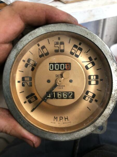

The original speedo is completely seized up, nothing works on it, but I managed to buy this replacement, again from Graham, which works perfectly. My dad made a tool for testing speedos in an electric drill and this one doesn’t even stick, and the trip meter works and resets ok.

Great to see some solid progress, so good that you've finally hatched a plan to get the body from the Dutch car.
11/10 for lifting the body off with ratchet straps attached.
Do you intend to fit the 'new' body using the same method?
I'm not sure I would!
I’m going to try. I think if I remove the rad support bracket and tie the pedals down it should be ok. The replacement has far more structural integrity than the one I’ve just lifted off which had no floor or sills left.
The lifting by the roof method was how Austin fitted the bodies in the factory. As long as it’s structurally sound, there’s nothing to fear. The new body was removed from the chassis using a four post lift, two massive axle stands and a scaffold pole through the front door apertures. Unfortunately he squashed the door trims while doing so. But there’s no other problems and all four doors still shut nicely. Apparently!
When I did it I had straps at five contact points on the body, so the load was spread more evenly.
