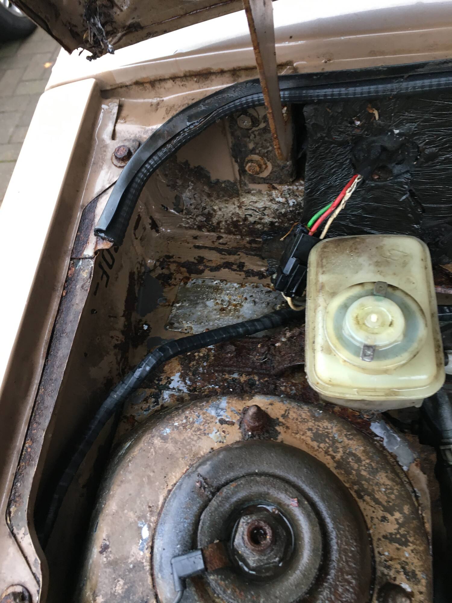

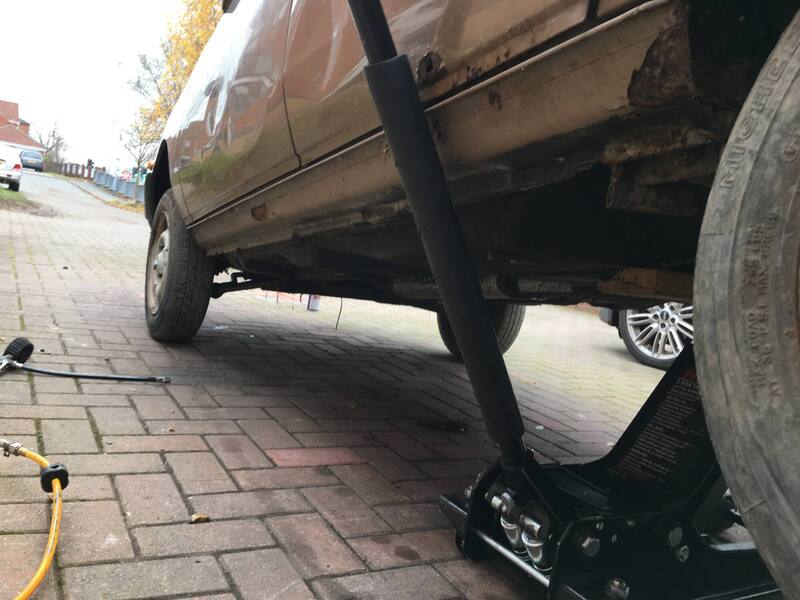

Lankytim Posted November 22, 2019 Author Posted November 22, 2019 I've had a brief play with this VISA. First of all, I found the keys in the ash tray, what a result! I wasn't looking forward to replacing the locks or paying for a replacement set of keys. Two of the doors wouldn't close as the catch mechanisms had seized up, after removal, cleaning and lubrication they slowly came back to life. No nasty surprises so far when it comes to the bodywork- The shell appears not to need any welding apart from a very small piece on the leading edge of the passenger sill which may/may not survive a screwdriver test, the worst area is perhaps the bulkhead where the spare wheel sits and even that isn't too bad. The only panels which deffo need repair or preferably replacement are both the rear doors which are rotten at the bottom edge. The VISA came with a very dead battery. After finding a good one I found all the electrical systems were dead, a small multi plug was disconnected under the bonnet and with that plugged back in we suddenly had lights, wiper and even a radio! The engine was fortunately not seized and after checking the oil I found it would turn over quite happily on the starter. A split fuel pipe prevented it running but it will briefly run with petrol poured down the carb, the clutch also works fine. I feel very lucky at this stage as I had convinced myself the engine was seized and would need replacement, fingers crossed it won't need any major surgery at all. I'm building up a short shopping list of parts needed to get this on the road, so far I'm going to need.... A set of tyres, maybe with wheels too as one or two of the rims are very rusty and may not be usable, A pair of headlights, the existing headlights have lost all their mirrored finish and the glass has fallen off one of them. If there's a way or replacing the mirrored finish I could repair them but I suspect replacement is going to be the most straightforward option. A pair of rear doors, the ones I have are pretty crunchy and although they might repair, I think replacement is going to be easier. The car is still absolutely covered with shite and tree debris, especially under the bonnet. I may A frame the thing to the local jet wash and spend a tenner on giving it a good scrub down. shedenvy, HillmanImp, richardmorris and 29 others 32

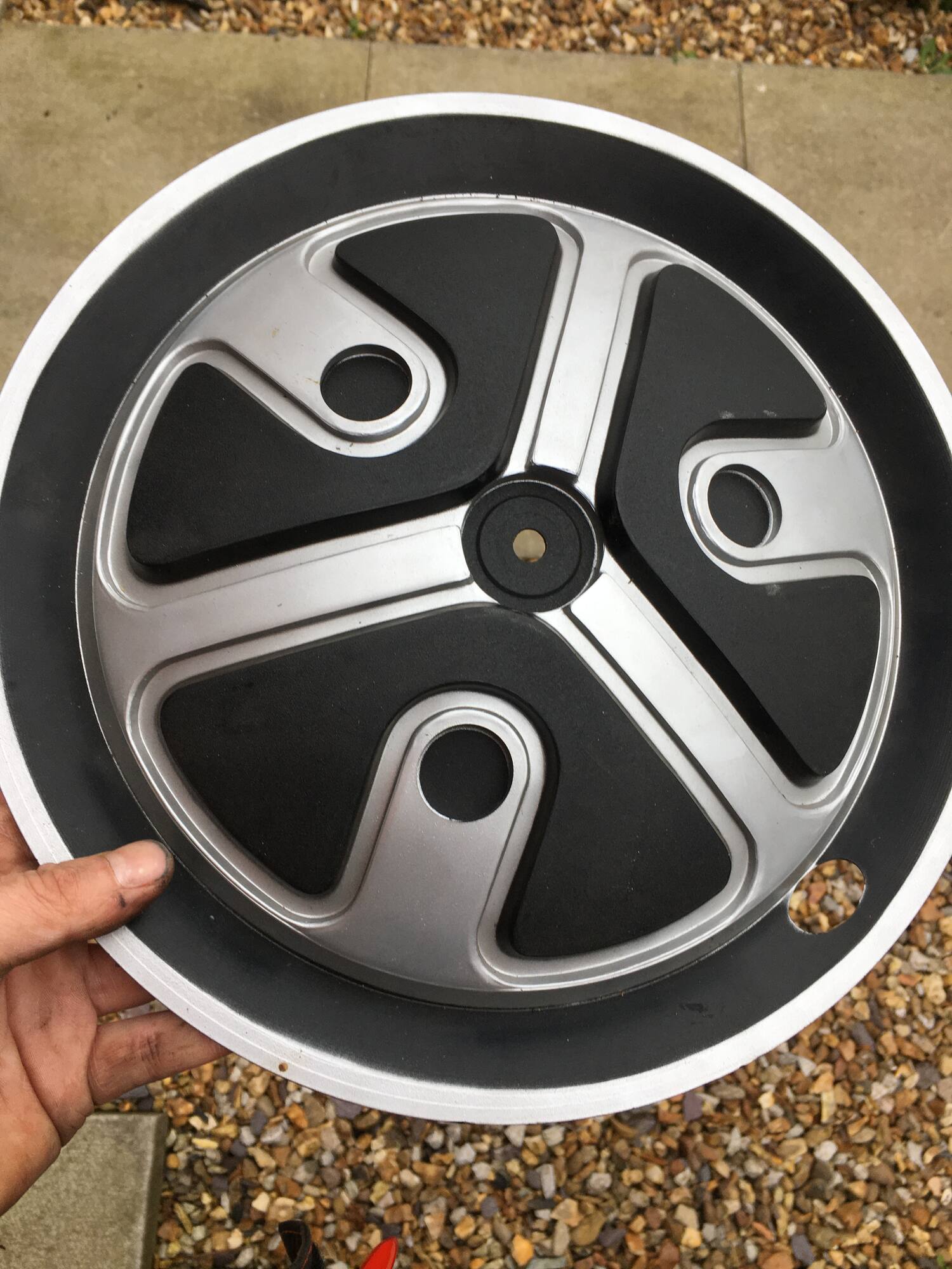

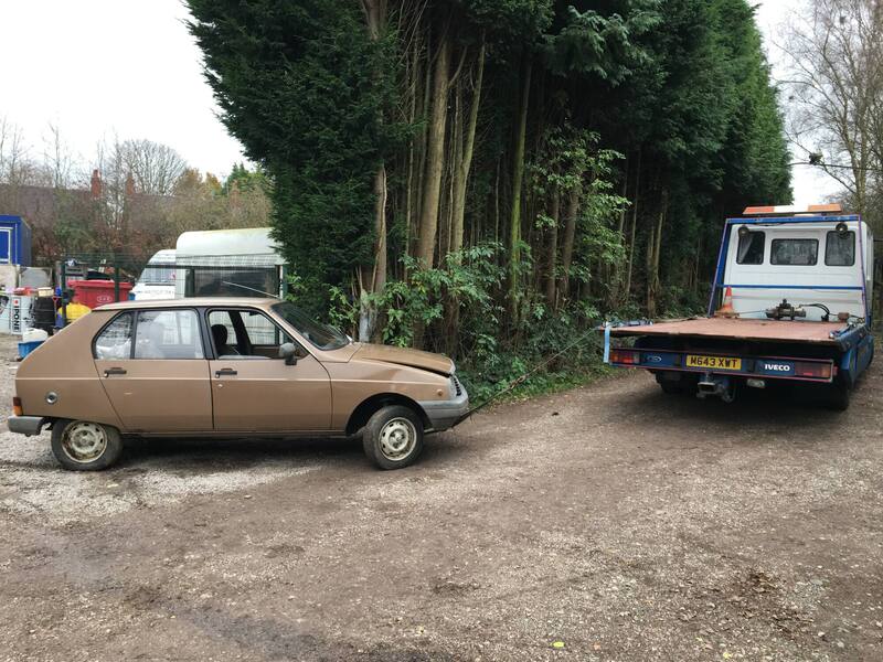

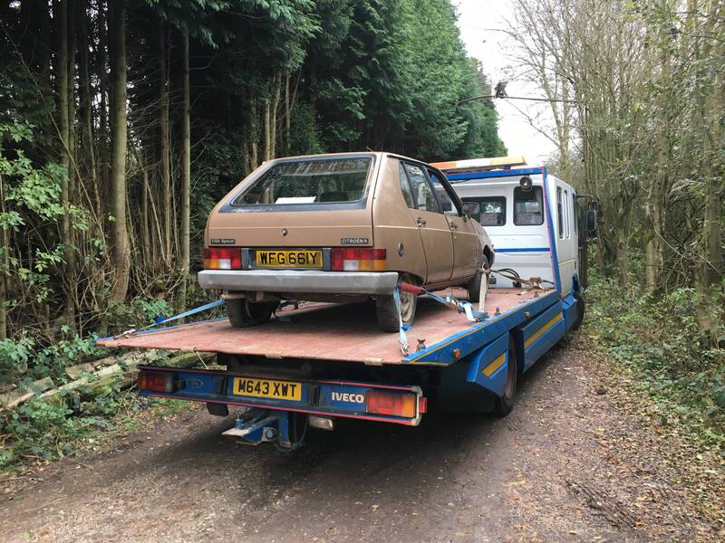

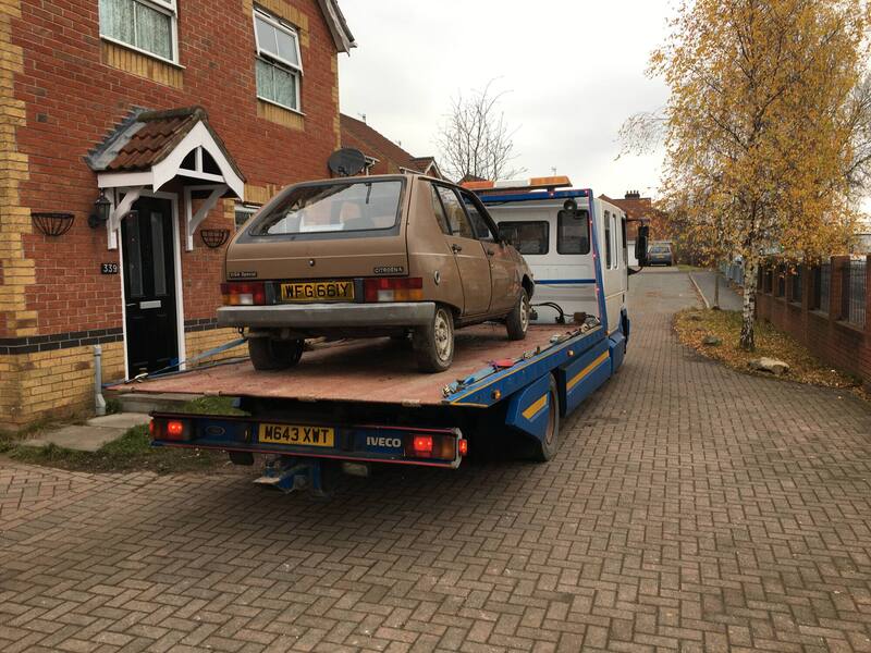

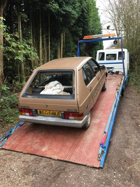

Lankytim Posted November 22, 2019 Author Posted November 22, 2019 I’ve heard people having good results by sticking bacofoil onto headlight reflectors to make them shiny again. perhaps worth a try. A couple of the rims are so corroded the valves are in danger of popping out. I think they’re beyond help realistically. I forgot to add the photos of it coming home, I didn’t A frame it in the end, the guy had just bought a Eurocargo recovery truck and was dying to test it out, he delivered it the couple of miles back home for free! Top fella. The boot contained a big box of spares, mostly brake parts and filters which will come in very handy, included was a spare NEW hubcap. I’m tempted to replace all the hubcaps for chrome items as I prefer the look of those, I’m not sure on the availability of them though. theshadow, greengartside, Coprolalia and 29 others 32

Tadhg Tiogar Posted November 22, 2019 Posted November 22, 2019 I think you should use those wheeltrims - they remind me of shite Rostyles. Stinkwheel, Sudsprint and LightBulbFun 3

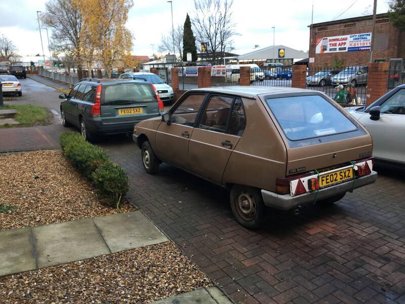

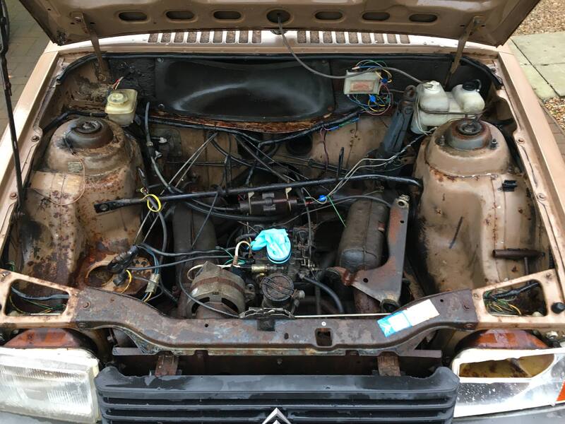

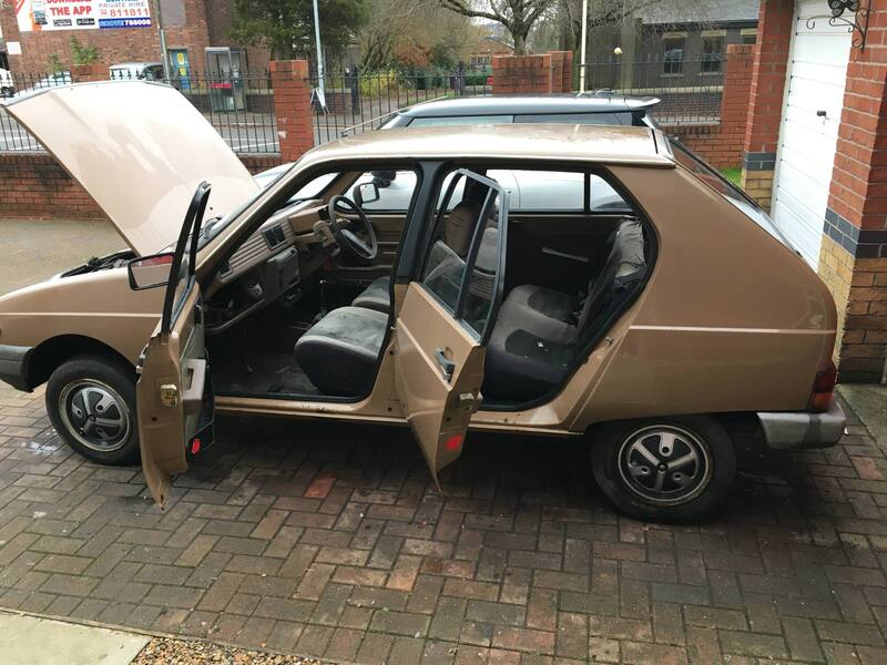

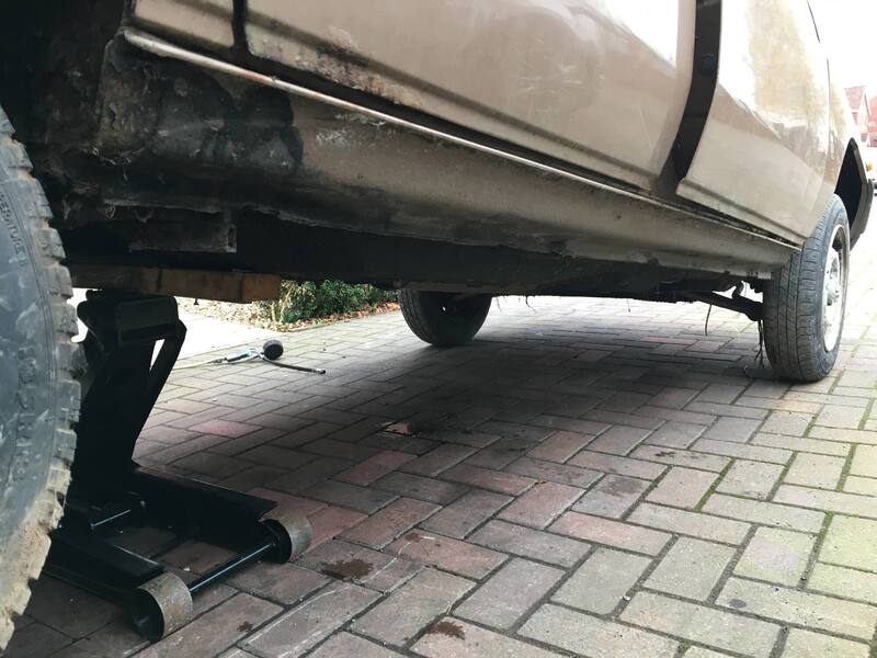

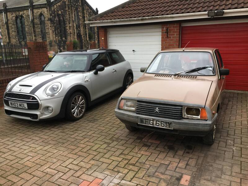

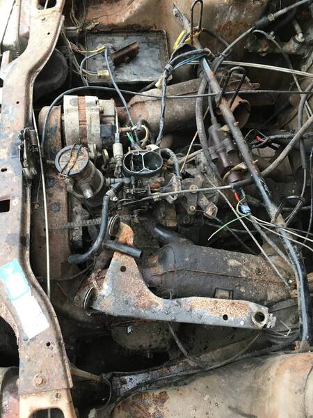

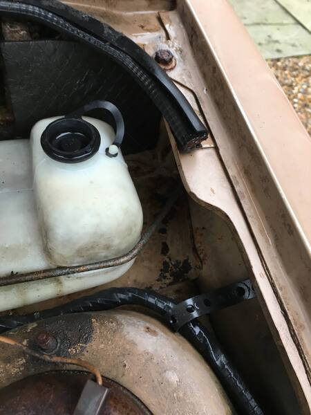

Lankytim Posted November 22, 2019 Author Posted November 22, 2019 3 minutes ago, bezzabsa said: Video please when you jet wash...love a good jet wash vid!!! Sorry, I didn’t take a vid but I did take a photo! its looking much better, the door shuts have all had a nice wipe down but the whole lot is begging for a cut and polish. I did find a little rot though, the inner wing below the drivers side headlight will need a patch but nothing too drastic. the inner wings near the bulkhead were covered in damp mulch which was jetted away quite nicely. The areas appear totally solid but the VIN plate has corrosion and I’m not sure I’ll be able to read the VIN number to get a new V5c! Mrs6C, Jimbob McGregor, GrumpiusMaximus and 30 others 33

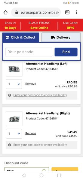

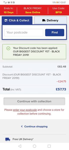

Spurious Posted November 22, 2019 Posted November 22, 2019 EuroCarParts have a decent discount on this week. Two C15 headlights for £58 Sudsprint, Bamboocarman, Dick Cheeseburger and 2 others 5
jonathan_dyane Posted November 22, 2019 Posted November 22, 2019 It’s come up remarkably well! The VIN should also be stamped on the inner wing under the bonnet shut. Alas AX wheels are different.

ETCHY Posted November 23, 2019 Posted November 23, 2019 19 hours ago, Tadhg Tiogar said: I think you should use those wheeltrims - they remind me of shite Rostyles. Yeah I like them too they're cool.

nigel bickle Posted November 23, 2019 Posted November 23, 2019 How did you reverse. A frame that into the wash? Bet that was fun! loserone 1
bezzabsa Posted November 23, 2019 Posted November 23, 2019 Another vote for those wheel trims.... also try a bit of T cut on the VIN - IF its stamped....if it isnt disregard that!!
Matts_Rusty_Bus Posted November 23, 2019 Posted November 23, 2019 Also if you drill out the rivets on the vin you could be able to read the numbers from the back** dependant on it being stampedSent from my SM-A520F using Tapatalk 500tops 1

Lankytim Posted November 23, 2019 Author Posted November 23, 2019 4 hours ago, nigel bickle said: How did you reverse. A frame that into the wash? Bet that was fun! It went in OK, if you stay more or less in a straight line I find you can reverse A framed vehicles reasonably well. I often reverse the A down our long shared driveway. Some cars simply refuse to be reversed and immediately go to full lock which can be annoying. nigel bickle 1
