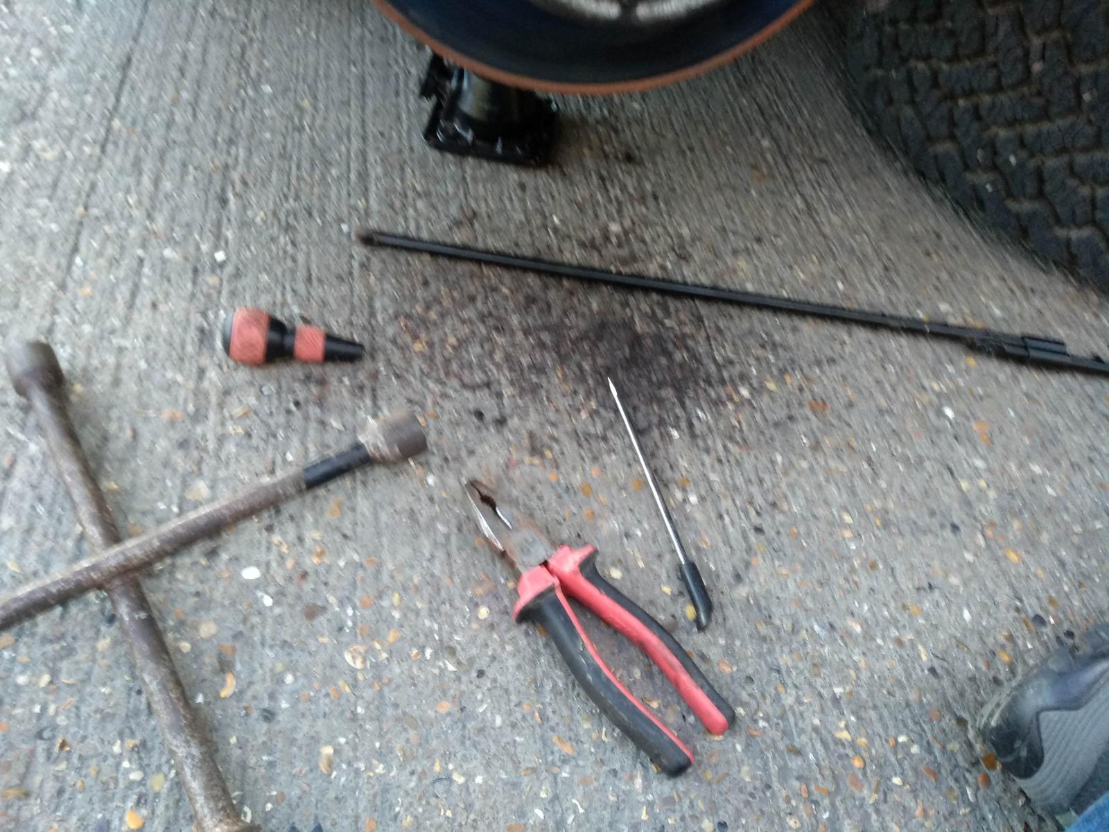

Now at Tunbridge Wells services and nsf brake binding I think, well, nsf wheel is hot to touch and others aren't.
Indeed
The wheel was hot to touch and after 15 mins the disc was still too hot to go near, it might be a little glazed now.
Calliper bolts loosened, levered apart a little, wacked a few times, and now it moves ... one casualty, the screwdriver.

Cheers Jim, it was a good job I took a wheel brace with me as despite there being a jack there was no brace to remove the wheel nuts.

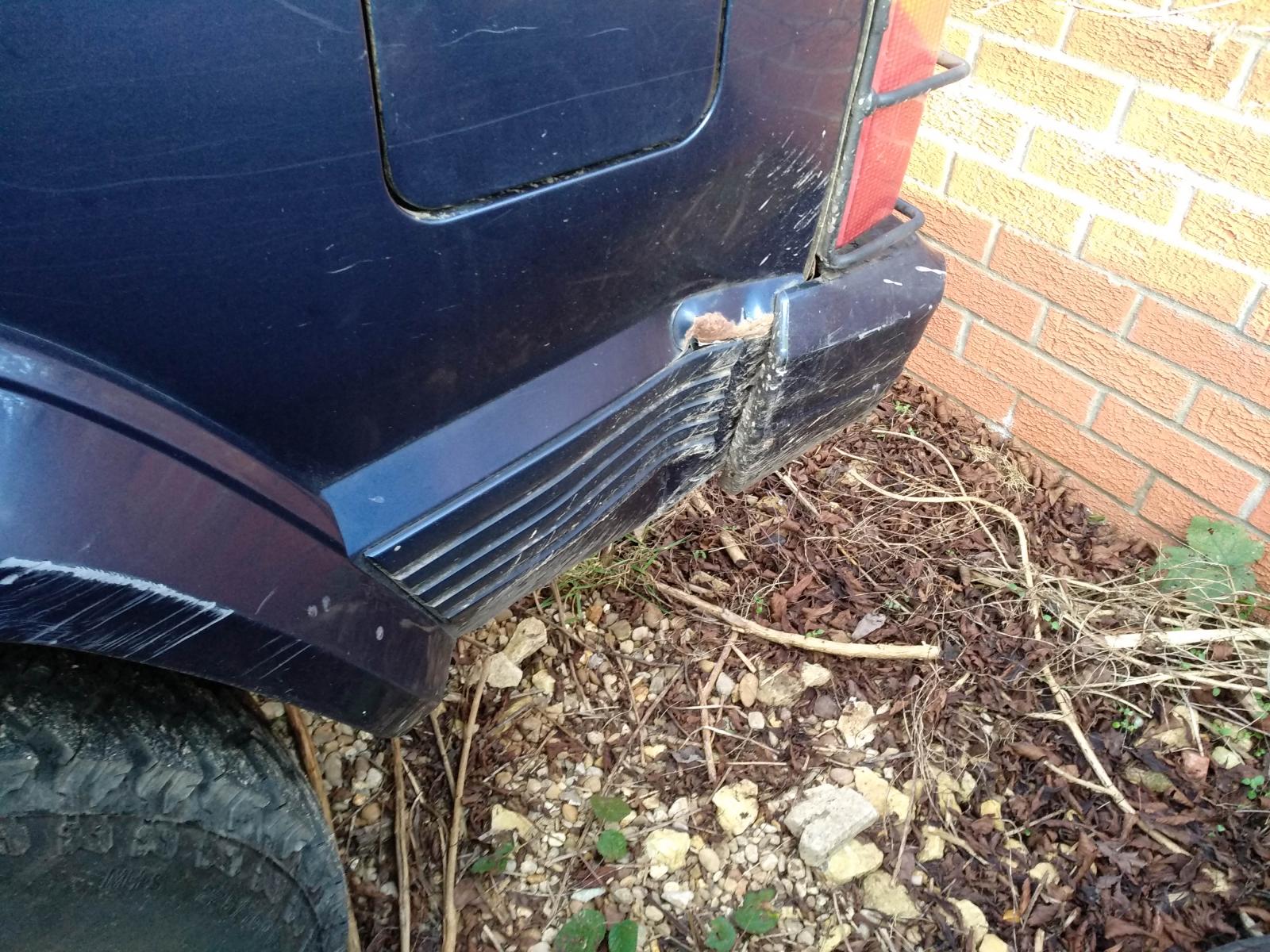

There are many dents and scuffs, this is one of them:

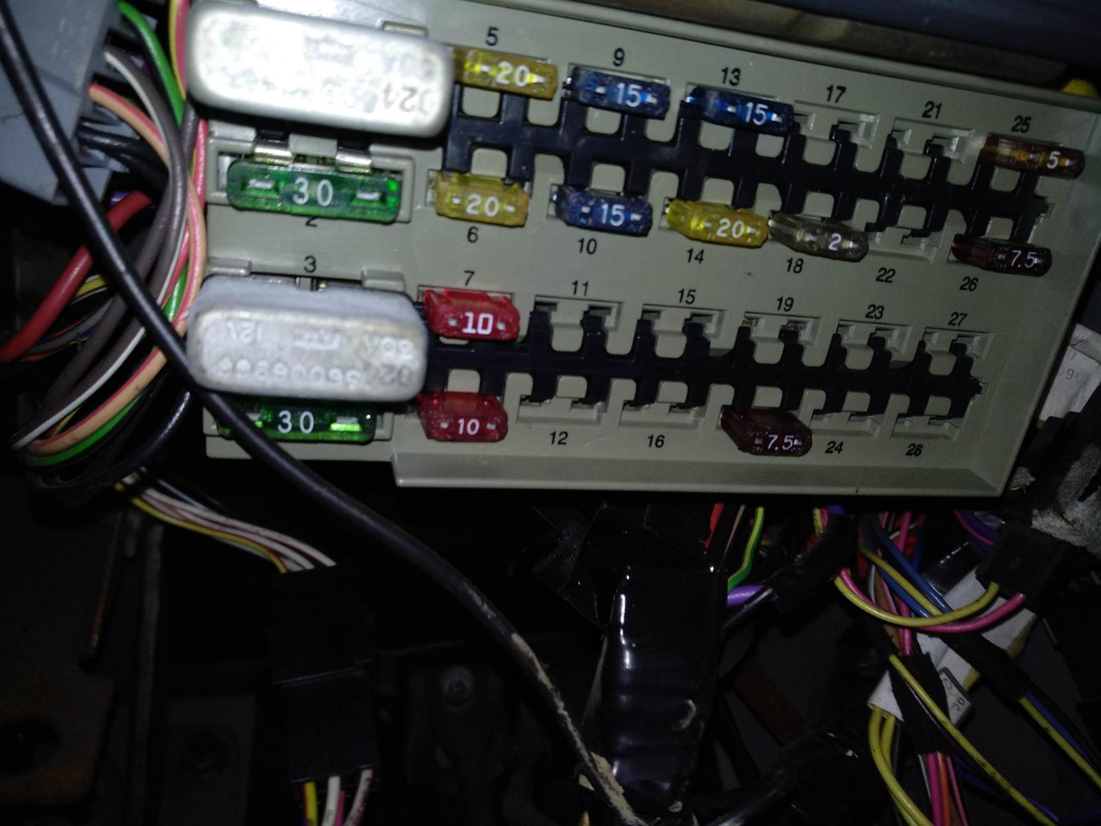

Top left, bottom to top, 1-4 should be 30 amp circuit breakers, 2 & 4 have been replaced with fuses.
1. Power locks, seats - not working
2, Heated rear window -untested
3. Power windows - working
4. Heater blower - working
Time to play musical fuses and see if I can get the seats working.
… update, I swapped circuit breaker 1 & 3 around and windows still worked and seats didn't, so the issue is elsewhere :(
