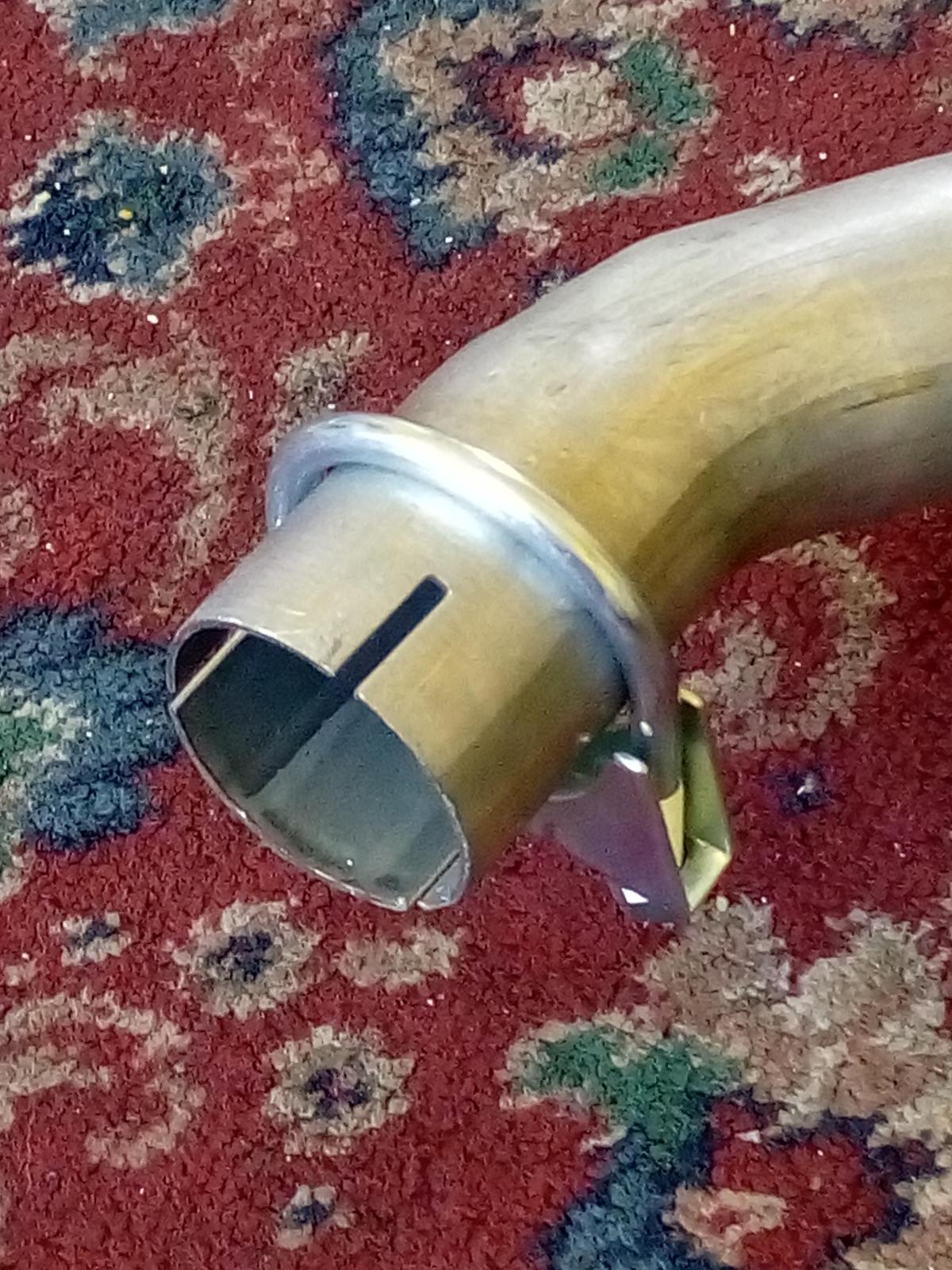

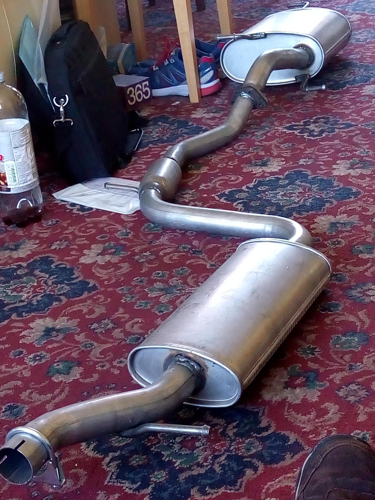

Never fitted an exhaust before so please bear with me...
I've bought a two piece exhaust system cheap from ebay.
The back box connects to the long middle section with a metal gasket between two flanges held in place with three bolts. Pretty sure I can sort that.
The front section seems to be friction fitted to the cat pipe and then just clamped into place using a u bracket?
As far as I can tell I just need to separate the cat/front pipe join then pop off all the hangers and the rusty old exhaust should just fall to the ground?
I've got ramps, a couple of axle stands, new hangers/gaskets/nuts and bolts.
What are the odds of me and my Halfords 'Your toddlers first toolkit' being able to complete this job without any major fuckups?
All advice/tips/warnings gratefully received.

Fitting the new one is usually easy, getting the old rusty one off the car is the pain.

I've never managed to source exhaust parts any cheaper than just getting them fitted. You'll soon find how much rust in your eye makes fitting worth every penny.

Rarely does swapping parts of exhausts work well. Cut it off into sections with the grinder, probably need new hangers as well. Forget undoing unions as well, they'll be rusted to fuck. Reckon on the exhaust being surprisingly hefty when you are working on your back as well.
Preassemble it before make sure it all fits, then take apart again and assemble front to back on the car, likely need some assembly paste, forget Gun Gum unless its this new formula they've made up, I use sikaflex for bits that won't seal.
Get ready for a shitty day and a sore neck if you are doing it on the driveway. Good luck.
This will be no help to you at all but here we go.
I replaced the Reliant one with some cheap ebay thing. It was a nightmare to get the old one off. The rubber hanger bolts to ages to get off. I was working on the car for hours on axle stands and felt sick.
I fitted it, it blew. Mate sorted it and asked why i not asked him to chuck it on for me. I then went back to collect the old exhaust and take it to the tip and reversed the Kia into the side of the house. Nice mark on the bumper that still there now.
Verdict - wish i had not bothered.
As has been said above. Fitting an exhaust isn't hard but it's a twat to get the old one off then ages laying on your back messing with the new one.
Get someone with a ramp to do it. It'll be done in a quarter of the time and save you getting pissed off.

Before you've taken the old exhaust off get under the car compare it to the new one to make sure it's the same for length, bends and hangers.
Loose fit on the car first, when happy with the fit add all the sticky stuff and tighten.
I used a couple of car jacks (screwed pieces of wood on top so exhaust didn't slip off) along the length for support, easily adjustable.

fitting it easy
getting the old one off may well need cutting disc /hack saw /grinder /hammer and chisel
