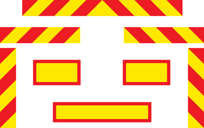

riek Posted March 22, 2018 Posted March 22, 2018 When did lorries stop wearing 'long vehicle' signs on the back?

Eddie Honda Posted March 23, 2018 Posted March 23, 2018 When did lorries stop wearing 'long vehicle' signs on the back? Motor vehicles over 13m first used on or after 1st April 1996 Trailers over 13m manufactured on or after 1st October 1995 http://www.legislation.gov.uk/uksi/1994/2280/schedule/2/made "Old" ones "New" ones with empty boxes = same meaning. Those are the obligatory markings, extra non-obligatory old-school "LONG VEHICLE" signs may be added on. riek, SiC and egg 3
riek Posted March 23, 2018 Posted March 23, 2018 Cheers! That explains why they're such a distinct childhood thing for me - I'd have been about 13 when they started to go
