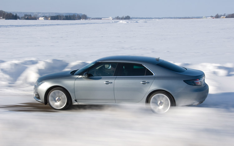

Why are these still worth money? I like the look of them and thought they would be worthless after a few years when Saab went down the pan, but they are still way out of reach.
