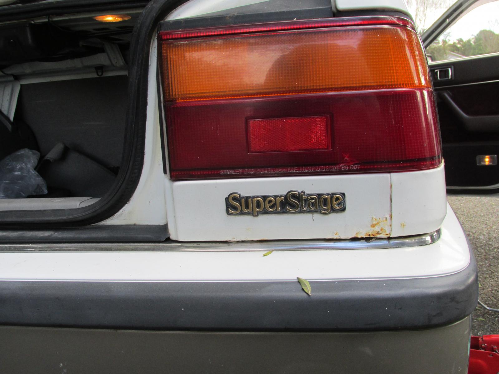

STUNO Posted August 22, 2016 Posted August 22, 2016 I've got a couple of timing belts to potentially change in the near future. One on a 1.8 mk4 Astra (I know this one should also have the water pump changed) and one on a 2.0 V6 Rover 75. I've done belts before on a Renault Avantime V6, Volvo 740 and Lancia Y10 but I had two fully working hands and arms at the time. Is there anything I need to know about these two belt changes before I crack into them with none of the right tools and a left hand that doesn't move very well and has almost no strength? You also have some explaining to do, Astra and Rover need work The one armed mechanic who worked on this seemed ok at the job. note the upmarket GOLD lettering. Classy as Panhards gold lady. Lacquer Peel and philibusmo 2
