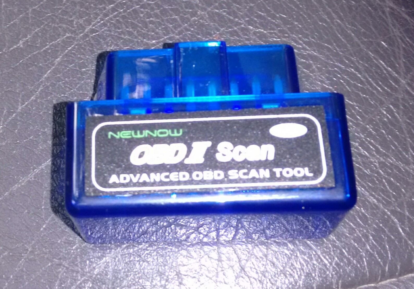

The Moog Posted June 12, 2015 Posted June 12, 2015 How do I get this to connect to torque? It pairs with blue tooth but then torque can't find it. Is it just a duff one?

robinmasters Posted June 13, 2015 Posted June 13, 2015 How do I get this to connect to torque?It pairs with blue tooth but then torque can't find it. Is it just a duff one?IMG_20150612_172904.jpgHow I got mine to work: - DON'T open the app; turn the phone's Bluetooth on, search for devices, and pair the OBD doodah-the code is probably 0000, 1111, 1234 or 6789 - Open the app - Go into settings, then device, and select OBDII You've probably already got that far though as you say the Bluetooth found it but the app didn't. The Moog 1
