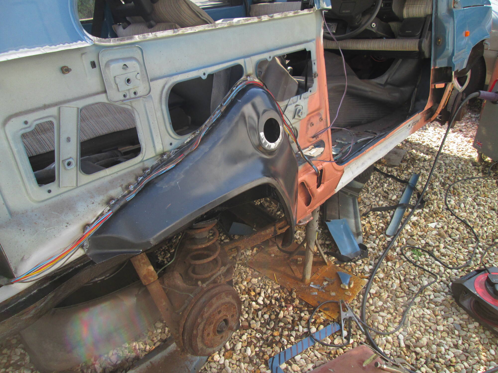

  2. Yes, there was no way I would have been able to make any sort of decent job without removing the wheel tubs. It then also made their repair easier as it could be done on the bench.

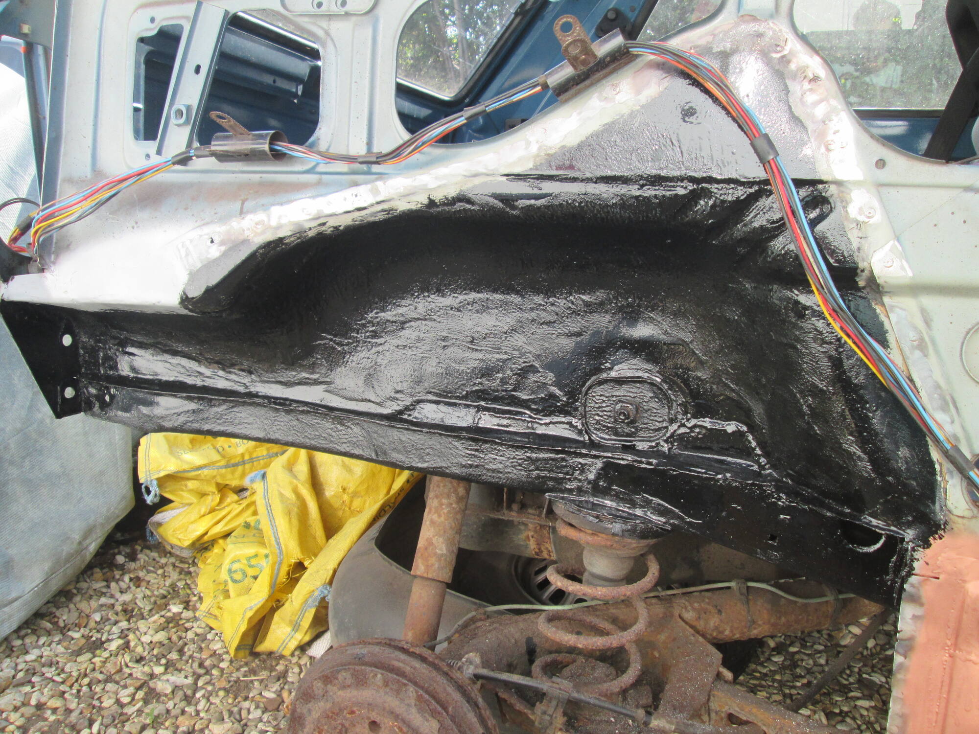

  4. Ive been persevering with this for the past month or so. I ended up doing the other wheel tub and arch as well, plus I had to fabricate a new fuel pipe mount. It's actually all back together now, seam sealed, the underside painted in POR 15 and undersealed. The interior is now all leather cleaned and back in. I ended up taking the towbar off as well, due to making a couple of holes in the vicinity of the MOT no no area. I cut them out and welded in new metal. The towbar was painted in POR 15 and reinstated. I'm just waiting on some chimney nuts, so I can put the right rear quarter/bumper back on...

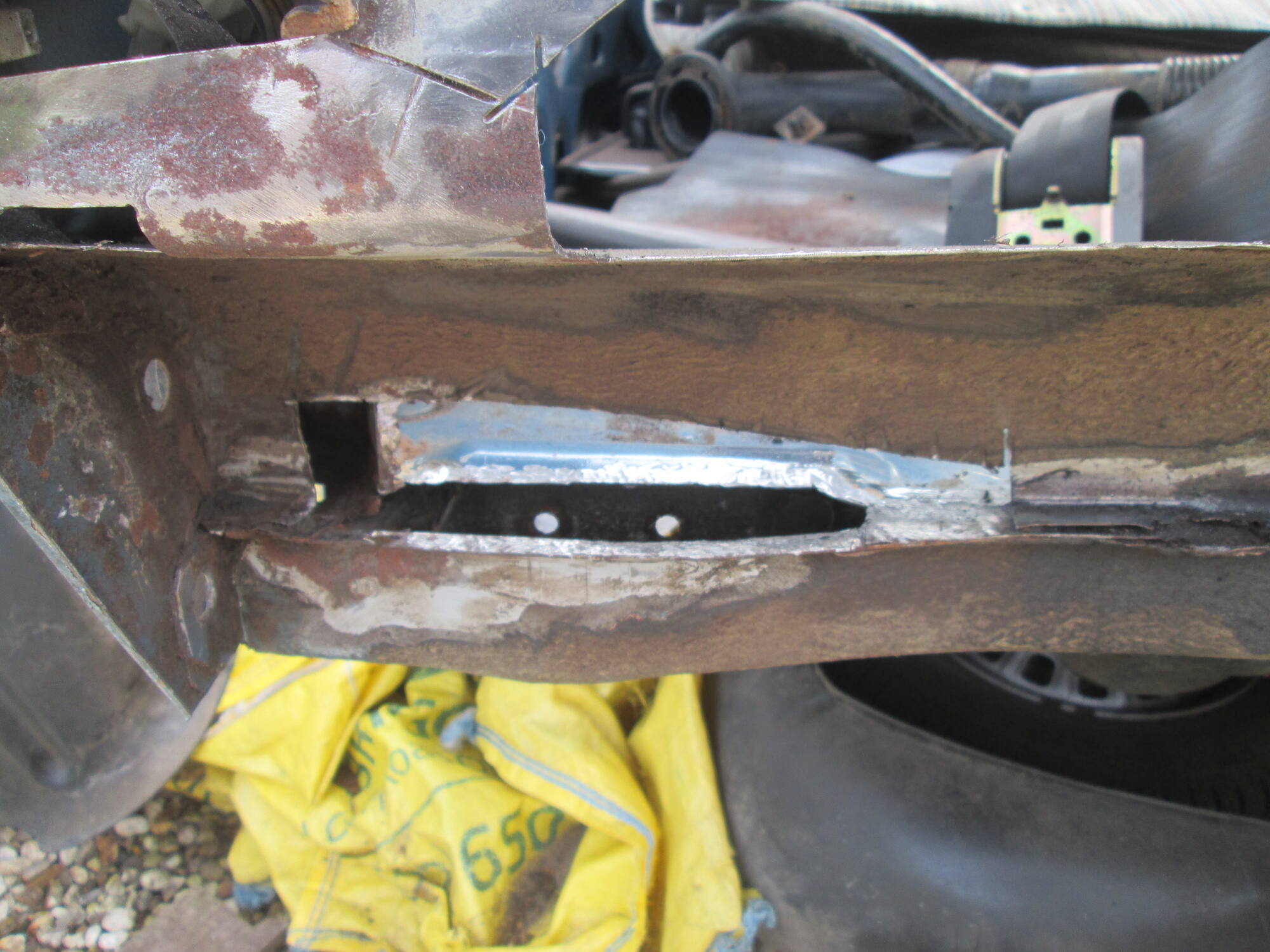

  21. I haven't used bracing, but I do try to deal with one section, complete it and start on the next. For instance I made sure the inner sills were back to strength before chopping about the back sections. Where the seams are exploding, for example in the arch where the boot floor meets the inner wing and chassis rail (the two pics below), I bite the bullet and chop it out, with a dremel in this case as it's easier to get in. I then make repair sections, in this case two pieces, a floor section and then a wing section. As regards the triangular section you referenced, in my case it is solid and the seam is OK, the rust on the section is surface which I ground off with a cup brush and a dremel to get into the corners. I then put converust and painted with POR-15. There was actually a little bit above the triangular section on the seam, which I dremeled out and you can see in the below picture where I welded in a patch and ground the welds down. Top left 1/4 of the picture.

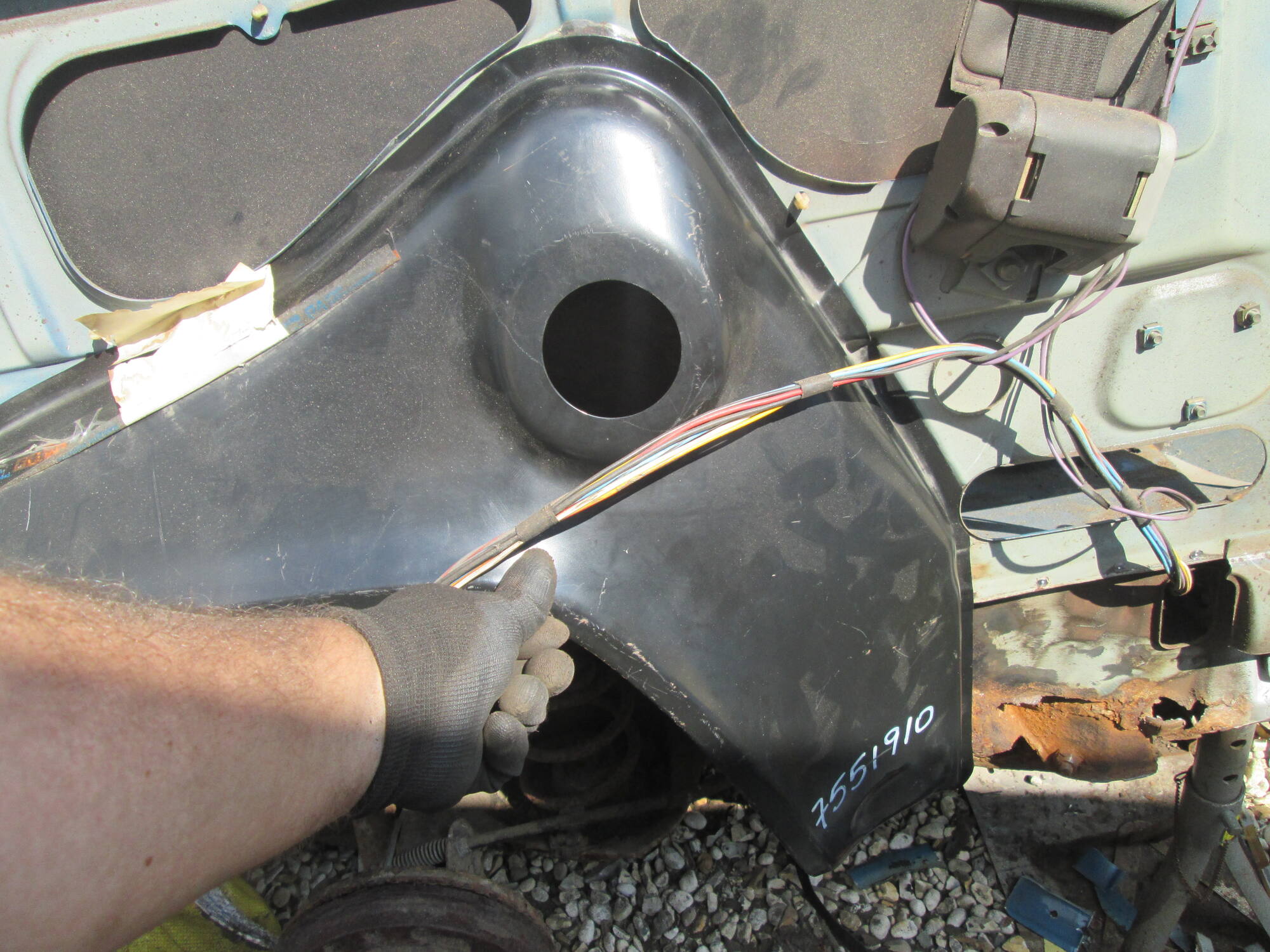

  23. I thought I'd update this thread with recent shenanigans, but realised I hadn't updated it for ages... Panda bodywork... | had lots of little repairs to do to all the common Panda grot spots, before I could even comtemplate replacing the outer panels... I've tried deleting the last picture (below) as it's out of sequence and doesn't add much, but it's not havin it...
