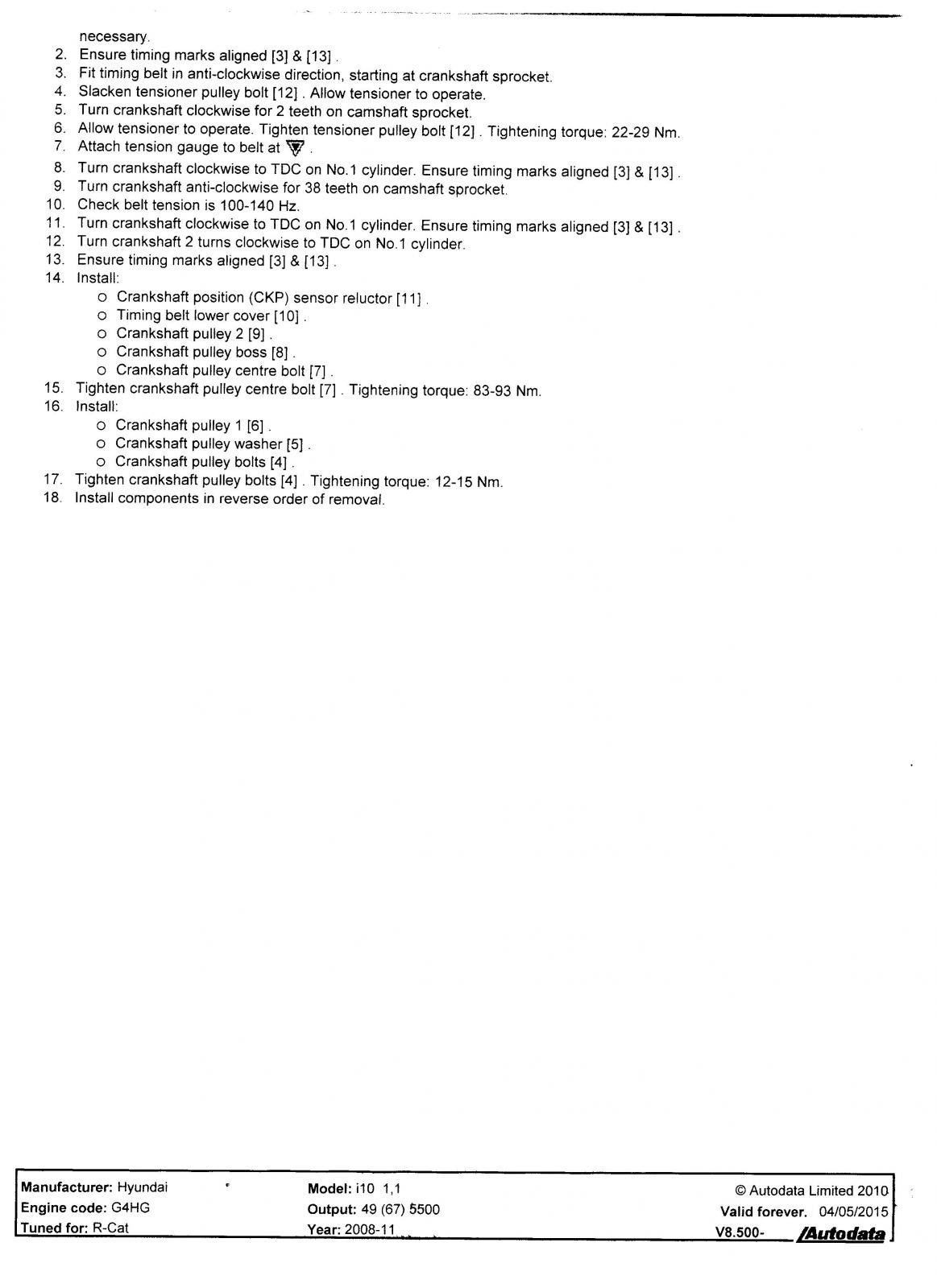

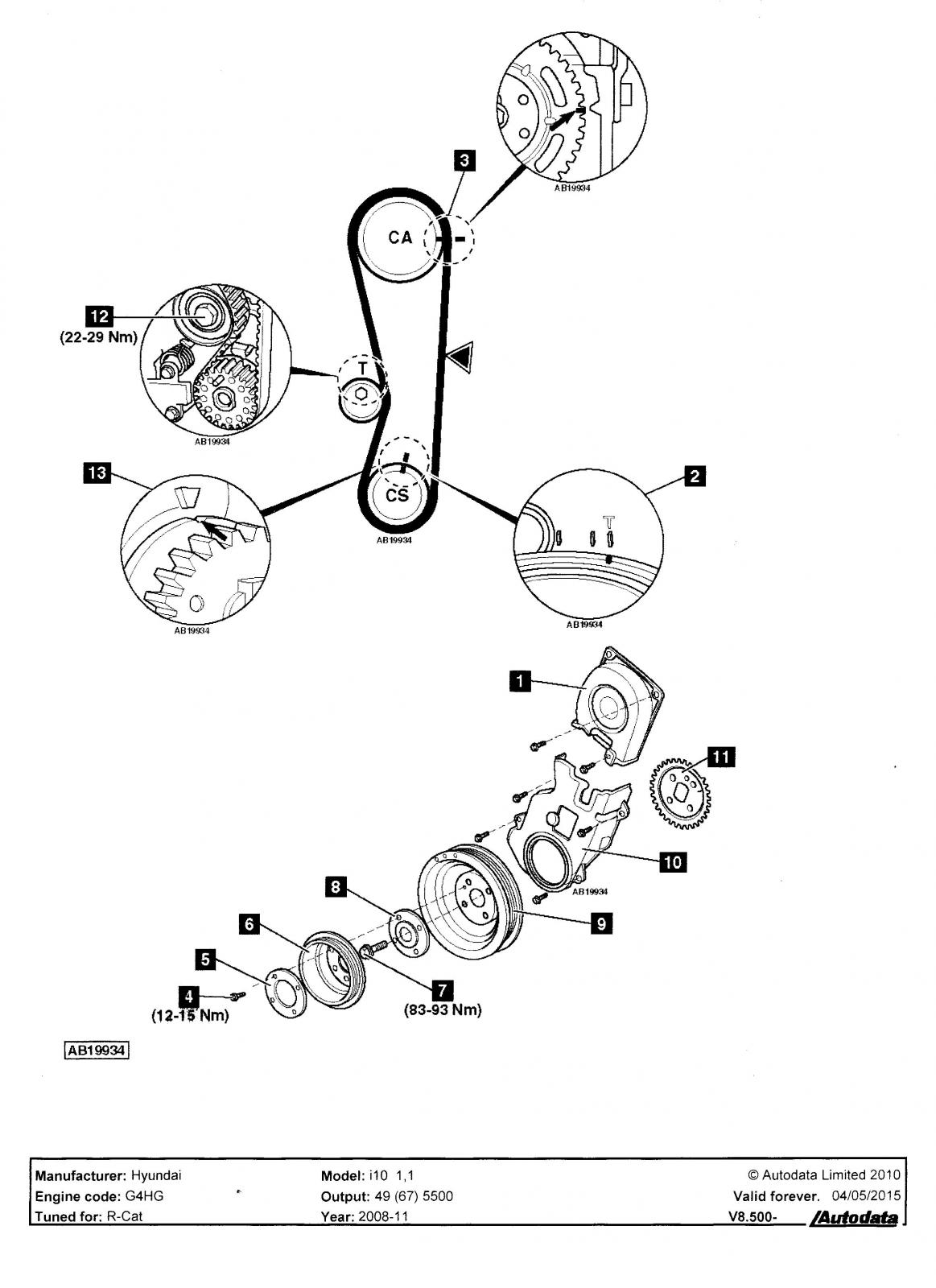

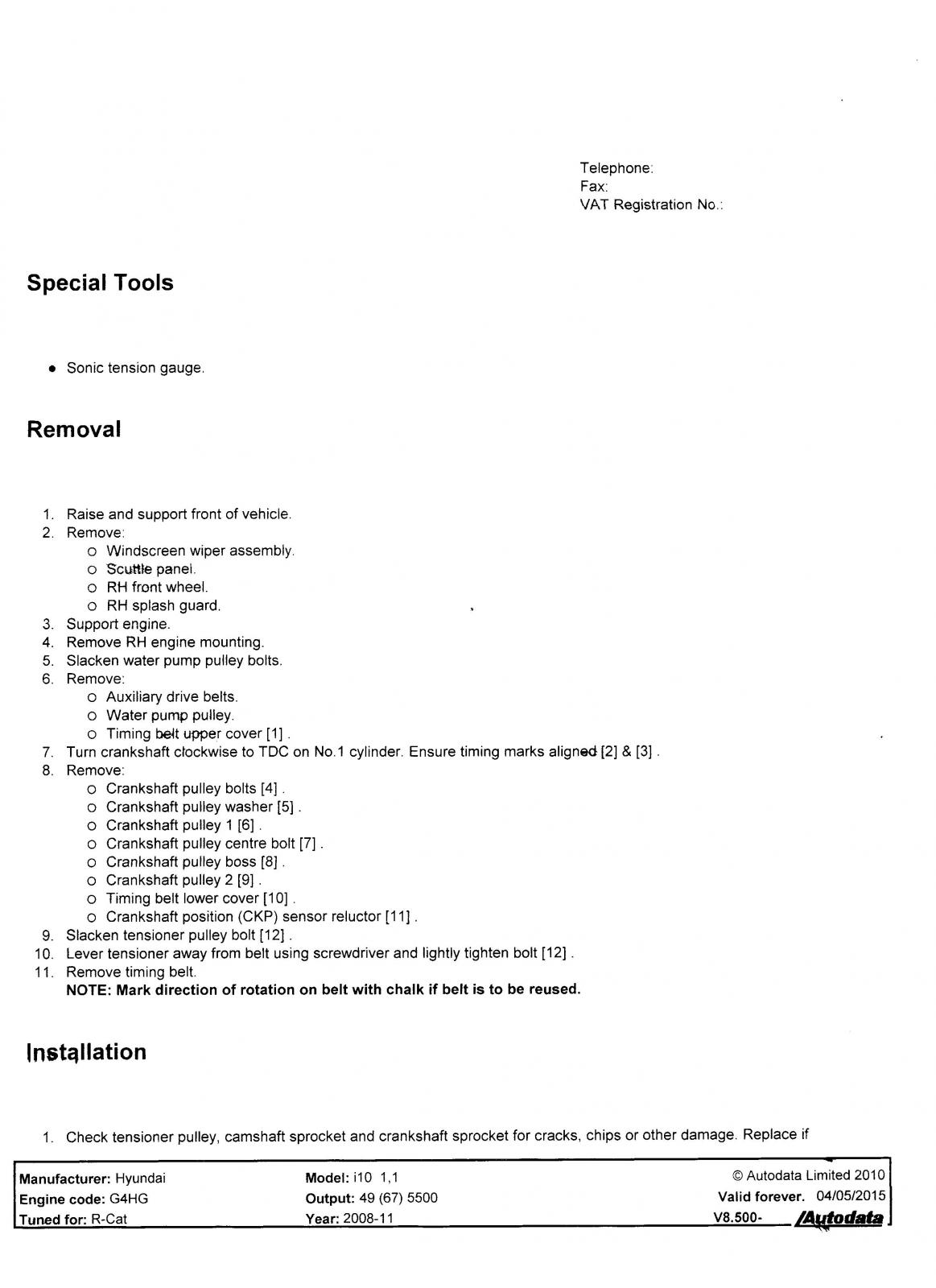

phil_lihp Posted May 4, 2015 Posted May 4, 2015 Anyone done a timing belt change on a 2008-2011 Hyundai i10 1.1? I'll be doing a service on my sister's soon and its timing belt is years overdue (interval is every 5 years/60k miles, it's never been done and it's 8 years old with 47k on it). I've only done a couple of fairly simple ones before and can't find much info on it online.
spike60 Posted May 4, 2015 Posted May 4, 2015 I have Anyone done a timing belt change on a 2008-2011 Hyundai i10 1.1? I'll be doing a service on my sister's soon and its timing belt is years overdue (interval is every 5 years/80k miles, it's never been done and it's 8 years old with 47k on it). I've only done a couple of fairly simple ones before and can't find much info on it online.I have Autodata 2011 and it looks a simple one, cam and crank are marked and there's only a tensioner running on the belt as well. This is for a 2008 petrol 1.1 without A/C, if yours is different let me know. I'll see if I can post info but I'm a bit of a dunce at IT.Book time 1.9 hours to remove and install so should be straightforward. phil_lihp 1
phil_lihp Posted May 4, 2015 Posted May 4, 2015 Great, thank you. It does have air con, any info would be gratefully received.
spike60 Posted May 4, 2015 Posted May 4, 2015 Hope these help, i10 1.1 2008 belt info. If needed I can post the original paperwork if you PM me your address.If you don't have access to one I wouldn't fret about the belt tension tool too much, if you've done other belts you should have a good idea of how tight it should be.
phil_lihp Posted May 4, 2015 Posted May 4, 2015 That's brilliant, thank you very much! Couldn't really be any clearer either, this is perfect as there's no Haynes manual for the i10. Thank you for the offer but this will be ideal as I can print it out for reference.

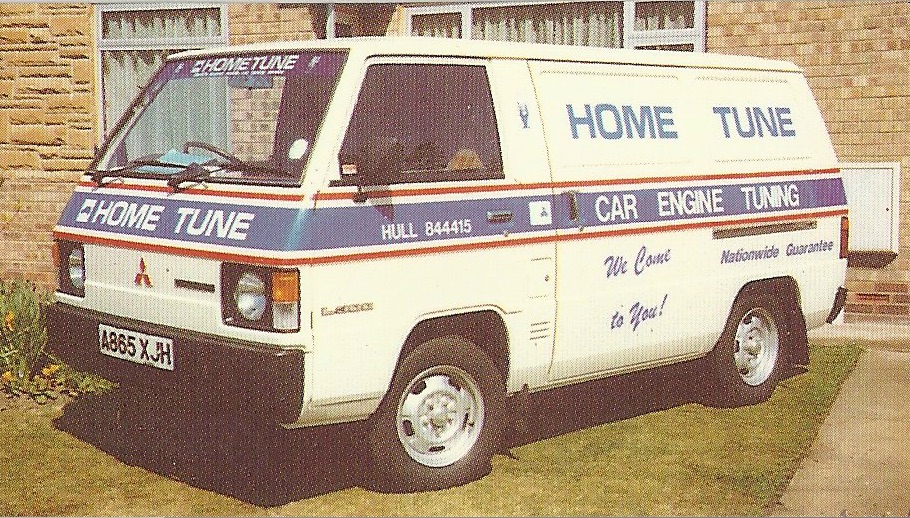

NorfolkNWeigh Posted May 5, 2015 Posted May 5, 2015 Reminds me of when they put the machine in the back of a van and called it Hometune, which I think was a franchise.In my head they had Marina vans then Rascals, but Google throws this up My only experience was in 1981 and in desperation ,getting one out to get my P6 S engined 1958 Series 2 to run properly. He battled for at least an hour before giving up and not charging me. The only specialist equipment seemed to be a timing light and a screwdriver, the van was full of a big white box with dials on it though. Rusty_Rocket 1
