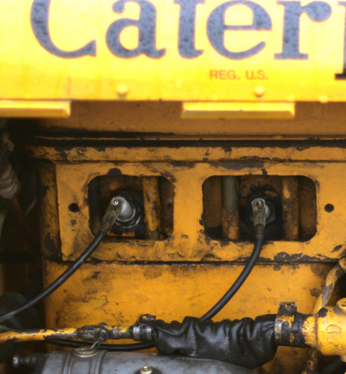

Asimo Posted March 27, 2014 Posted March 27, 2014 Just bought new spark plugs for the motor sickle. They have threaded terminal which I've never seen before, does the HT lead somehow screw on? But you can't turn around an HT lead without making a granny knot...Many plugs are threaded, there is usually a screw-on barrel supplied with such a plug, that will mate with push-on plug caps. Try unscrewing the barrel from your old plug, if it comes off ok you are sorted. Back in olden days, plug leads ended in a ring terminal that was secured to the plug with nuts and washers. Push-on is modern!
