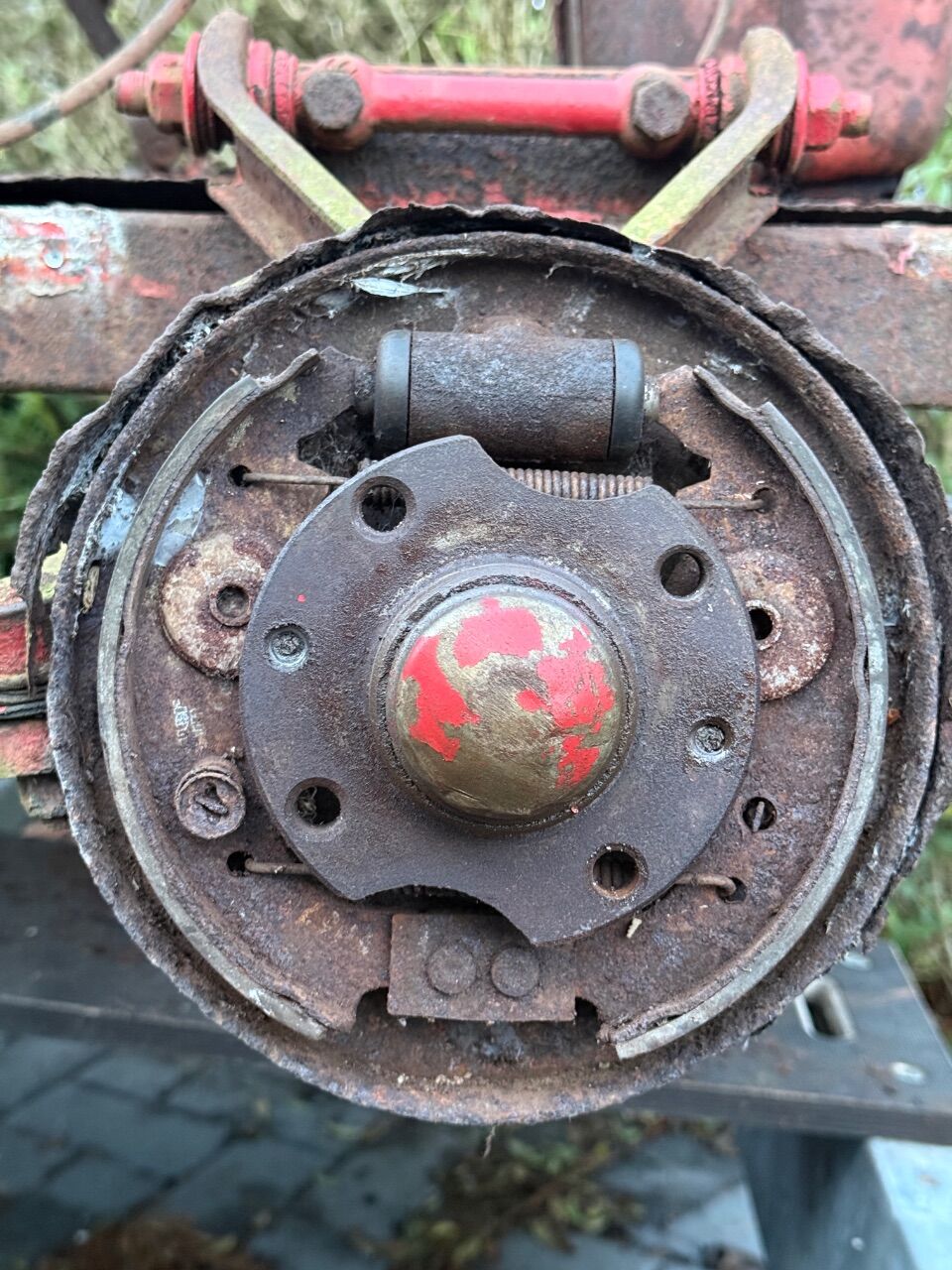

Model 70 Buggy anyone?!

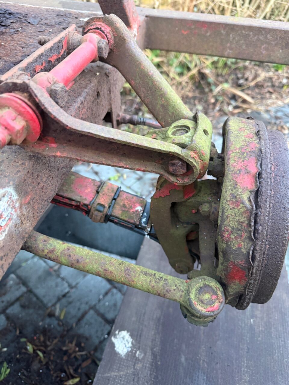

… but can anyone help me ID the front brakes and suspension pls 😊

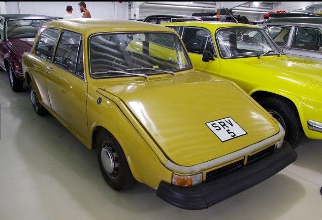

That Victoria car has a Lancia look about it at the front, but from what I can see of the back end, perhaps not!
Lancia meets Dolomite look
Fiat 500 or 126

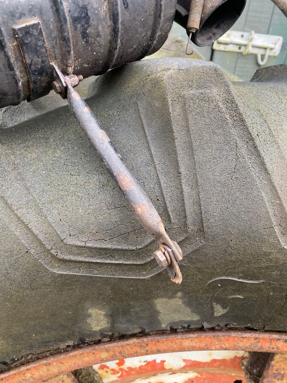

One of the first issues that I have found but not properly investigated yet, is the crankcase breather looks rather rotten.  I’m reckoning that there should be a spring and movement where I have a rust and seizure. Also the air cleaner brace has not been doing anything for some time, it has broken off at the base.IMG_1262.jpeg.0bd54f741adefe61cfac5f03af35cfba.jpeg

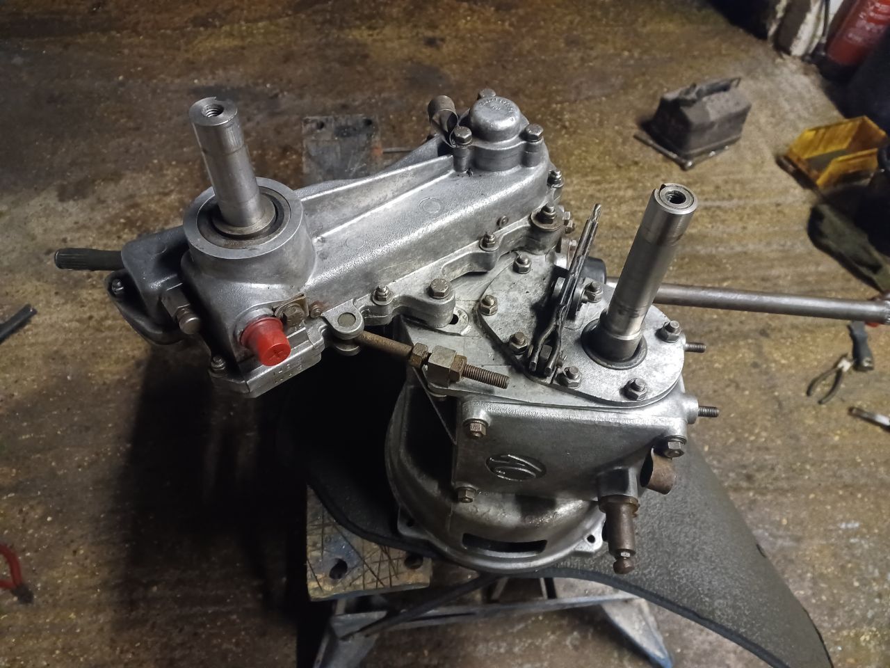

Well, engine removal has come to a grinding halt. One of the two variable pulleys, which should apparently just slide off of the shaft is refusing to budge. I have tried simply pulling, light prying and hitting the rear with a soft mallet, sadly the puller I had at hand was not large enough to reach around the diameter. I’m thinking that the only way forward is to fashion up a puller. I did have a quick attempt at removing the belt to remove lateral pressure but failed at that also. 😞
IIRC one or both of the shafts has a key that needs to be removed first, but you have probably found those already!
The second pulley moves freely up until the tension of the belt stops it, the first just will not move. It is keyed but it appears to be a simple parallel key which should just slide out with the pulley or remain in the key way? It doesn’t have a gib head.
Just incase the belt tension isn't helping getting them off, undo the adjuster bar for the chain case and the 3 or 4 bolts that clamp the chain housing in position.  You can see ones through a slot in the gearbox casing and further down they had penny washers on them.
Assuming like the last two of these I've worked on, yours will be a caked on black mess of shite so have a clean picture of one.
Keys ways are just open ended so the key will slide or stay and shouldn't prevent the pulley from coming off.
Oh I did not realise you where trying to do it with the drive belt still firmly in place, sorry every time I have done this job, the drive-belt has previously already removed itself from the equation LOL, right, yeah if your doing it with the drive-belt in place, then you either need to slacken off the belt as @Andyrew says/as @Zelandeth does, or if for whatever reason that cant be done, then you need to remove both pulley at the same time and hope the tension of the belt pulling them together does not cause too much binding
but if you have spare drive-belts, I would recommend just chopping off the old belt and getting it out of the way, unless your cousin, @Weird Car or @OldBlokeInACaravan has unknowingly replaced the drive-belt, its probably not long for this world anyhow!
The pulley looks like aluminium?   Heat gun, repeatedly, should free it.

Managed another hour after work today and backed off the chaincase (thanks for the picture Andyrew , everything is indeed caked in filth) and removed the belt. Still no movement. The pulley is Ali but it is bourne upon a steel sleeve.
