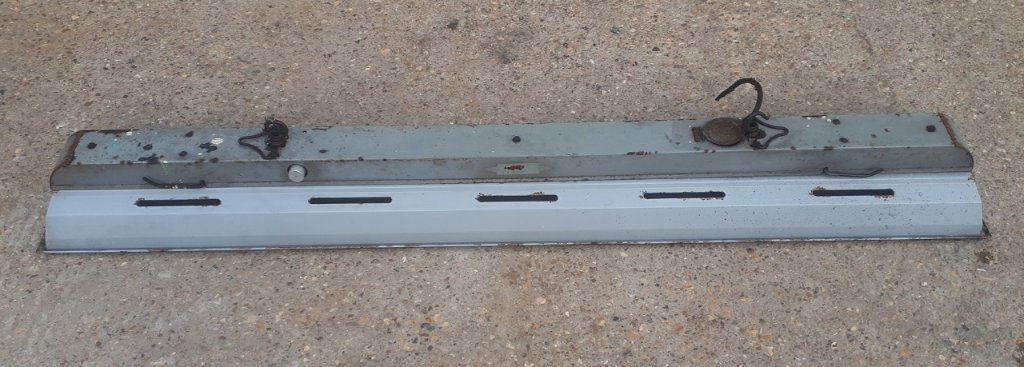

Light on retrorides for sale  lbf !  Only 20 quid
Awesome got a link? I had a bit of a search of Retro-rides dont see anything there but perhaps I am missing something
8 minutes ago, 500tops said:
Awesome thanks for that! Ill have a look at grabbing that I think, funnily enough I have been to that general area with REV in the past, thats when I discovered what fun* spray off Lorries on the M25 is, I was actually thankful when it started raining properly LOL, otherwise you go to over take and your windscreen turns opaque, I went through a lot of screen wash on that drive (which reminds me actually I need to top that up in REV)

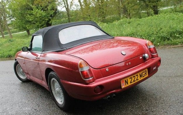

I suppose another variation on the theme is, what would an ADO16 look like if it was given the sort of treatment later Mini's where given?
A bit like the 'chunking-up' of MGB body tub to create the RV8 (I know a lot of people don't like it but they had to do something).
Would ADO16 have facelifted? Of course it would. Would it have met upcoming legislation in era - probably not in time. But it would have bought time to jump straight to a Maestro type car or to brush up the Maxi.  Ah counterfactual history - what fun.
That Victoria car has a Lancia look about it at the front, but from what I can see of the back end, perhaps not!
