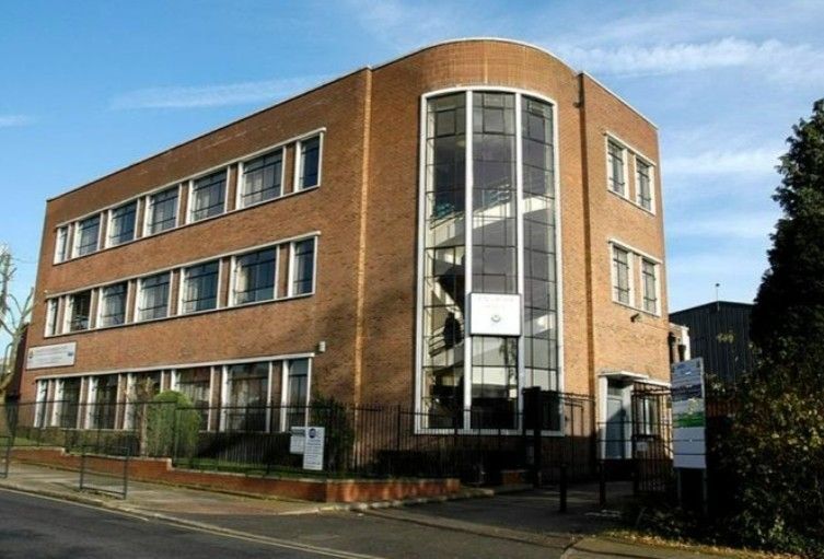

For a photo opp' the VDP works offices are still there in Kingsbury North London - thought the works behind is demolished.

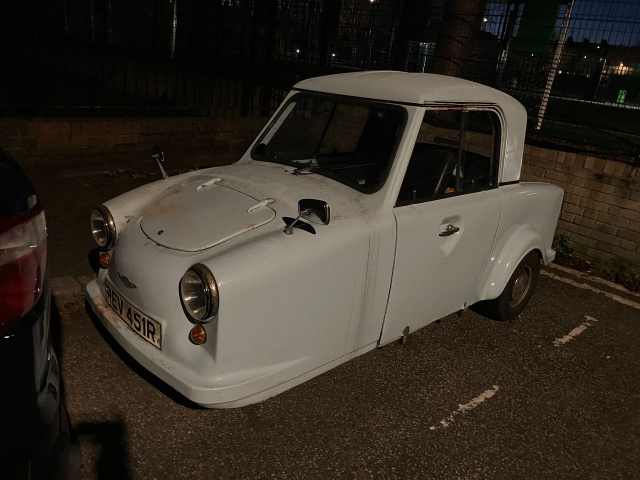

With the VDP, it probably is a bit of getting used to it. Particularly where your used to nipping around in REV, which I imagine is in its element in the middle of town!
Ive got a spectacularly short fuse when it comes to busy driving in towns. London is its own thing of course but when I was working I had to drive a big van and often a big trailer around Portsmouth, Chichester etc and remember it being incredibly frustrating.
It’s probably different though if you’re driving something like a classic car. You’re more likely to want to be driving it than something else. Ive never liked crowds or busy places tbh though so maybe that’s part of why I don’t like driving in towns and cities.
I suppose regardless of having a drive or garage, the cars like REV and the VDP were used constantly in places like London for many decades. People didn’t have off road or undercover parking, they parked in the street as close to home as they could and drove the cars around as cars and transport. Why can’t you still do that!?
