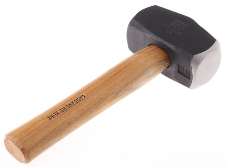

I think a lot of people under-estimate just how tiny the engine bay on the Fox is.
Plus
Equals
Yes, I know that's a Reliant Kitten, but near enough.
