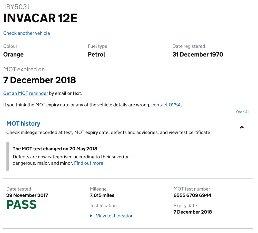

1 minute ago, brownnova said:
Colour: Green
Erm....
Well done on a successful pass Foxanne! Now if you can pass that same luck to my MX5 for tomorrow that’d be great!
it says blue here so go figure! LOL (DVLA for you...)
and its not the only vehicle I have seen like that either
(no im not apologising :mrgreen: )
