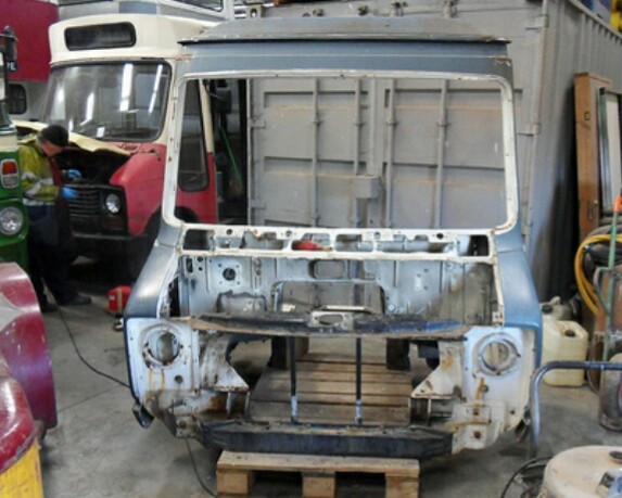

Could get the cab off to aid welding does the horse box make that impossible ?. Welding upwards with your head jammed in a wheel arch is the worst .

Not sure what the front end swap stood these guys at, but at least they could get right into the hard to reach areas!
Cab off would probably make it a lot easier...

Plus side is that a lot of that grot isn't going to be visible, so the welding doesn't need to be pretty as long as it's solid.
