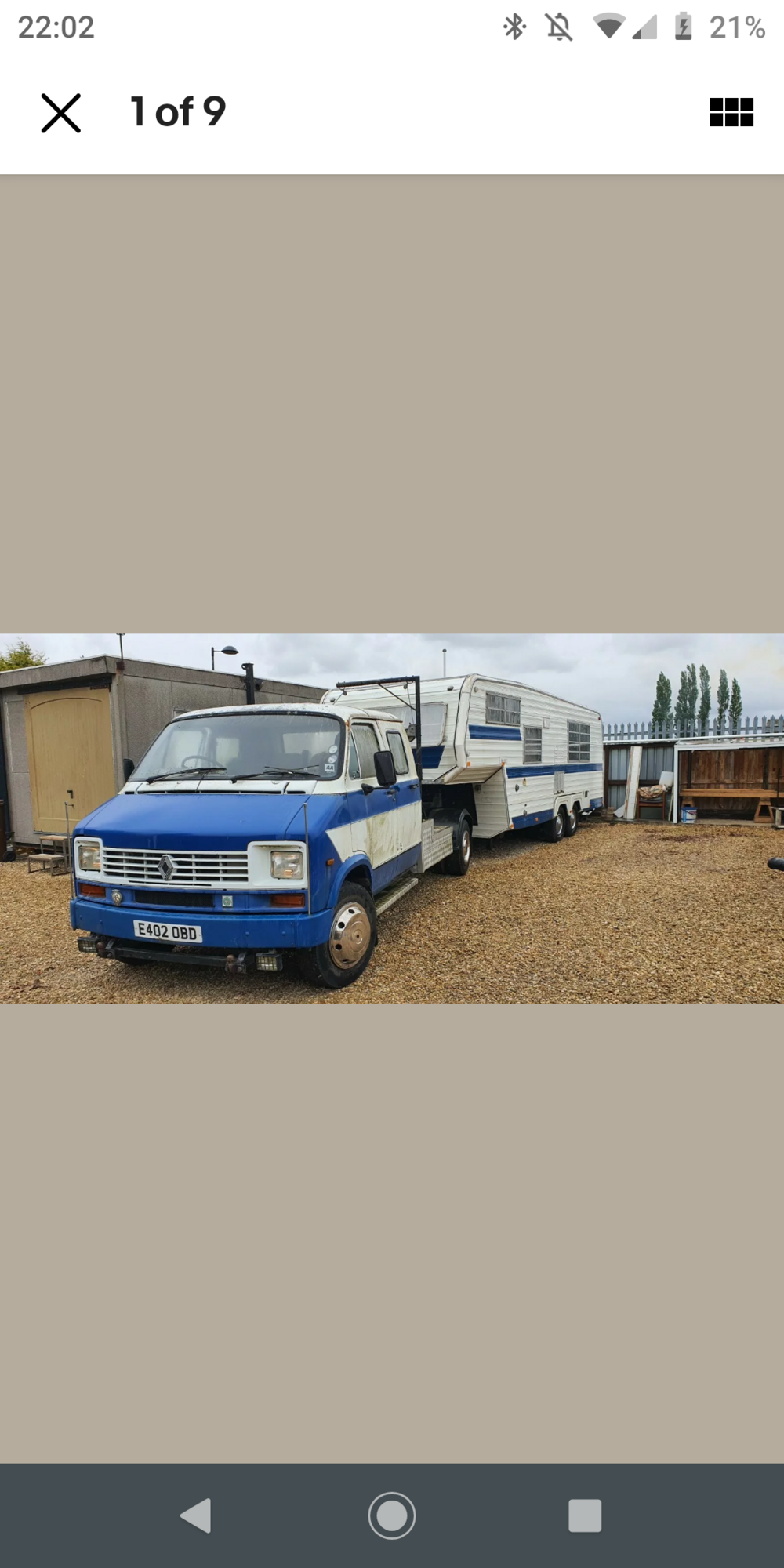

https://www.ebay.co.uk/itm/horsebox-renault-dodge-50-series/254566579385?hash=item3b4559bcb9:g:3okAAOSwhtNej2yk
"STARTS PERFECT"
You just know from the fact it is surrounded by so much shite they can only photograph a 15 degree portion of the front corner it hasn't moved in 10+ years
