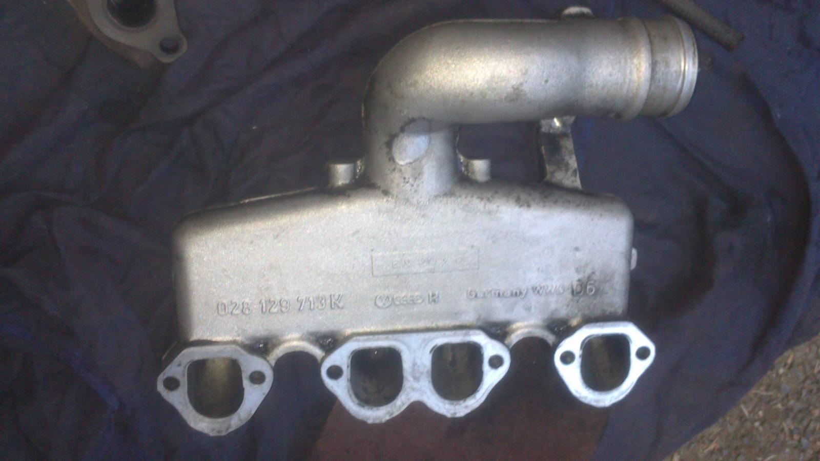

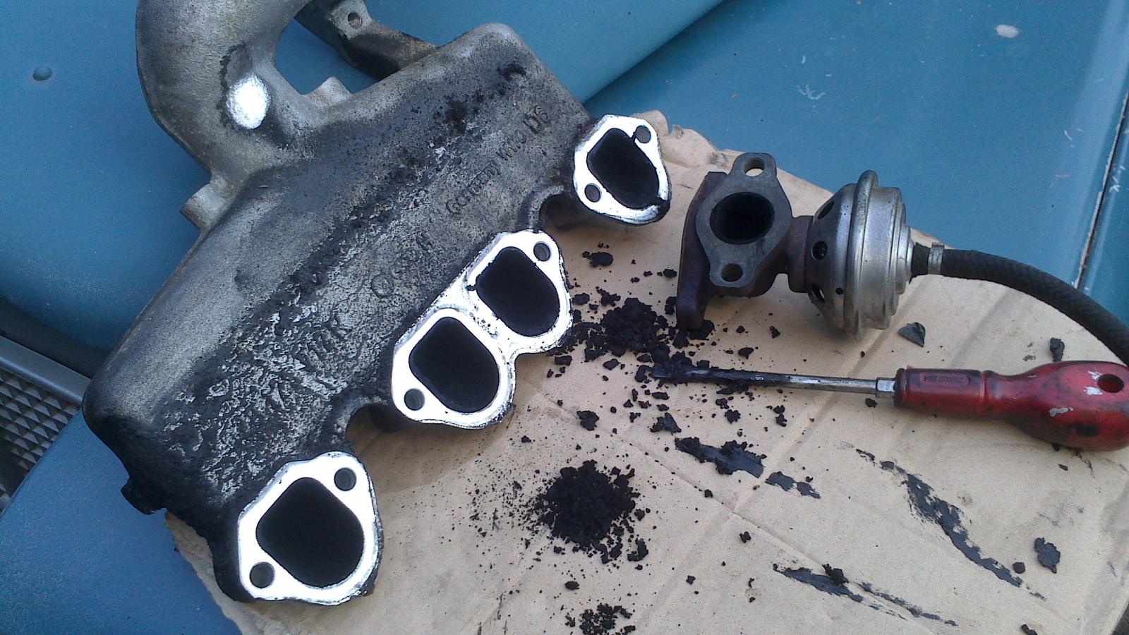

My A4 has been misbehaving lately. It feels like it is losing boost for a second or two when driving with a steady throttle. Like being hit face on by a gust of wind.

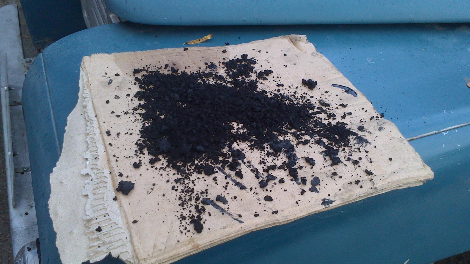

I followed some advice by new member JBH110tdi and had a go at cleaning the inlet fanny mould.
It was dirty
Very dirty
I got busy with a toothbrush and some degreaser. In hindsight, I should have used some Mr Muscle oven cleaner and the steam cleaner.

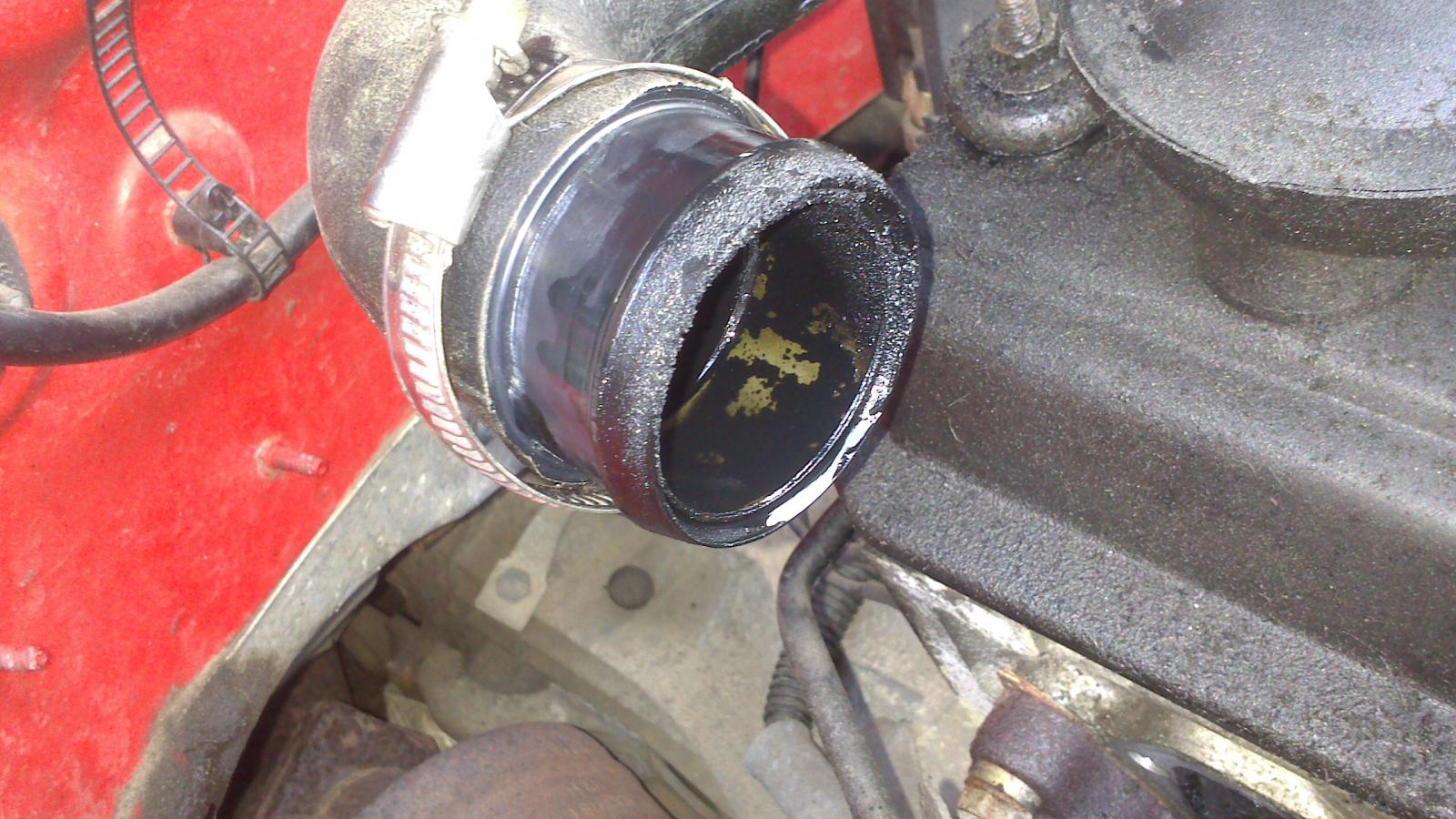

This two inch rubber pipe has a crack in it. I think it's coming from the intercooler. I'll try and get a replacement but meanwhile I've put some inner tube round it as a temporary bodge.
A quick test drive later and the problem didn't appear so maybe I've fixed it.
Might make a blanking plate from aluminium for the EGR valve.

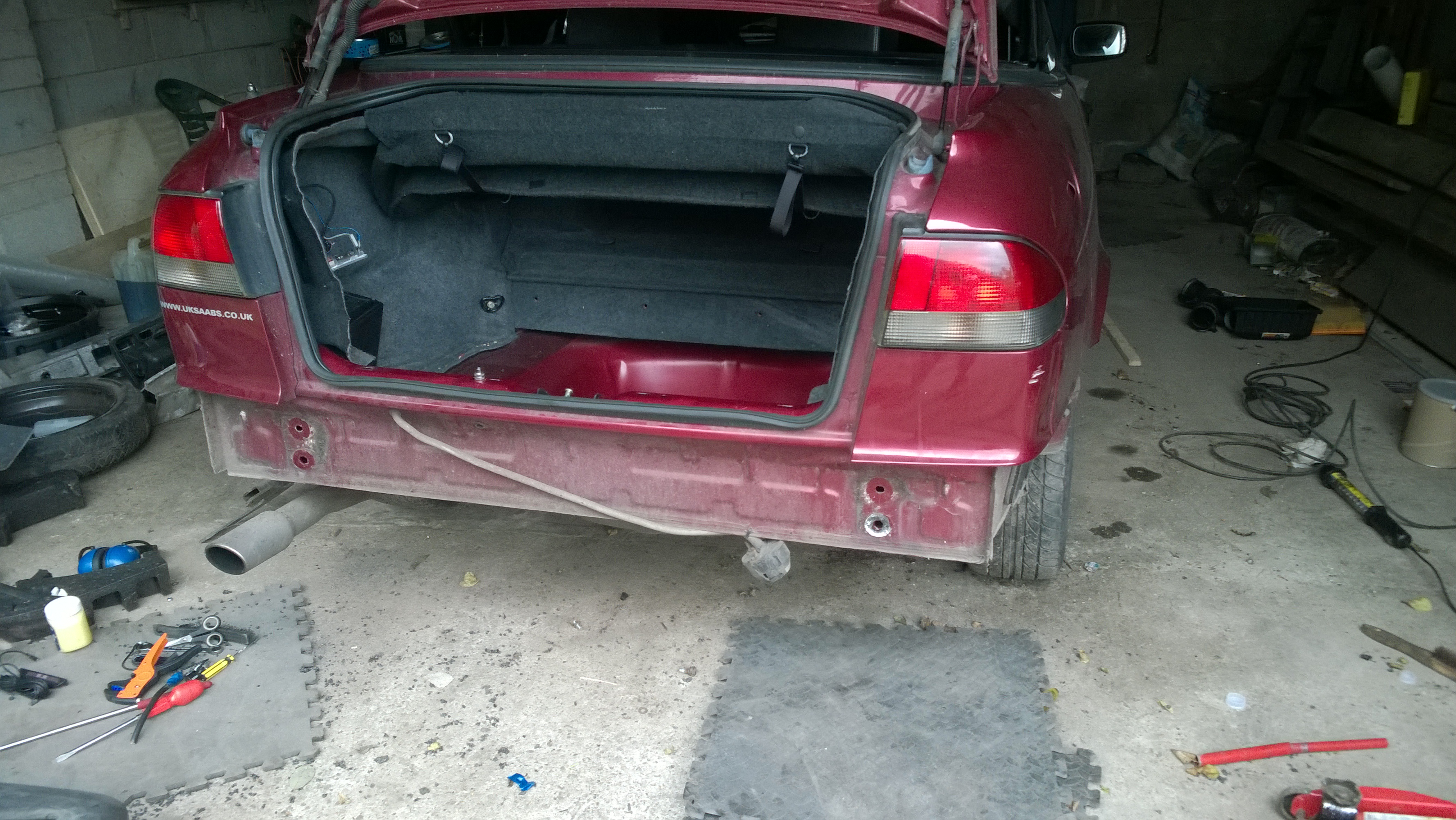

Fitted rear parking sensors in the Saab today. When I ordered them I didn't realise they were from China. Naturally as soon as they were installed they decided to be a bit patchy. I am half tempted to rip them out and replace them with better ones. But cant be arsed right now, so will live with it until my missus complains enough.
Pic mid install

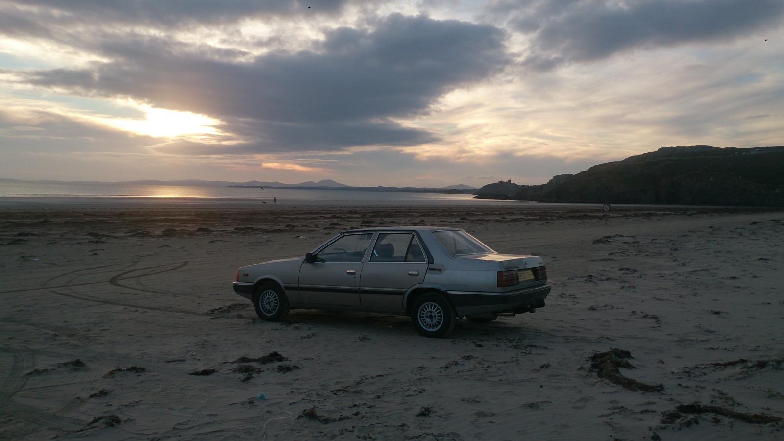

I needed to do a bit of shopping this evening, and as it was a nice day I took the Stellar to enjoy the drive in the evening sunshine. And I'm a sucker for sunsets, so I thought I'd go the long way round to Tescos, via the beach and get a photo.
(Really must sort out that rear wing...)
But it's now cracked over 1000 miles since getting it on the road this summer, and only needed recovering once!

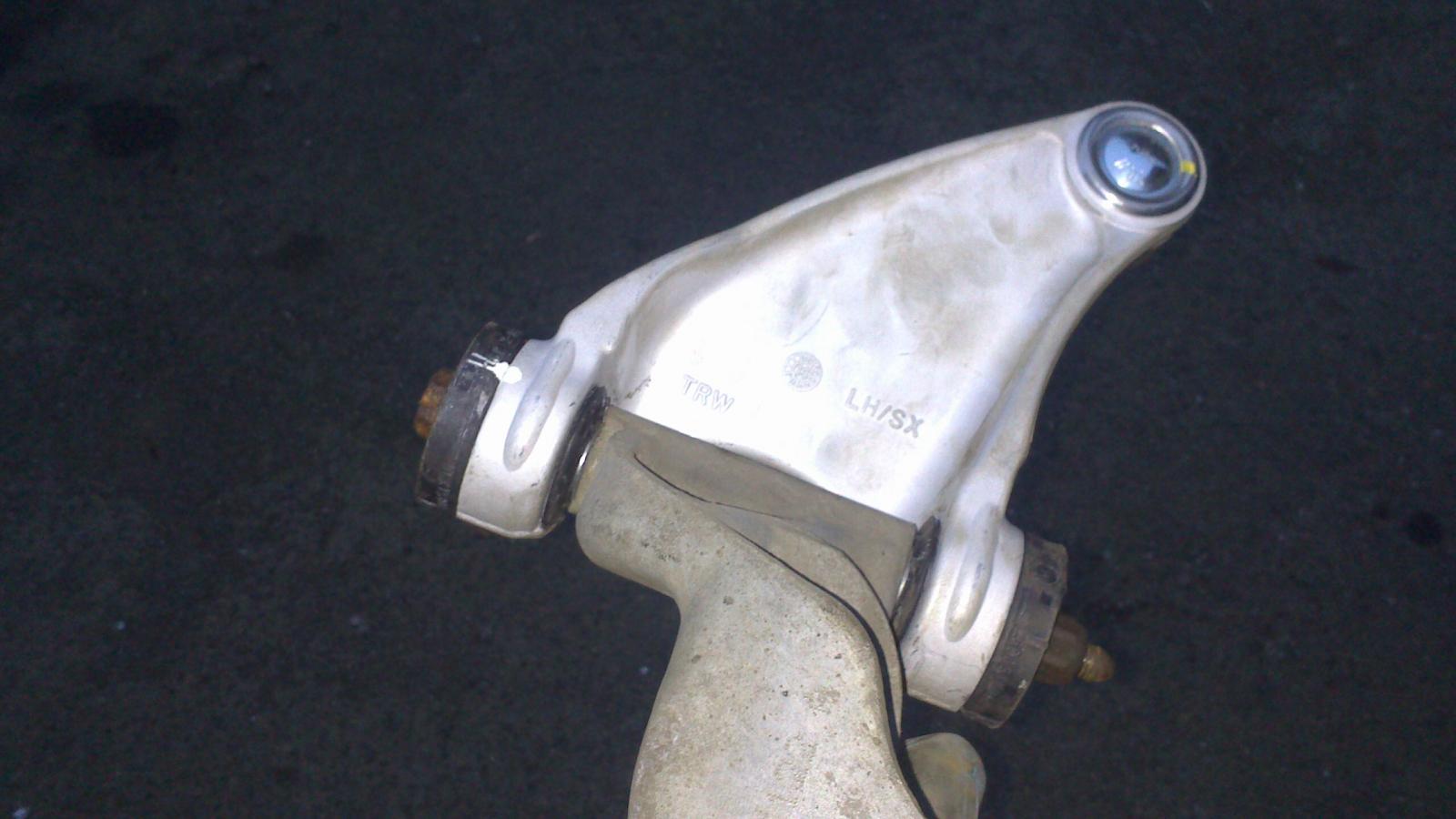

I've been spannering again, this time on the wife's alfa 147.
It has been clonking from the front and I noticed, when changing the exhaust the other day, that the front nearside wheel was wobbling like it had a collapsed bearing! Traced the play to the upper wishbone bushes.
As well as two bushes, the wishbone has a ball joint so I splashed out and ordered two new wishbones.
There's a good guide on the alfaworkshop website, but while it has the job done in five easy steps, the reality of rusted nuts and bolts is rather different. Ball joints to split and I don't have a splitter tool. Seized Allen screws for added fun*
Basically took me all night to do both sides.

Shiny new wishbone
