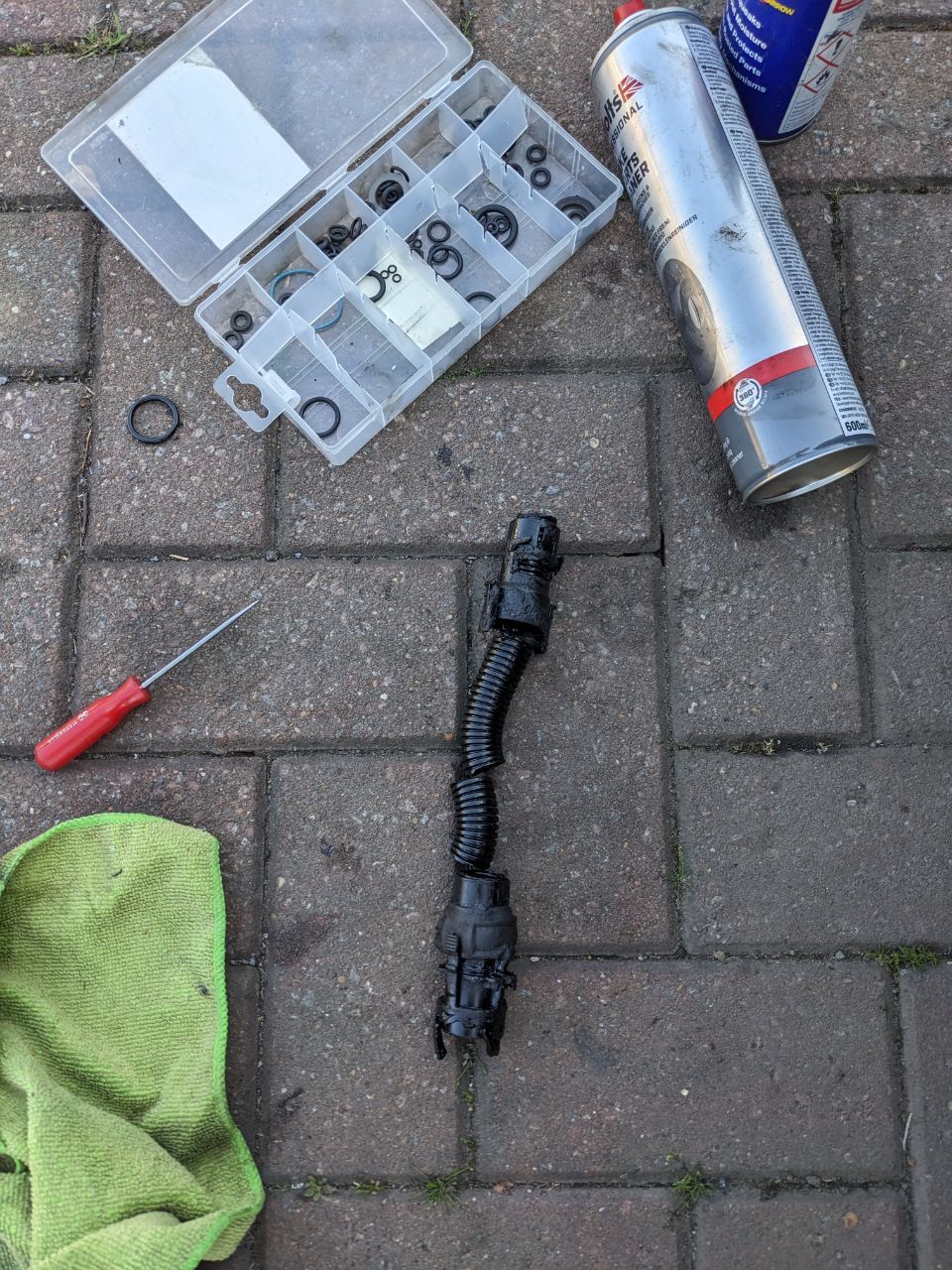

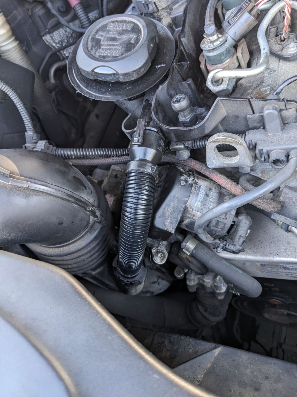

Soooo transmission fluid and mechatronic seal change on my E90 330i ZF 6HP gearbox. I've been putting this off for a while as it's a pia job being on your back. To be honest, it wasn't as bad as I thought it would be in the end.
Car jacked up. Probably the bit that always takes me the longest. Faff in getting the stands in the right place when lowering and making sure it's stable. Double PIA getting both ends up and level. It's not actually level in this photo - my drive has a slope. Later on I level off for the fluid top off.
Panels off over the filter & pan. Yes it's a plastic pan.

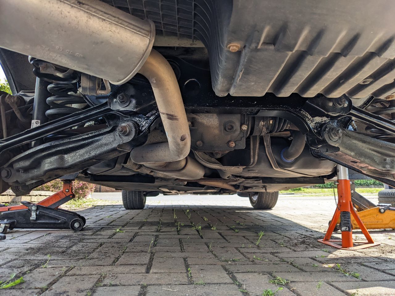

The exhaust mount has a bolt in the middle to clamp together. This sheered off. Stupid aluminium (or something non ferrous) mount and bolt. Ended up drilling this out later and sticking a bolt through the top and a nut+split washer on the other side. Mostly as dissimilar metals may seize together and having a nut on a replacement bolt has some chance of it being removable in the future if needed.
Undid the fill port first. This is a 8mm hex and needed an awful lot of force to crack it off. I couldn't get a ratchet in there at all. Later on when I tightened it up, I couldn't get a torque wrench in so did it as tight as I could...
Drained from the drain port first (10mm hex) and then dropped one end of the pan to remove the last lot.
Filter was date coded 2005. So almost certainly factory. Fluid didn't look too bad. Apparently changed 6 to 12 months before I bought it. I think that would make it around 8k miles. Dirty but nothing tragically awful from what I can tell.

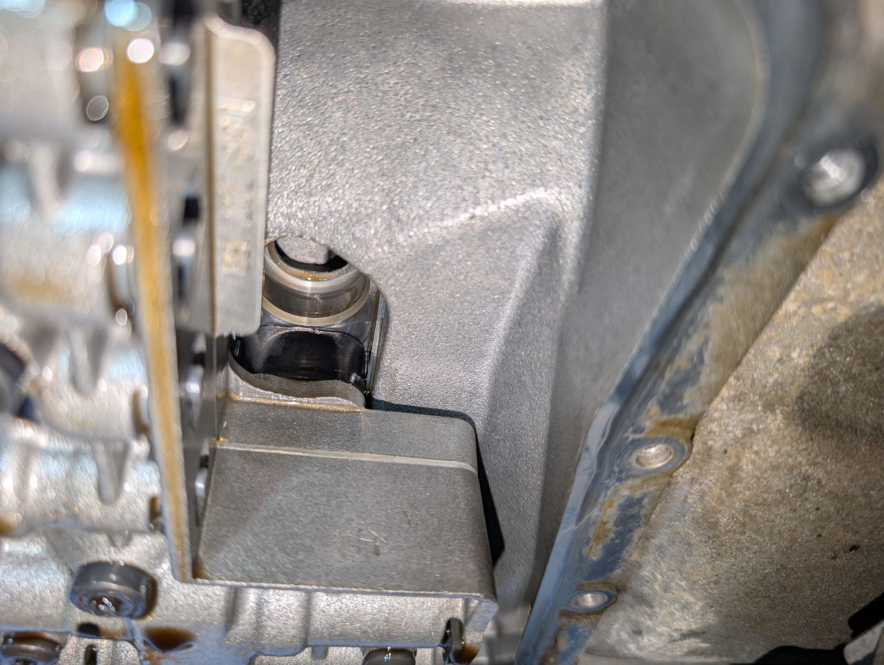

Mechatronics (valve body) off. This needed the electrical connector disconnecting on the outside, white plastic tab pulling down on the mechatronics and removing the connector seal. Some say this is a nightmare to do. However I could get my hands in with a bit of a squish? Maybe those doing videos on this have massive hands? (I'm used to putting hands in awkward places as I often drop bolts and such, needing retrieval!)
The seals are on top. The big double D seal is the main line pressure port. These can split. Mine hasn't (I forgot to take a picture of it) however the o-ring was all deformed. Obviously leaks from here is sub optimal as the gearbox ECU needs to compensate the lost pressure by bumping up the force & time with the solenoids to the clutches+brakes.
The four other seals compress over time and leak. These were removed with a pick. A tad fiddly and for a bit I was concerned they weren't coming out. Did eventually and I just needed to be careful I didn't go through and scratch the bore.
You can see here the seal length difference. New left, old right. Not massive but enough that they can leak fluid when pressure is being driven through those ports. These ports go up to the clutches and brake bands. So not somewhere you want pressurised fluid to escape from.
With the new ones all in, you can see them sticking out slightly. This is what they should be like and get compressed when the valve body is out back on. I pushed hard to make sure they were fully seated. All I soaked in some old ATF to lube them up.
Valve body reattached - 10 bolts and all the ones for removal are Torx #40 to make it easy to know which. These need to be reattached in a specific order to ensure even clamping. Also a piddly 8nm. I bought a specific low range torque wrench to do this as you absolutely don't want to cock this up, let alone risk stripping a thread. Box will likely be scrap if you do that.
Also the shifter sensor needs lining up with the shifter metal post. Mine was actually out of alignment at first. Easy to move around and correct but definitely don't want to find out/remember you haven't done it when it's all buttoned up!
External electrical connector pushed in just fine - again easier that I could get my hand in.
New filter looks very similar to the old. The filter is moulded into the pan and replaced as one. 24 bolts to reattach this pan and again they need to be done in a specific order. Being plastic, they're very prone to warping and risk leakage. Something you definitely don't want as low fluid the transmission ECU won't know but will bugger the box from pumping air. Torque is a tiny 10nm per bolt. Again my new torque wrench is essential here to do the job properly.
I called it quits for the night at that point and started again today in daylight.
Not many photos today but tbh the refill isn't very exciting.
First thing I did was remove the pan again. I really didn't want to do this and risk warping the pan, but I wasn't fully happy that I didn't knock the big double-d seal when mounting the mechatronics. I didn't align the mechatronics unit properly at first and took a few attempts while trying to get one bolt in and started. However looking through my photos of the night before, I realised the double-d seal is right next to the filter port. So I could easily see the seal even with the mechatronics in place.
This is what you're looking at here. The black thing in the middle is that double-d seal. Looks bang on in place to me.
I did level the car off. Turned out dropping the back stands by one position got the level absolutely nailed on.
For refilling I bought this thing. Uses compressed air from my little Lidl compressor to charge it. You can get hand pump ones but as I have a compressor, this made more sense. Absolute god send and filled 4 litres of fluid in less than a minute at 30psi.
Refill is not as complicated as many make it out to be. First fill is with engine off - took about 4 litres. You start the cold engine and then top up till it leaks out the fill port. This was around 3 litres.
You run the gearbox up to temperature and cycle through PRND a few times. I kept topping up during this and putting the drain plug back in. At 40c (read using a scantool) you check the level by removing the plug and it should be a slow stream apparently. Once that's done, you put the fill plug in properly and shut down the engine. If the transmission fluid gets to 50c, you need to shutdown and wait for it to cool off. Tbh that pressure filler was by far quick enough that I had to wait a fair bit to get to 40c anyway - even at ~25c ambient temperatures.
In total I think I put in around 8 litres. I bought 10 litres but that seems to be overkill. Maybe I'll do another fluid change in 10k miles or so. Just fluid, not filter.
I was supposed to be going to the gym tonight and I really didn't want to miss a session. So I quickly packed up, put the panels back on underneath and dropped the car down. Got changed and went out to the gym as a combined test drive!
Knocked a great session out, despite being tired from rolling around on my back. Then came back and checked for leaks.
I couldn't see any where the gearbox was. The oil stain I think was from my Spitfire when I took that over last week 🤣🙈
So how does it shift gears now?
Erm well not too much different! 🙃
Actually that's not entirely true, it doesn't flare between changes when in manual mode (albeit I almost never use manual normally). Changes do feel a bit smoother but not completely imperceivable. The bump you get when stopped as it goes into neutral has gone away. Pulling off there still is a slight pause but I haven't tried that too much yet.
However it's still early days. The gearbox adapts to internal wear and now the pressure lines are different, it needs time for it to adapt to its new world. You can reset adaptations - often recommend on forums. However it's NOT recommended by ZF, BMW and xHP (a gearbox remapping company) if you haven't rebuilt the box. Basically the adaptations are purely for internal wear as it ages. By resetting them you're putting back to factory. So it needs to then readapt for the wear. However this can cause additional wear in the box as it does this. Even worse, if the box internals are worn enough, it may never be able to shift properly enough to regain the adaptations.
So it's basically safer to just keep driving as is and let it adapt itself over time. I've taken notes of the old adaptions and will be interesting to see what they're at in a few hundred miles.
The good news is basically that it's still working just fine! Hopefully this job will prolong the life of the car for much longer period. These seals and BMWs filled for life ATF (ZF say change every 60k) are the major Achilles Heel of the box. The rest actually seems pretty robust and easily can do big miles if these bits are taken care of. 🤞
I'm also seriously considering remapping the gearbox with xHP. 3 stages and I'll probably keep with stage 1. This is slightly quicker shifts but the shift points are lower to aid fuel economy. Stage 3 is nearly DSG speed shifts and great for tuned engines but also increases wear - all stuff that doesn't bother me. Stage 2 is in-between with reduced 0-60 time but not as aggressive as stage 3 and again I'm not bothered too much about out and out performance. Also I might disable the neutral shift when stationary - reduces wear in the box and speeds up pulling off, just with a higher fuel consumption when idling (as the box is in gear). Interestingly BMW/ZF have two main gearbox maps - standard and Alpina. The Alpina map is faster shifting and basically what xHP have based their stuff on.

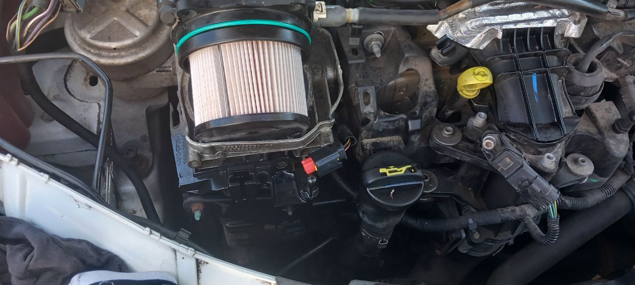

I did the diesel filter on the mondeo. As cleanliness is next to godliness I made use of compressed air before removing anything other than the retaining screws.
Once the crash cover is off you can remove the electrical plug and the four screws. You will need a couple of small pry bars to get the housing away from the body. You will need to go easy - it wouldn't take much to break the thing - and don't be tempted to pull on the pipes.
The old one was dirty and due for a change. The filter just pulls off.
I gave the new o ring a smear of diesel before pushing it all back in. It will only go so far - you will need to tighten the four screws squarely to pull it down.
The car took a bit of cranking before it started but at least it's not like the earlier mk IV's where the filter is under the rear and you have to bleed the thing before it will start.
