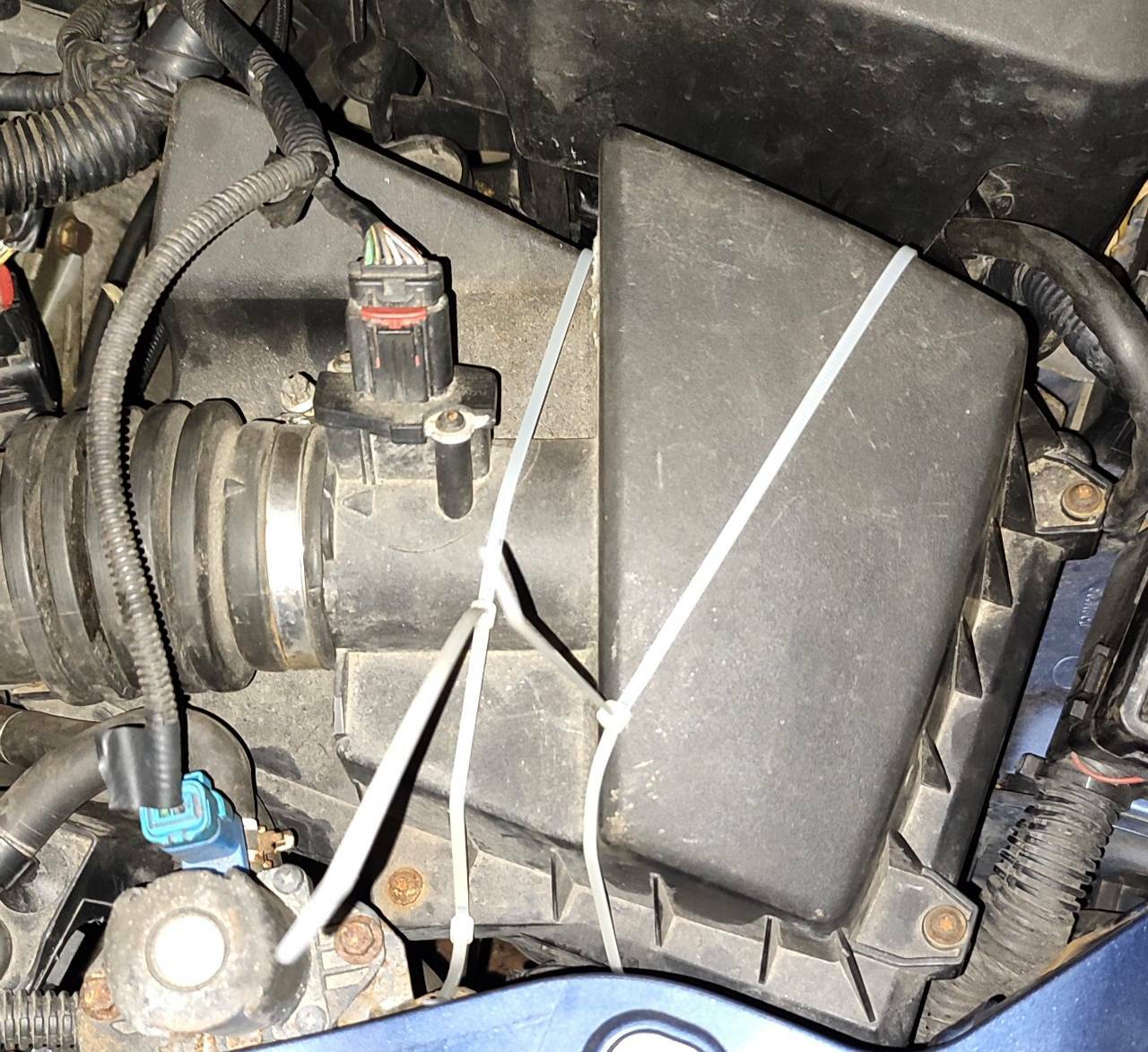

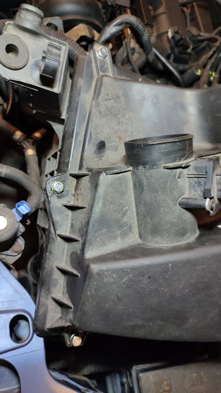

Had an interesting* "quarter-of-an-FTP" in the Focus earlier.
Thankfully it had the decency to do it about a quarter of a mile from home, on my way home.
I was just pootling along with minimal fuss, spotted a car in the distance that I'd need to give way to so held back to let it pass without having to slow down. Hyper miling innit :)
Anyway, once it passed, I booted it in 3rd gear at ~25mph which naturally provides a bit of engine load but it's perfectly capable of accelerating from that speed without dropping to 2nd.
There was this almighty *BANG* from what seemed like the front driver's side... I pulled over immediately and then set off, there was this weird "HUMMMMMMM" noise pulling away, almost like when a brake gets seized on or, less commonly, when a clutch's friction material separates from the disc without actually catastrophically failing... Weird. It seemed to drive fine.
I turned around and headed back down the road to see if there was any debris I may have hit without realising, there was none. The "BANG" sounded maybe like a tyre blowing out or a broken spring, or both, just not *quite* as loud. I pulled over again to check the front springs incase they had snapped at risk of penetrating the tyre, and no, they seemed intact.
I was pretty concerned at this point but since home was only 2 minutes or so away I figured I'd just carefully carry on and see how it behaves
It quickly became apparent that this *HUMMMMM* noise is actually intake noise... So an intake pipe or something has blown off. Weird, because this is a naturally aspirated engine!? The manifold is under vacuum!?
Got home, opened the bonnet and soon discovered that the air box has burst open, clearly with such force that it smacked the bonnet! The self tapping screws appear to no longer have anything to bite into as the plastic in the air box seems stripped out
I'm not even going to begin to try and work out the physics behind this.. I can only assume at moderate throttle, with the restriction of the air filter, there was enough of a vacuum that when the screws let go and somehow allowed the lid to rise up, the rush of air created the noise and a pressure which blew the top off!?
I've never come across this sort of failure, to see an air box quite literally explode!
Fixed*
Grump: air boxes seem really expensive. Like £50 expensive for a second hand one! I'm struggling to justify that since they pretty much almost always end up getting crushed with the car in the breaker's....
I've had reasonable* success by stuffing a Rawl plug into the stripped out plastic threads then re-tightening the screws.
HTH.

Fixed*
Bigger screws ?

Fixed*
I did a Laugh for the actual issue, rather than the expensive fix. Brand new air filter, tiger seal, more cable ties and forget it for 2 years?
HTH.
2 hours ago, camryv6 said:
Bigger screws ?
I like those ideas. Will give it a whirl, or anything that works!
I've used them on the undertray of my Mondeo,hasn't fallen off yet.

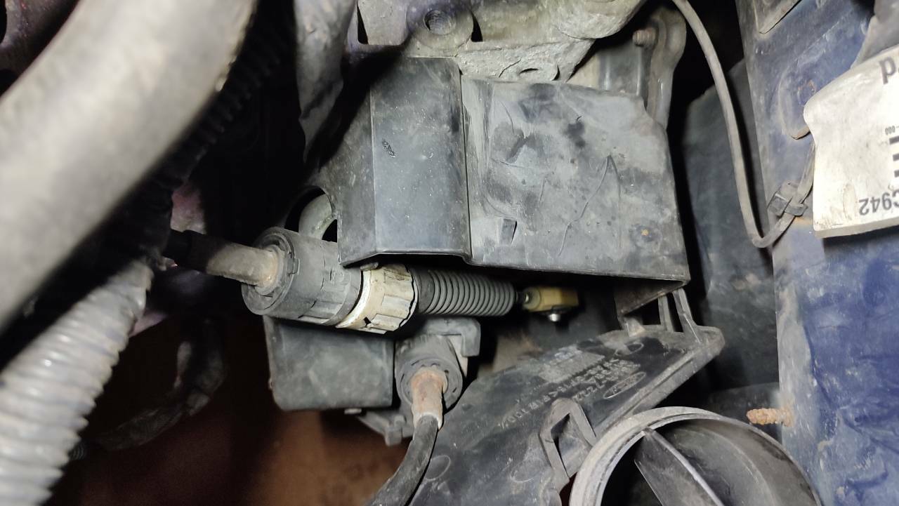

Fixed it! 😅
Like Beko says, the air filter is clean (new, obviously, after the hydrolock....) so I shouldn't have to disturb it for ages :)

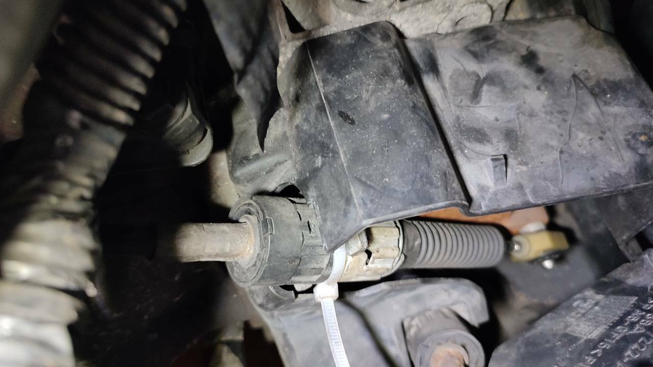

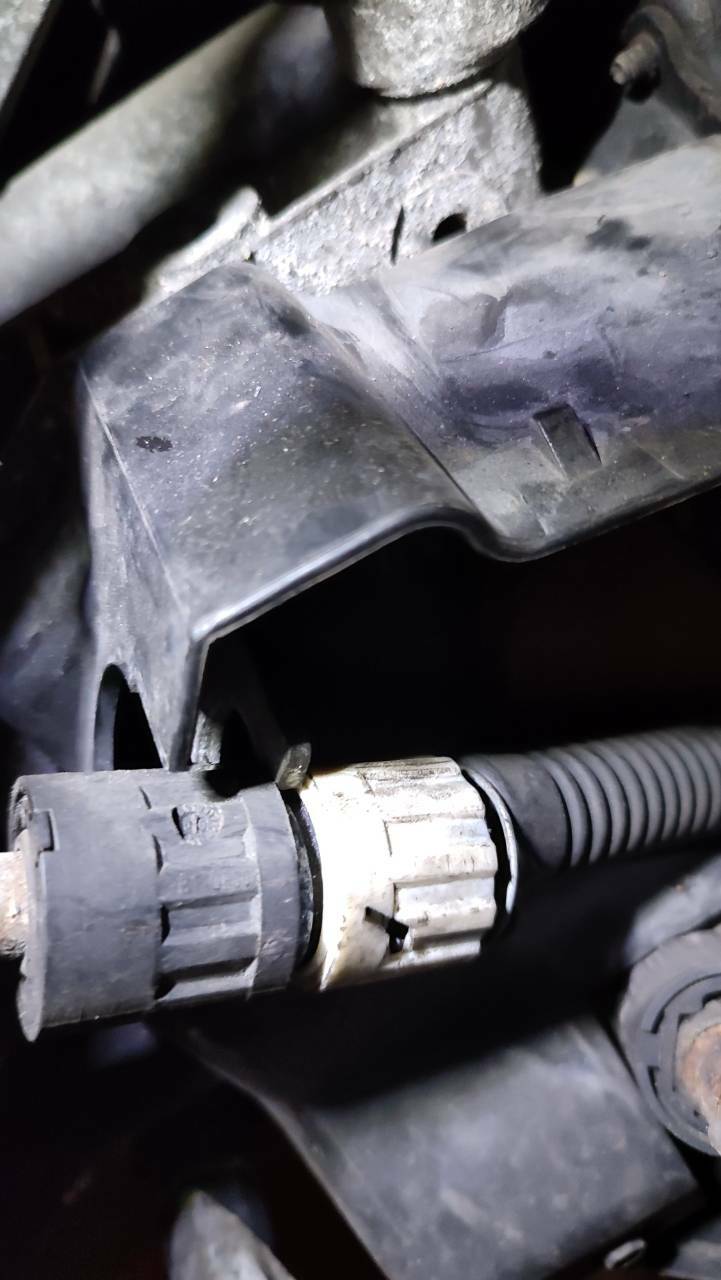

Also; a grin as follows -
Those of you who follow my thread for this car may remember my concern surrounding the slightly notchy gearchanges. Well, while the air box was out look what I spotted!
The collar mechanism that holds the gear cable into the bracket has broken, so it was sitting slightly adrift...
^ Fixed! 😂😂
Sod paying £100 or whatever for a new set of gear cables.. haven't been able to test drive yet due to the aborted ball joint replacement (a further £77 spaffed up the wall thanks to needing a complete bottom arm 🙄
But having saved £50 or so on the air box, man maths tells me I'm only £27 worse off now having to do the arm, but the ball joint alone was £12 which I'll get back so it's basically £15 extra.... 😂😂
But I'm definitely not spending £100 on new gear cables when a cable tie seems to be doing the job.. for now
