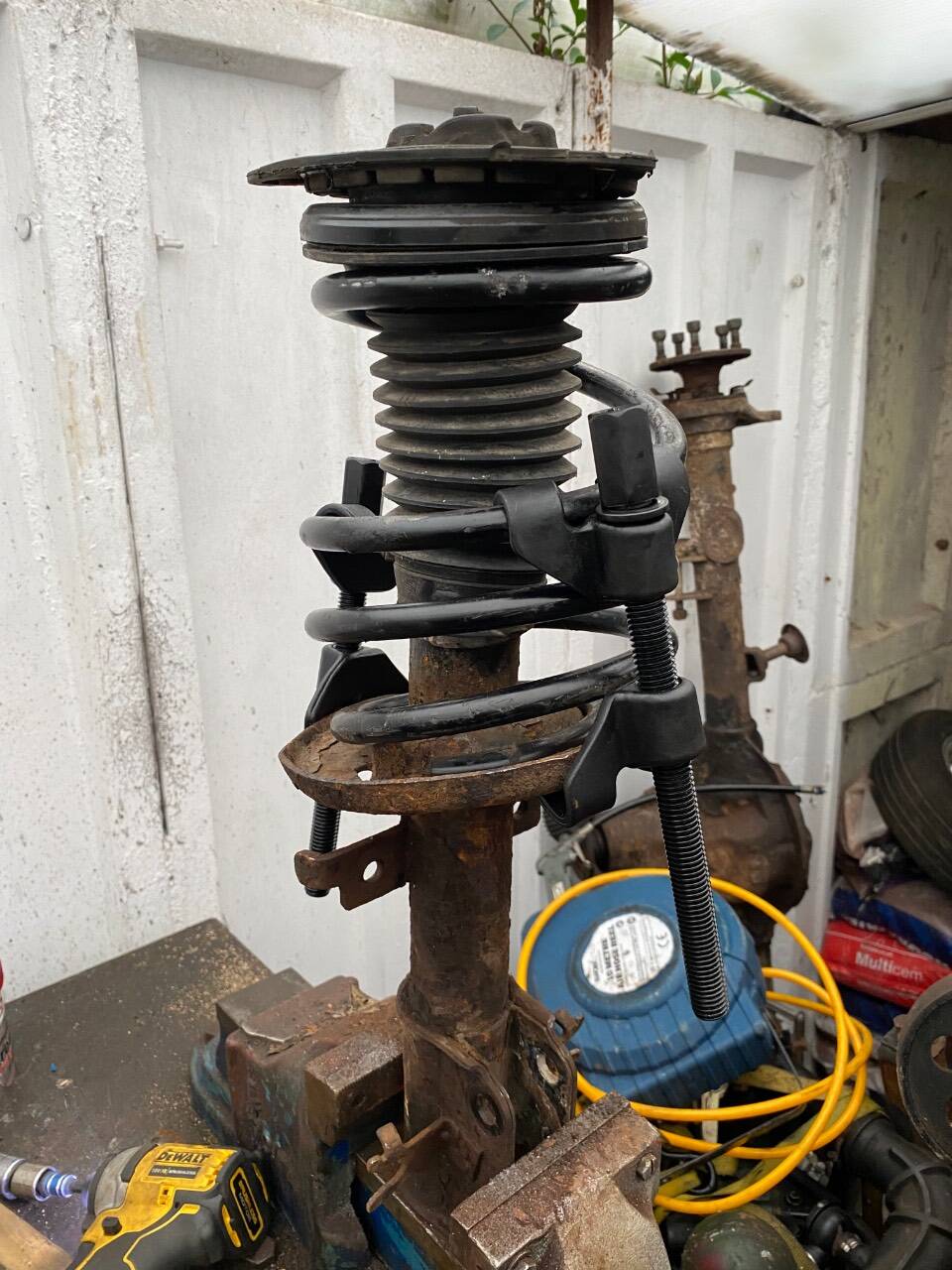

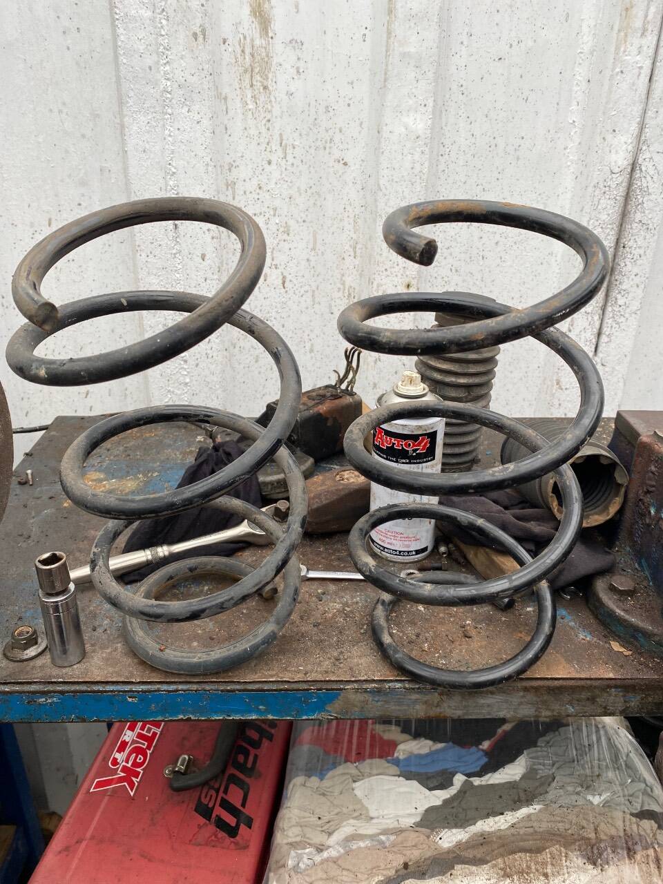

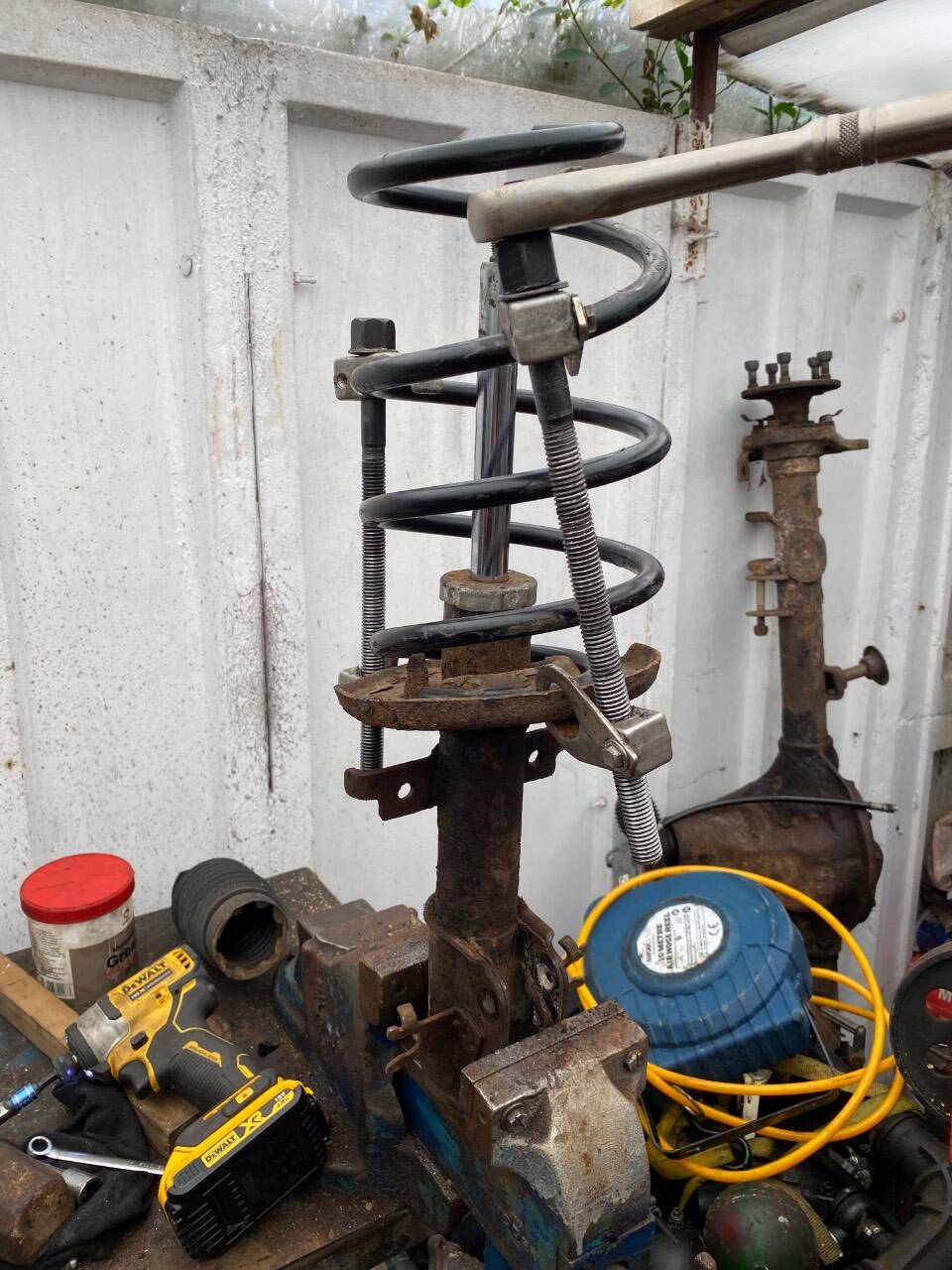

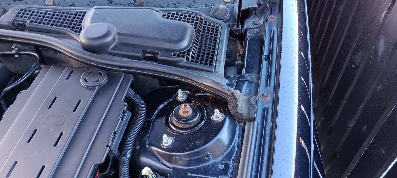

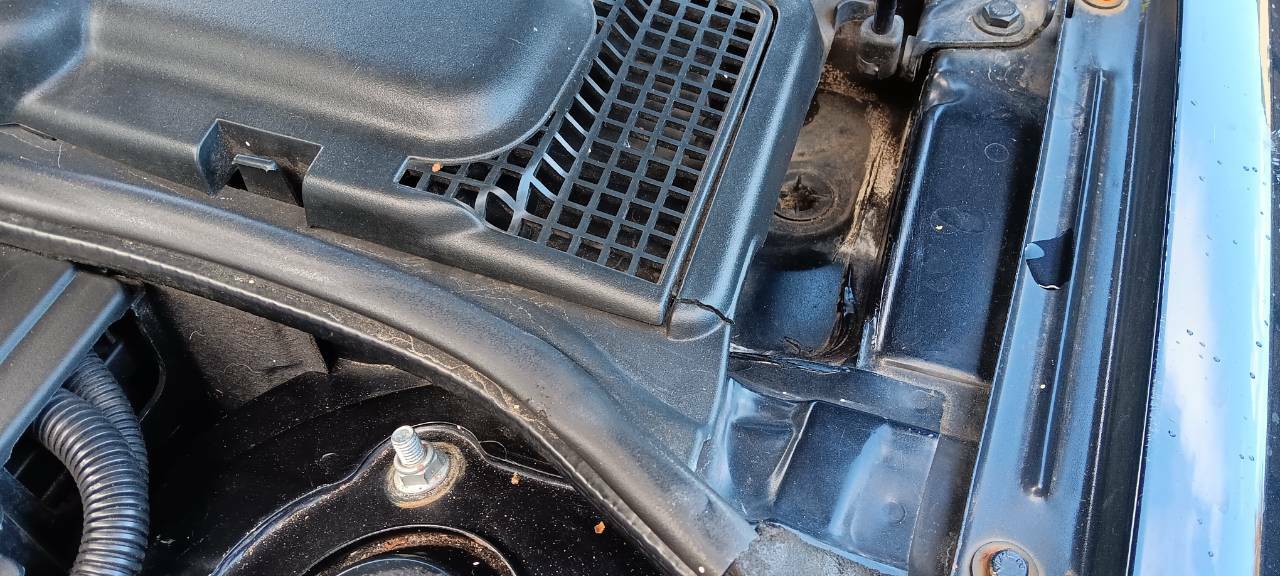

I finally got around to checking the front springs on the Laguna to see if they were behind the issue with pulling on acceleration/deceleration. I bought this Laguna from Wuvvum and during his ownership he replaced the entire drivers side strut with a used example from a breakers as the top mount failed. I found that the passenger side spring had a blue and white paint dots and the drivers side had white and blue. Different spring rates then? The Laguna came with the old strut in the boot which had ended up in the garage. I had an idea of swapping the top mounts around and refitting the original strut so I had a matching pair but on dismantling it I discovered that the top mounting nut had worked loose and had worn the top of the shock absorber away rendering the strut scrap. No problem, just swap the springs around.
I dug my  dangerous old spring compressors out and got to work. I eat danger for breakfast and negligence for tea and soon both springs were removed, however the  £10 eBay specials bought in approx 2005 completely died a death when I tried to refit the spring, seizing up and stripping the thread. Fecking hell! Fortunately Mrs LT was out and about was able to get me a pair of Laser spring compressors from Euro Car Parts. These worked a treat and the spring was soon refitted and the strut then reinstalled to the Laguna.
On an initial test drive the problem seems to have gone but I’ll need to go on a longer test drive to confirm. It certainly feels much nicer to drive and much less like a shopping trolley. Pretty pleased overall!

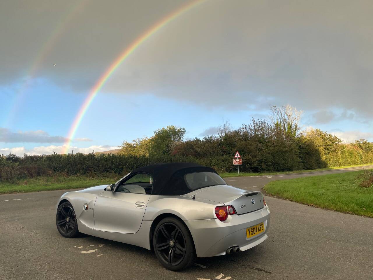

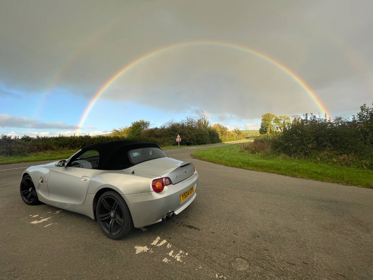

Took the latest jalopy out for a drive on damp and undulating moorland roads…
Love it! Although new front dampers and better rear tyres are required (or maybe a lighter right foot/ better weather)
Impressive double rainbow ( unless cheating with a lens?)
no just grabbed a hurried pic just then (i didnt notice the other rainbow)
Its in the other pic too….

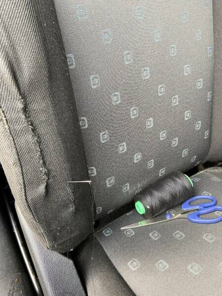

First up, the drivers seat fabric was torn on the bolster with a smaller hole next to it for good measure.
A quick needle and thread session later and it’s better. I’m not a seamstress but that’s not a bad job I think.

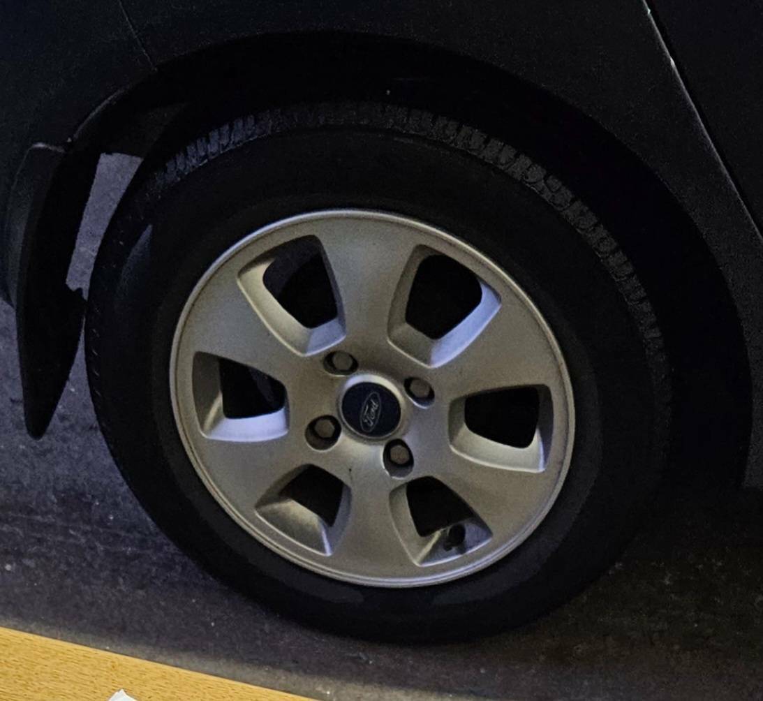

I’m after a set of these hubcaps if anyone’s got a set going spare?
Has to be these ones as they are TEH SEX. Ford really know how to make a good set of trims. Not just of this era of Fiesta, take a look at the Escorts, Mondeos with the GLX swirly trims. Fucking peachy.

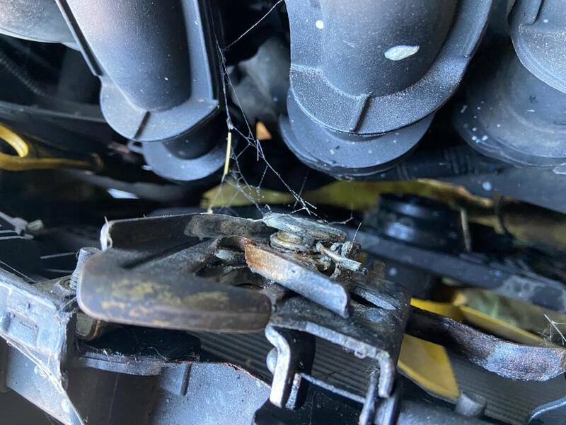

Bonnet up and let’s have a look at that catch.
It will release, but very very slightly. It doesn’t seem to feel as free as it should.
Verdict: FUKD. Get a new one, greengartside.
