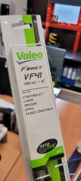

We ordered new wiper blades for a nissan cashcow for eurocrapparts .. well they gave us old style blades to go on to replace the modern flat type... but look at the names on them... like a blast from the past

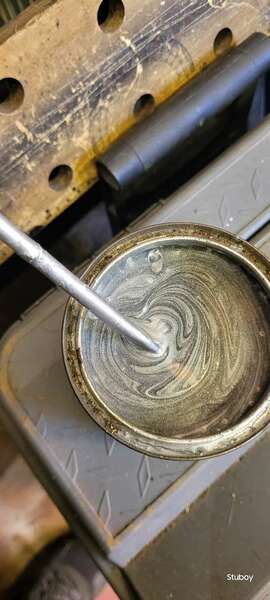

As stated in tool thread I've been tidying up the shed, any idea of the paint looks like on a car? And found this airfilter... shall I go jdm on the mighty v6... he he he
