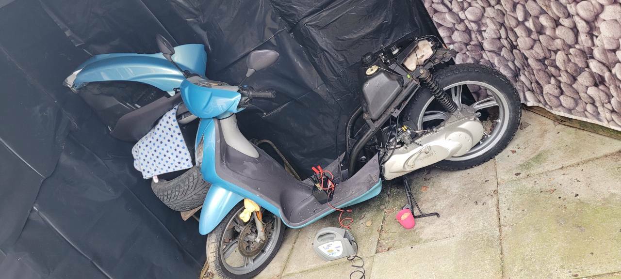

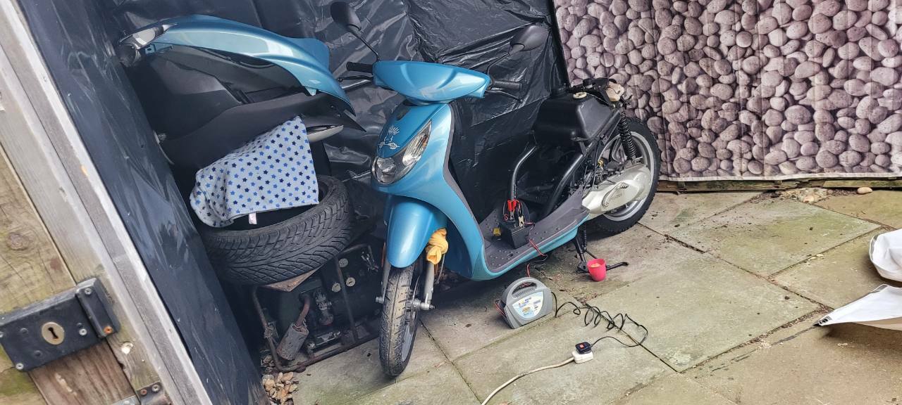

School run done....
Been to lidl for lunch..
Finally the loooooooxoooor is outside and chained to the Villiers generator..
Battery on charge.. aldi special wouldn't do anything..
