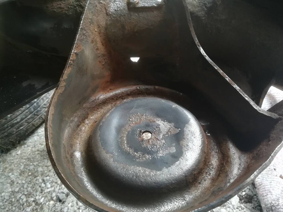

I finally got round to dropping my rear axle today, a job I've been meaning to do for a few months now but, well, it's been a long old winter?
I had three jobs I wanted to do down there:
  •     Properly clean and rust-treat the spring pans
  •     Check rear brakes (1 was an MOT advisory for slight binding)
  •     Continue messing about with shim washers to try and correct rear mis-alignment
I was amazed how easy it was to drop the axle and remove the springs? Two bolts, the axle drops down and the springs fall out! Winner!
Thanks due to the most excellent folk of the FIATForum for the detailed guide and advice on using a breaker bar then a drill to run out the lower shocker bolts. The thread is quite long on them.
I soaked them in penetrating fluid a couple of days prior and they both ran out really easily.
I used a range of wire brush attachments on an angle grinder and drill.
And here are my spring pans after wire brushing. Not too bad for 16 years I reckon.
289779776_rearaxle01.thumb.jpg.7e3ee1bc38597b52ce22a52182e39793.jpg227904677_rearaxle04.thumb.jpg.233272b698db72ec8456826e5cd958ca.jpg
I had previously treated them 'in-situ' about a year ago by washing then dousing in GT85, old engine oil then finally thinned chainsaw oil. The main trouble area on mine was the metal to metal spring/pan interface. I also uncovered some 'new' drain holes whilst cleaning, so this is a job well worth doing?
I used Fertan to treat the rust. I've had a 1litre bottle for a few years now and it seems to give good results - I haven't had rust come back through after painting over.
Only issue is it recommends 48hours before washing off then painting. It also claims 12months protection without painting, so I've put everything back together unpainted for now.
The Fertan turns all rusty metal black which shows up on the spring pans and brake drums in the rest of the pictures.

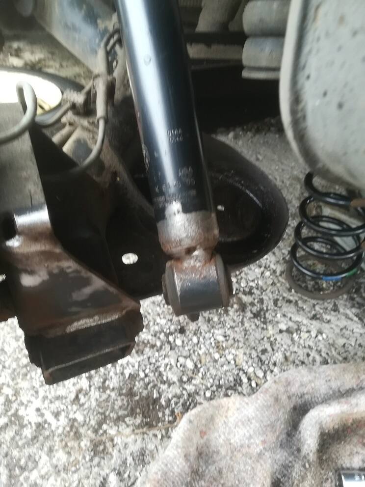

After treating the pans I set about attacking rust on the springs, shock absorbers and brake drums.
2023176517_rearaxle06.thumb.jpg.e1bedf460160c5627cdc09e159d25506.jpg421530203_rearaxle07.thumb.jpg.47a1470824285109b06321a34d1a6523.jpg
I was hoping it was just the rust on the drums causing the binding - the culprit was hard to rotate by hand, sticking on every rotation.
Both drums were a pig to get off due to the lip of rust formed on the inside of the drum. It took a lot of 'ittin'wi't'hammer and prizing to get them off.
I was worried about cracking a drum or damaging the shoe linings - they were a little bit scored by dragging the rusty drum over them, but luckily still attached and a fair bit of meat on them.
No leaks under the wheel cylinder boots, so I just wire-brushed all rusty areas on the drums with the angle grinder, brushed Fertan on and reassembled.
Binding seems to have gone, so fingers crossed...
Rear brake parts are cheap enough, but shoes and cylinders look a right faff to replace.
I still struggle to fathom how the manufacture and especially assembly of drum brakes is cheaper than discs on new cars...

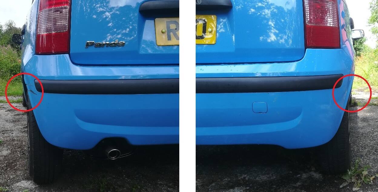

So, on to the rear alignment... I've been messing about trying to correct excessive wear on the left rear tyre outside edge.
This I suspect was caused by too much toe-in on the left rear. 'Feathering' on the outer tread of the tyre typical of too much toe-in can be seen:
485141938_nsrtoe01.thumb.jpg.05642904d8d0c429a5bdda53b69d7385.jpg394295586_nsrtoe02.thumb.jpg.0e6bc28058cdbec560e2a2e2e5397220.jpg
There was evidence in the file that it had been doing this on the same corner for some time before I got the car, so it wasn't just this tyre at fault.
There were tyre condition reports all showing the same wear pattern and a few bills for one new tyre at MOT time... I wonder if this had anything to do with them getting rid of my car...?
My car's steering was also pulling slightly to the left, but it seems most 169 Pandas do this anyway.
The Panda has a simple twist-beam rear axle with no provision for adjusting toe or camber. There's a suspicion on the FIATForum that these pre-2012 non-ARB axles weren't manufactured or installed very accurately, and that a properly-aligned Panda is a rare sight in the wild.
I'd previously added some 1mm washers to the front two bolts on the left rear hub to bring the front of that wheel outboard a little, and ended up with this:
140795089_tracking02.thumb.jpg.81f83655724547b64f01ae6c4a5d1bc2.jpg1605246777_tracking04.jpg.aeae0bd91f0b78741de85816780750a2.jpg
So I'd obviously pushed the left rear too far into toe-out territory.
Four wheel alignment also revealed too much toe-in on the right rear. The 169 Panda is (according to this read-out) supposed to have +1.5mm toe-in each side, so overall +3.0mm and of course zero thrust angle. I wonder if any of them do?
In the 7 months since, the tyre hasn't obviously been wearing out in the same fashion as before.
The pull to the left has also completely gone.
In fact, if left to run straight, she will now very gradually veer off to the right!
Which clearly isn't how it's supposed to be, so I thought I'd try and bring both sides closer to where they should be. I need to adjust the left rear by 2.7mm and the right rear by 1.6mm.
I sourced some shim washers, removed 0.3mm from the left rear hub and added 0.1mm to the right.
Now my rear axle is sporting 0.7mm shims (1x0.5mm, 2x0.1mm) on the left, 0.1mm on the right.
Another FIATForum member has advised they used 1mm gasket material to make shims on theirs which squashes down when tightened.  I think they mean the gasket squashes, not the Panda, but who knows?
I'm going to continue to monitor tyre wear and see how she feels on fast straight roads for a while now, then I may get alignment checked again.
As others have pointed out, laser wheel alignment isn't necessarily that accurate.
And anyway, I'm only looking to get rear alignment in the right sort of area so that she runs true and stops scrubbing off tyres.
It's a strange feeling knowing that a car of mine isn't merrily rusting away somewhere. Rather a good feeling too?
Now just waiting for some warmer weather to paint all the previously rusty bits?

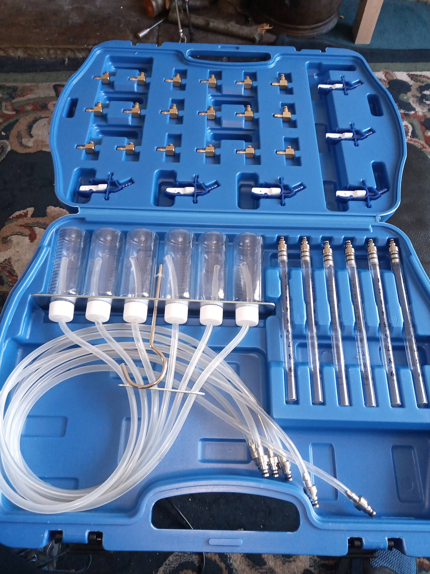

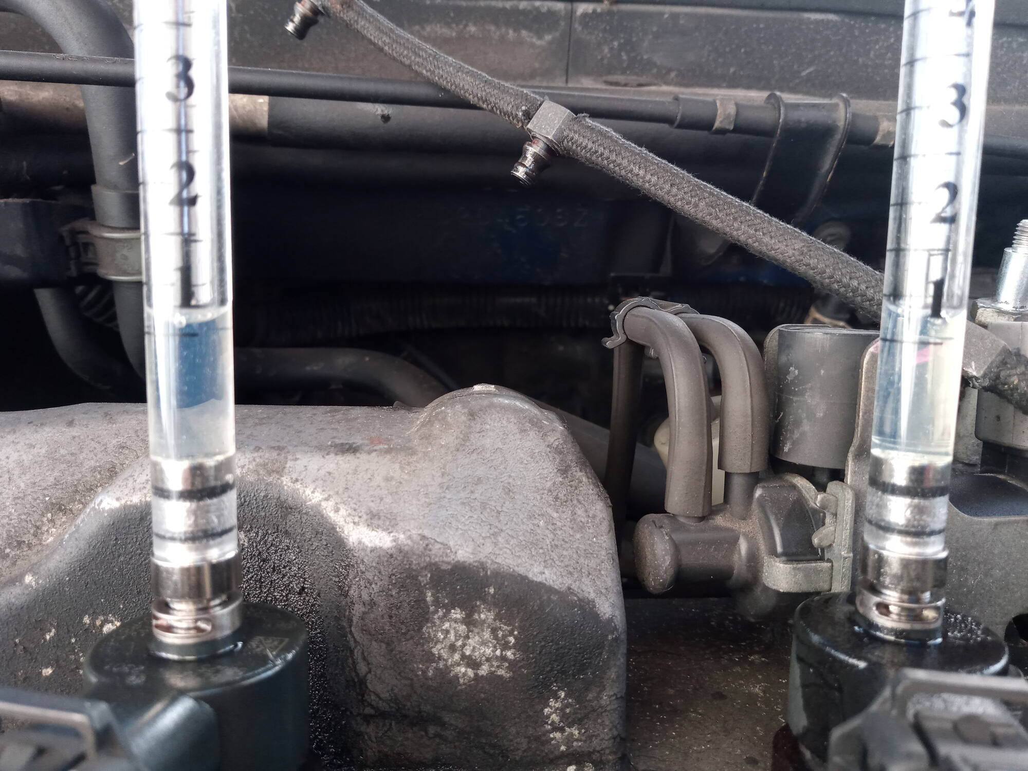

My eldest son has a 2006 Honda Accord diesel, bought about 4 years ago and largely blameless if dull. Since last summer it's been getting harder to start first thing, it was a bit odd because parked warm for 4 hours no problem, re-start seconds after a brief 1st run of the day it needed the same cranking as it had the first time. Engine temperature seemed to be key, not fuel priming etc.
With no fault codes we started with easy basics, genuine £45 fuel filter, tested heater plugs and supply etc, looked good but what else could it be ? Wasted £80 on Bosch heater plugs, no change. I then borrowed a newer scanner than mine which read fuel fail pressure, you could read the pressure rise as it fired.. Ah.
I bought a nasty Chinese injector leak off tester kit, it measures the amount of fuel passing through the injectors returning to tank so can point to problems
I used the straight tubes on the right of the box, they go straight into the top of the Bosch injectors looking like this,
These 2 show just over 1 Chinese whatever units after about 3 secs running
As does the the one on the right in this pair but one one left is over 10. A problem found! Hope it's the main one.
Injectors are from £30 Ebay lottery but probably need coding, £100 for the old one one refurbed at a respected local specialist or approx £200 exchange ECP or Motor Factors, also need coding. I went for ours refurbed.
The injector came out pretty easy other than the clamp bolt, it was proper tight and is supposed to be a one shot yield bolt doesn't look like one to me or the refurbishers so as Honda are shut it lived to fight again...... Torque is 5n/m + 90 degrees, a little puckering going on at 90 degrees. I spent some time making sure the seat was clean , i think some problems with injector sealing may come from this not being easy.
The result? This morning it started in 1-2 secs instead of the 8 secs and sometimes a lot longer it has done. I would like to swap back for my Merc but that is now 60 miles away so I guess I'm a Honda owner for the foreseeable!
410747975_IMG_20200324_1155461.thumb.jpg.6c2761ab285a8b39774d99073f849e90.jpg.
My assistant for cleaning injector seats with specialist tools,- plastic pipe, long screwdriver and cotton buds. With a smile he'll suck things I won't!
Once again my ultra cheap (about a tenner a few years ago) code reader proves its worth in gold. Read the codes on the Merc easy was precise (P301 - misfire cylinder 1, coil pack voltage... something something) and saved me faffing around or phoning the AA. I did consider the AA as I pay a fortune for the privelege of their company but... well, it's just not manly now is it? Especially when you can do it yourself, just laziness and a desire to get it back on the road asap without waiting for deliveries from unknown places.

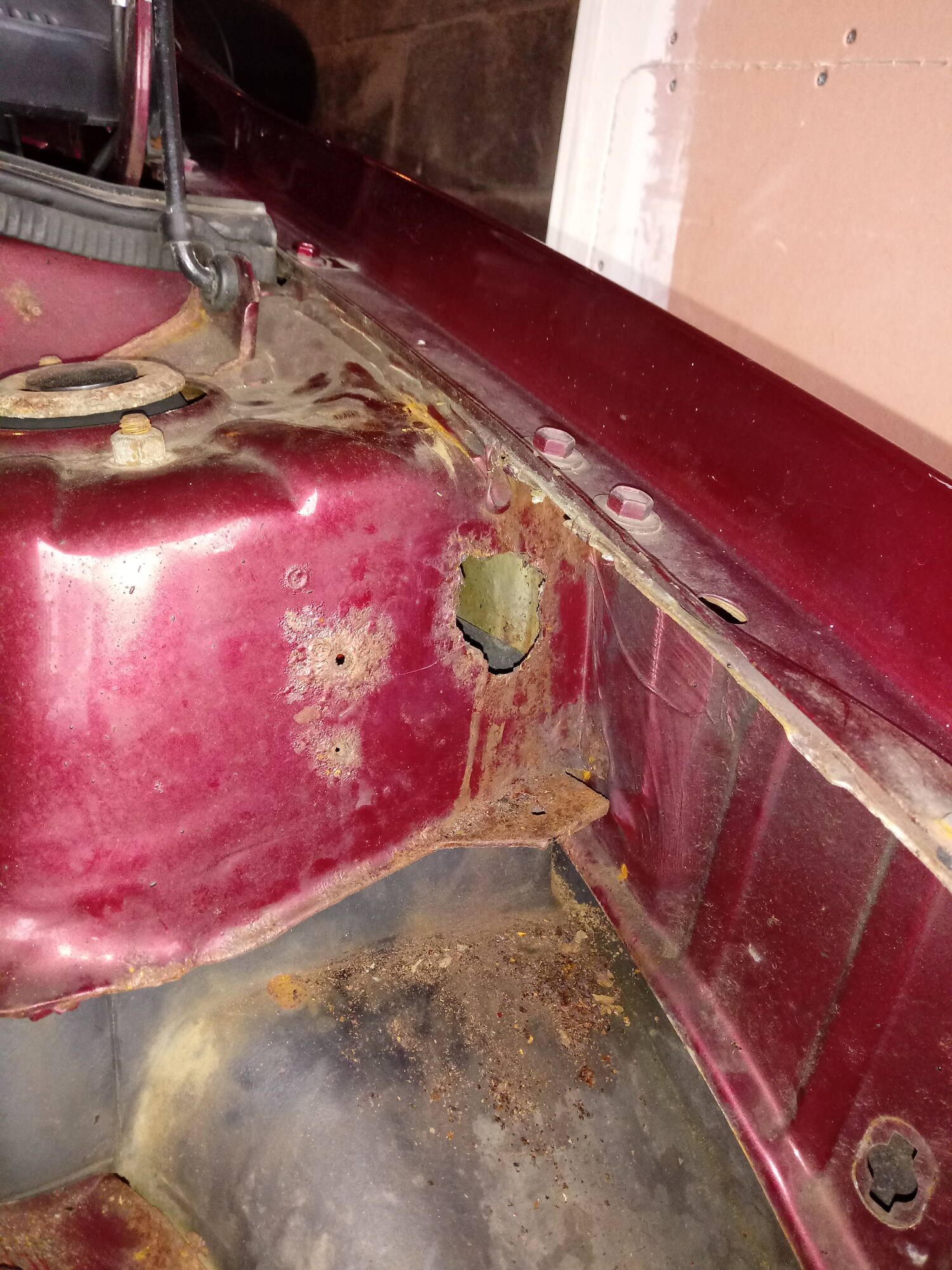

Despite its tiny boot, I've spent today doing some apocalypse* prep on the C2. I'll do a proper thread later, and there's more to come. Interesting times to be a delivery driver indeed.
This is just stage 1. But I don't believe in leaving something vital in an unready state. The clear tub still has some unnecessary shite in it taking up valuable space. Space certainly is a problem in such a small car, but I'll get onto that in the thread. Lunchtime now!
That'll explain the exhaust noise on my Viva!
Replaced with a slightly*less rusty one from my stash of parts,and it sounds much improved.
Well that escalated. Its been bubbling here for years, might as well get it out in the open.
The other side is going the same way.
4 hours ago, RobT said:
@spike60 Thanks for that run down.  I'm wondering if my 406 problems are due to a leaky injector, so will get one of those leak off tests in due course.
Is the 406 common rail?  The Honda is so one injector returning too much fuel was bringing the whole system pressure down hence the delay in starting while pressure builds. If it's non common rail I would expect the  cylinder to miss but the others to be unaffected, assuming one weak injector.  If not common rail you may still be able to get useful information with it though, it's the first time I've used a leak off kit  for diagnosis.  I paid £21.99 for the kit from a UK seller last week, they were £18.99 from China but I wanted prompt delivery.
