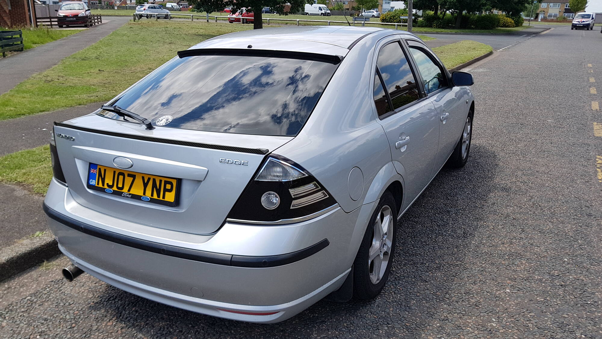

29 minutes ago, wuvvum said:
Sort of pez station shot.
That's looks newish and respectable, slightly different to your usual purchases …. lmk when you want shot ;)
