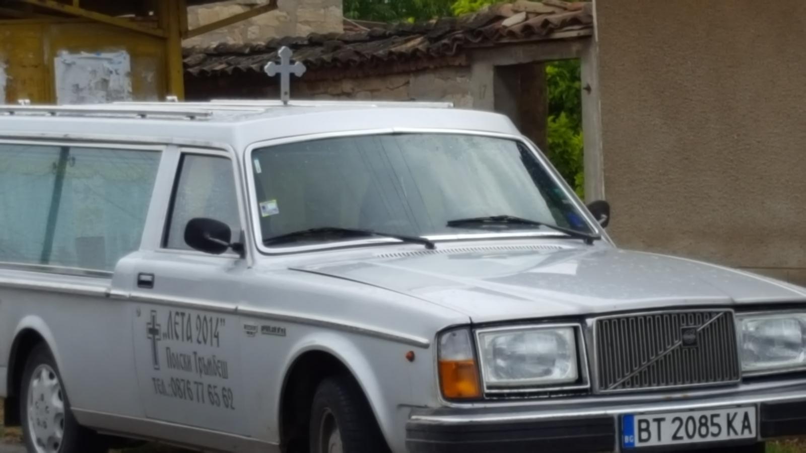

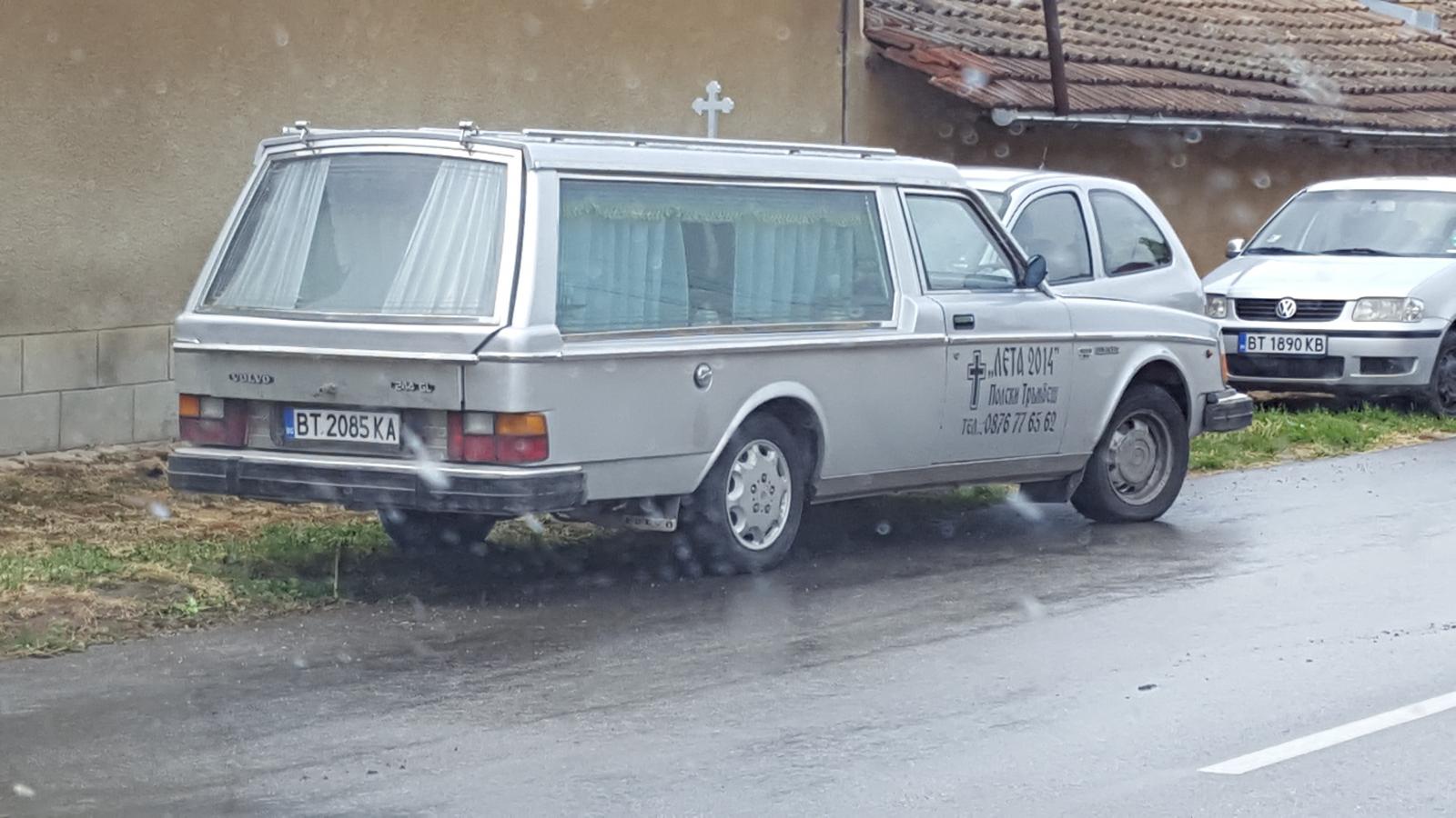

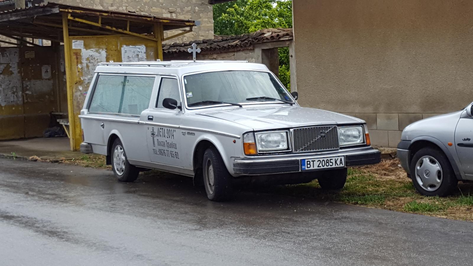

Just popped out to collect some post and spotted this
There's a fair few Mercs fitted out as hearses but not seen a Volvo before
And an oldish 1 at that
Guest Hooli
Looks ideal for shitefest, it's even got curtains to make it a camper.

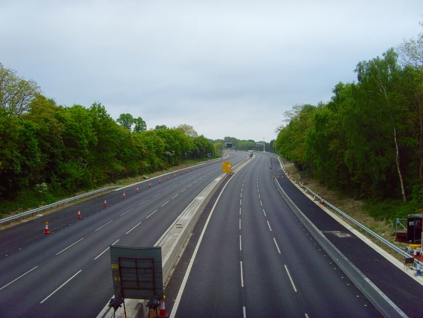

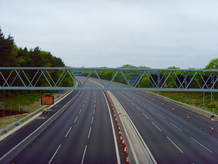

M3 closed all weekend so they can put in a new bridge ( that still won't be completed and open until next January!
I have just been out on the bike over a couple of bridlepath bridges.
It was like a scene from 28 weeks later!
A scene for 28 Days Later ^^ The OCD edit.
'28 Weeks Later: the potholed version'...

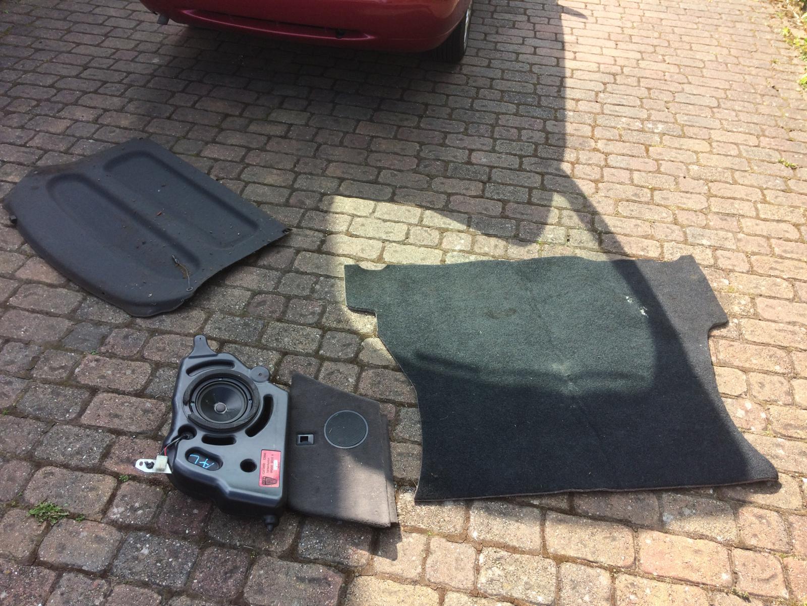

Gr3 scrap yard sesh this morning.  4 part(hardly) worn tyres (chinese death ring specials) fitted to the Mondeo whilst I got a new parcel shelf (free as very mucky) and the plastic rear trim piece it fits into as well as a new boot carpet - also scored a factory rear subwoofer from a very high spec and late model Rover 75 tourer. Gave a bloke a hand getting a centre seatbelt out too - as like me, he'd forgotten to bring some tools - helpfully, mine overlapped with his. All this and home by 10.30 - with receipts.  Things aren't what they used to be - they are better.
