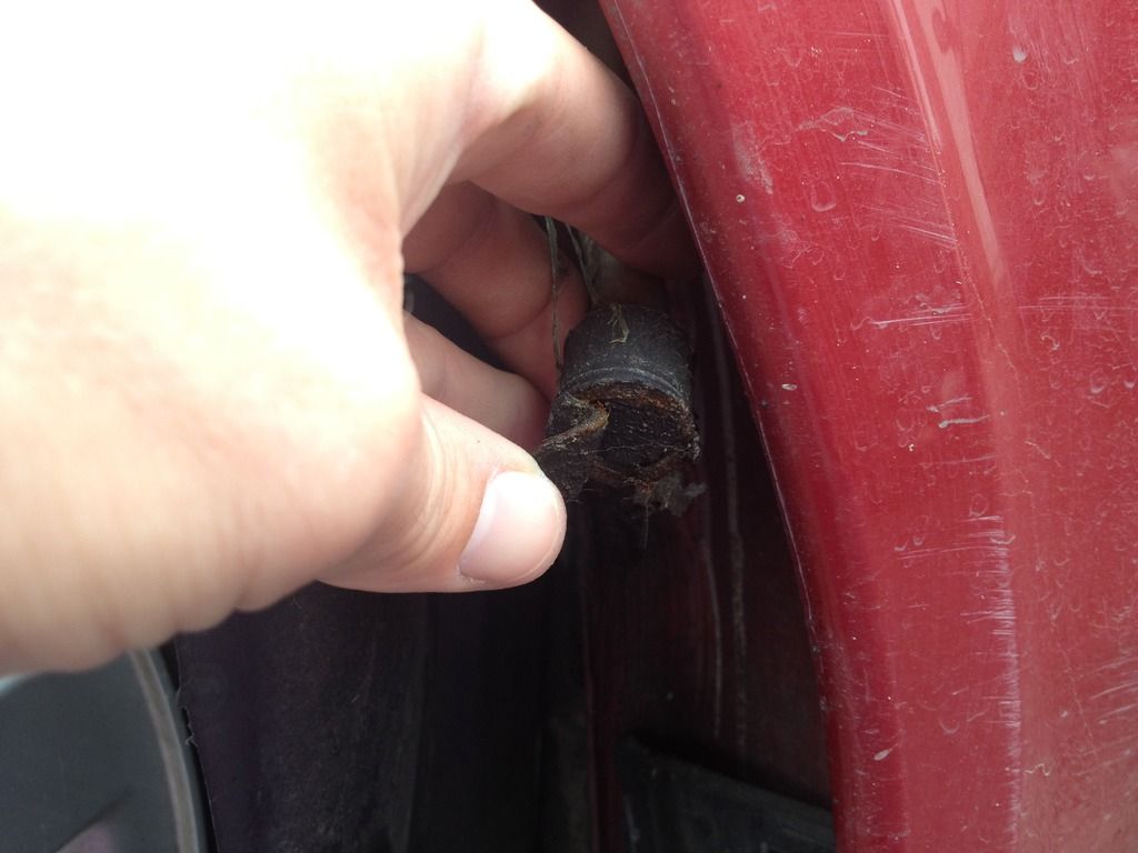

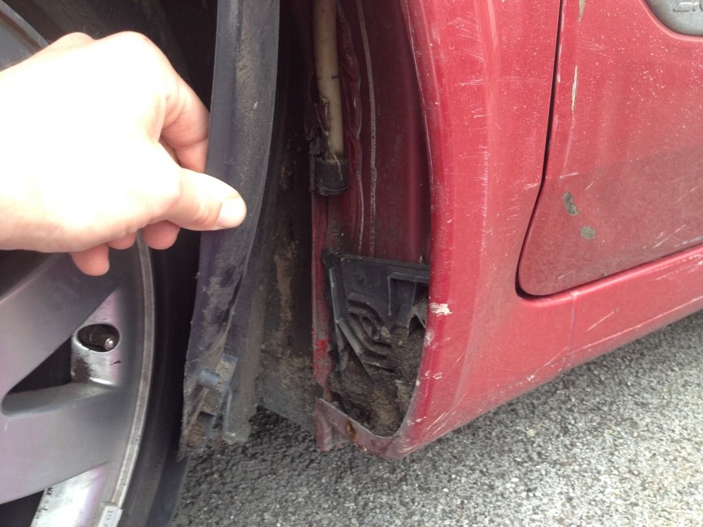

I tried rodding the drain tubes, but didn't have a long enough bit of wire to hand.  Luckily someone posted a link in someone else's Gooner thread to a video someone's put on Youtube that shows where the drains come out.  Inexplicably, behind the wheel arch liner.  The bloke in the video must only have worked on Series Land Rovers and Morris Minors previously because he didn't have a Torx bit to undo the screw at the very bottom of the liner.  (You can get a set for about £1.59 from Wilko's, ffs.)  He does have a great work-around for this though as long as you don't need any skin on the back of your hand for the next six weeks.
Fortunately, I have a basic set of modern tools so I had no problem getting the liner off.
E674CA37-9243-4CEA-969E-657FE23A0DE1_zps

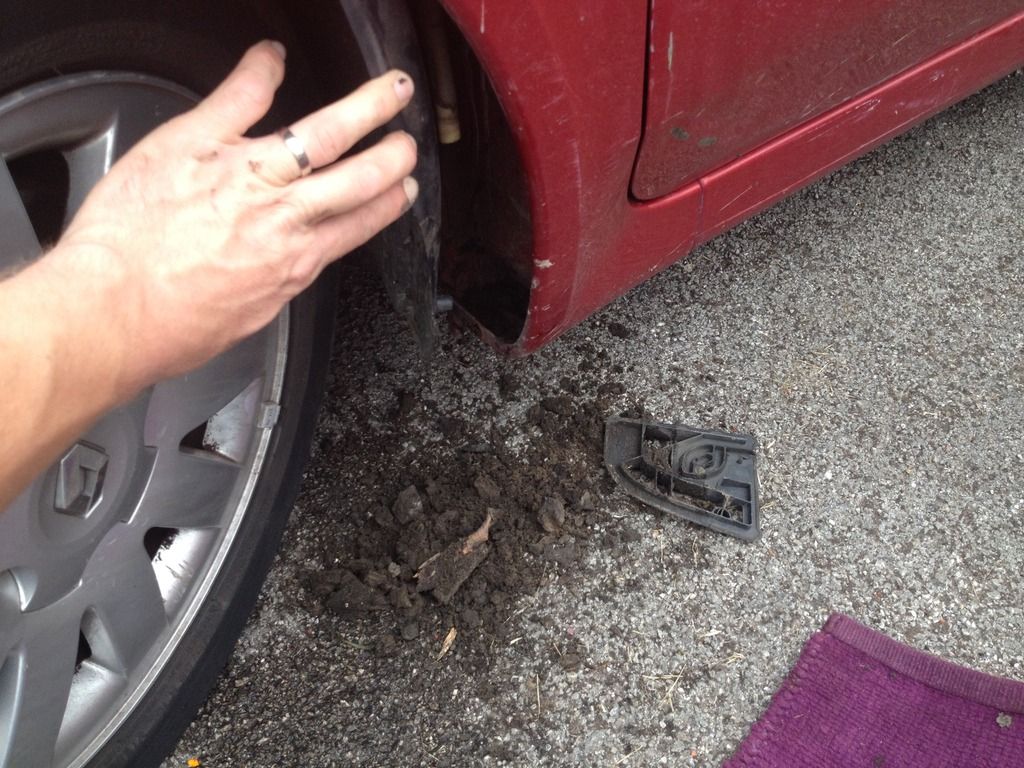

That's the end of the drain tube, right there in the middle.  Took out that little bit of plastic and a load of shite fell out.

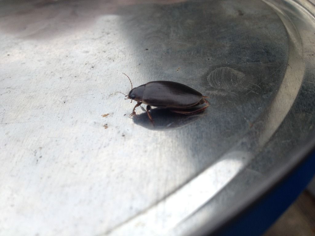

And this little fella!

That's the end of the drain tube there, with a little stopper of gunge in the end.

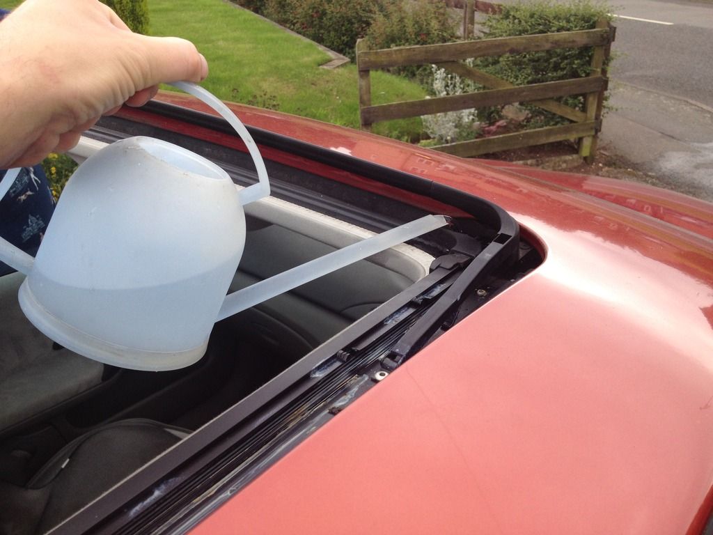

Cleaned it all out, did the other side, stuck 'em back together and a quick test...
3BE6A3B9-BBB7-40AE-A528-B097B372B803_zps
Result.  No more footwell swimming pools.
