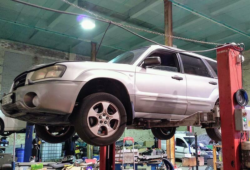

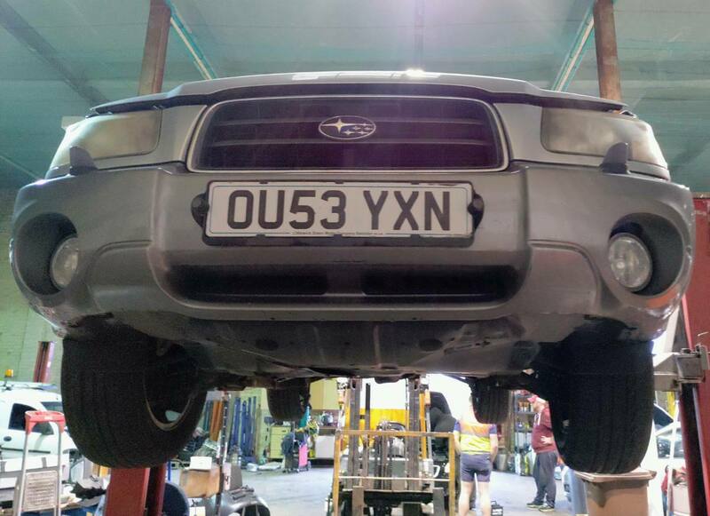

Well kids, the verdict's in: and sadly, it's well and truly phuq'd.
I received a call just before 4pm from the Mechanic of Choice, asking me if I could nip down for a wee chat.
I got a feeling he didn't just want my opinion on some new decor ideas for the customer waiting area.
On arrival, the Sub was hoicked up on high, with some unhelpful-looking fluids and a lot of rustflakes garnishing the floor beneath.
So what's the horror?

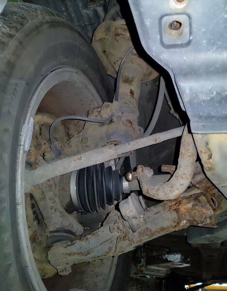

Well, obviously the front control arm shearing off I knew about...
...but in its unexpected collapse it managed to mangle the offside front driveshaft and CV joint...
 ...and smash the already-unhappy drop link.
The nearside arm, although not yet in a state of absolute collapse, isn't looking all that brilliant either.

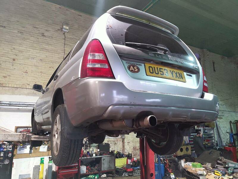

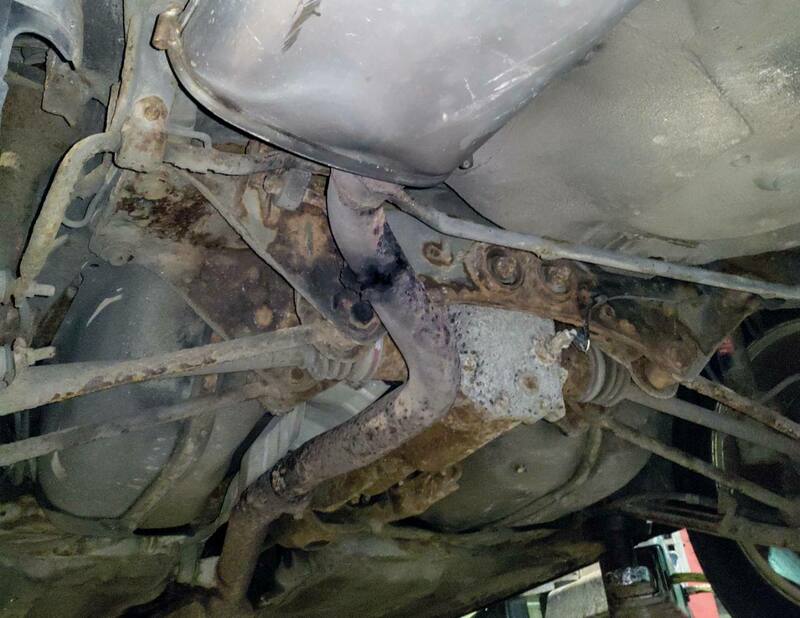

Turns out the rear subframe also isn't looking too clever, rust-wise, while the exhaust centre section is in a bit of a state with complete detachment from the cat.
Plus, one of the rear shocks is leaking.
None of this is good news, but the real kicker is that both rear arches are mega-corroded all the way round.
I'm surprised they're so very dreadful, as new discs were fitted last summer and there wasn't anything untoward noticed at the time - yet there's now gaps you could slide your hand through (assuming you wanted tetanus).
Yeah, there's no way the MOT man's going to be smiling kindly on this sort of grot.
Had there been no rust in the mix, then probably £500-600 would have got the arms, links, driveshaft and shocks replaced, and I'd have paid that as it's a pretty decent car and I like it - but dealing with rust of this magnitude isn't something the garage wants to be in on, and I don't blame 'em.
As it stands, it's immobile, which is a bit of a bollock.
