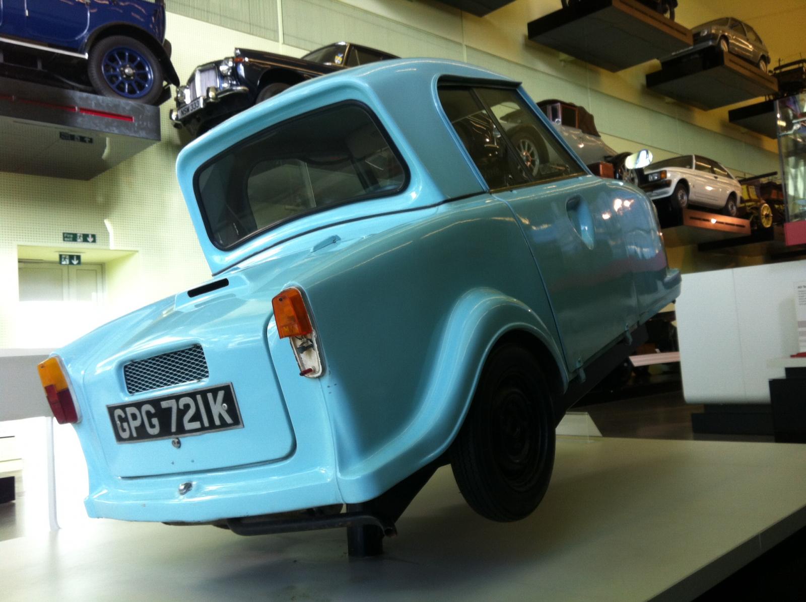

I happened to be in the Riverside Museum in Glasgow yesterday and snapped this little fellow
seems to be having rear light issues too
slightly more conventional controls
the wee man in the bobble hat is my nephew who had a great day out :)
